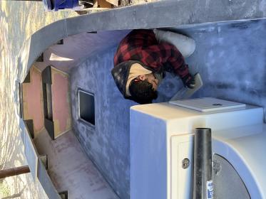

Cap supports

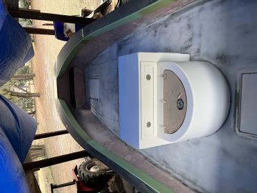

Lots of long boarding

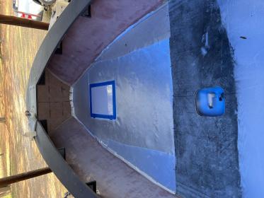

Building the coaming boards

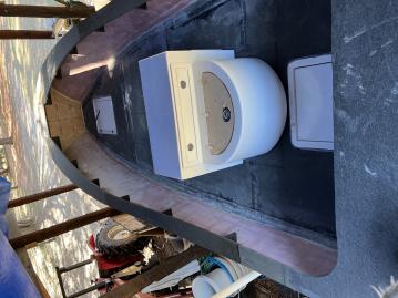

High build on the sole and gunnels. 3 layers of 12oz biaxial to glass the cap to the hull.
