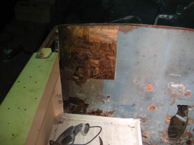

Looks to me like your doing a good job It's always ojt anyway.Everone has their own methods,and most usually work out well.
Like you,I did my transom(I/O) from the inside on my 74 Tsunami.I cut the rear of cap off from the hawse pipe to the stern to access the inner transom.
After I removed all the rotted core I applied a layer of mat and a layer of 1708 to the exposed skin to thicken the glass up a bit.
I two pices of 3/4 marine fir plywood glued together with epoxy for the transom core.
I bedded the new core on to the transom skin with hull&deck putty and clamped and bolted it all in.
It was an outdrive so i was able to place some bolts where the drive cutout was,and the other bolts were place above the waterline.I figured it was one less thing I'd have to fill later on.
After all was cured,I layed up a few layers of 1708 over the core and into the hull sides and bottom.I used Polyester resin.
I glassed the cap back on and faired everything back in.It was a lot of work from the inside,but I think it has less of a chance of affecting the integrity of the hull,as you don't cut any of the outer hull skin off.

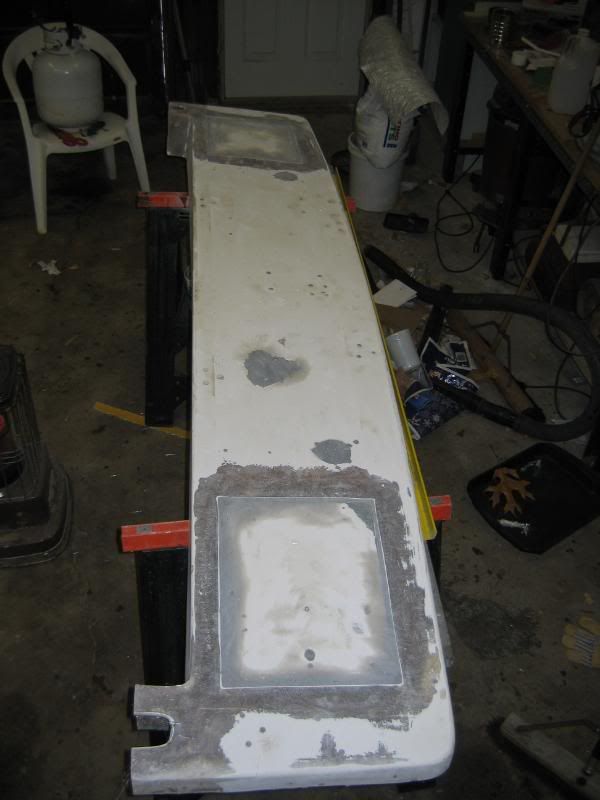

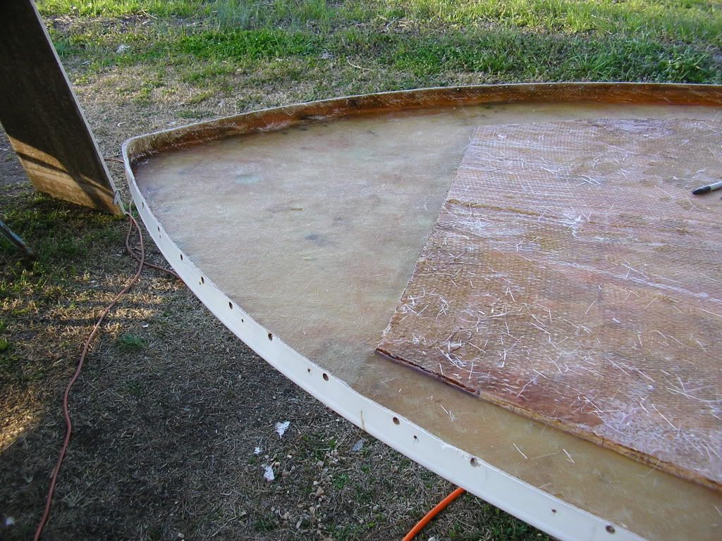

We got some old core removed from the cap today, and as we were looking at it we decided that the majority of the wood looked good and dry so we went down each side where the cleats, bow rail and the bow pulpit were mounted as these areas were rotten so we removed the core from around these areas. Unfortunately we punched thru in a few spots, so we sanded the areas smooth and layed up 1 layer of 1708 and then another layer of 1.5oz mat to beef it back up again. I believe that we are going to order a sheet of Coosa and recore with it. Does anyone know if they make it in 3/8" thickness?

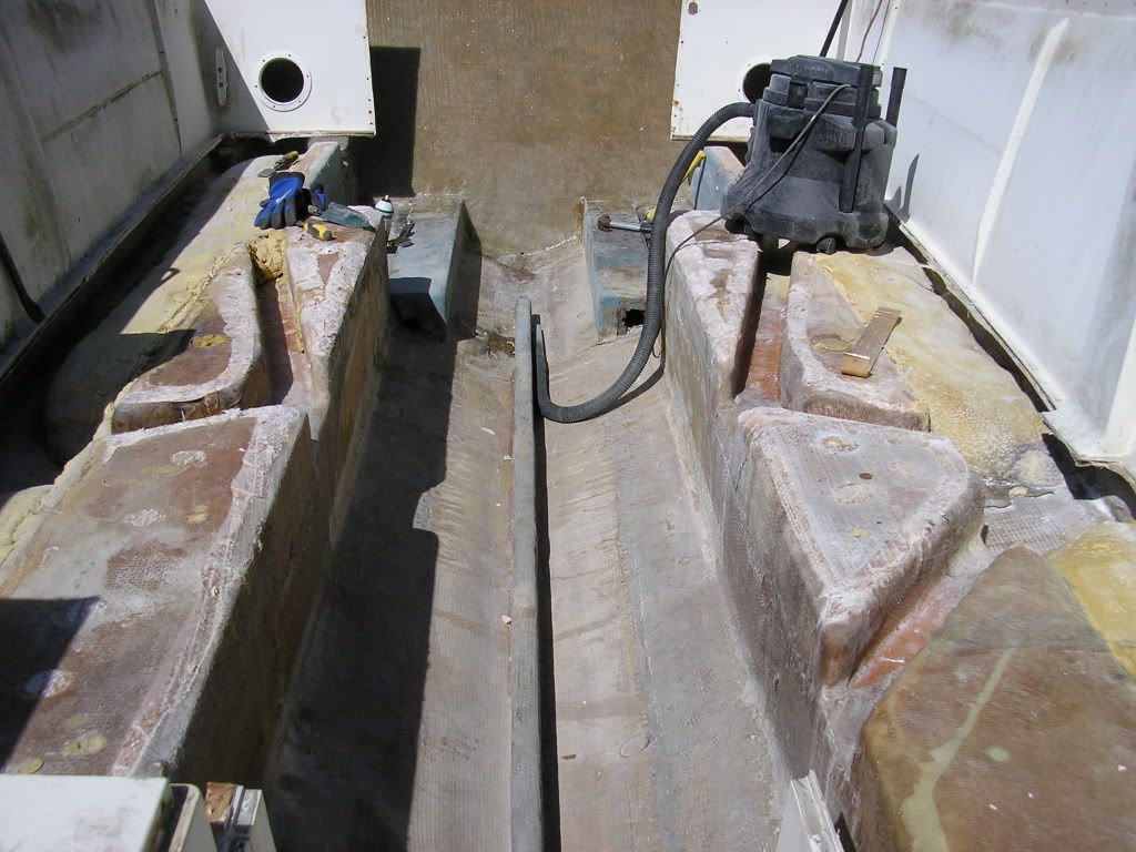

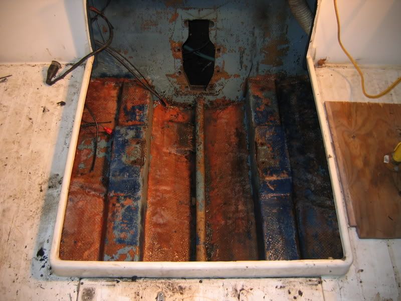

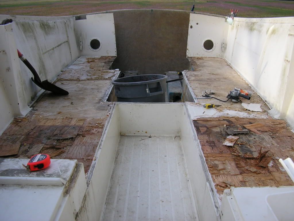

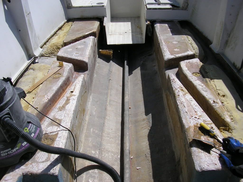

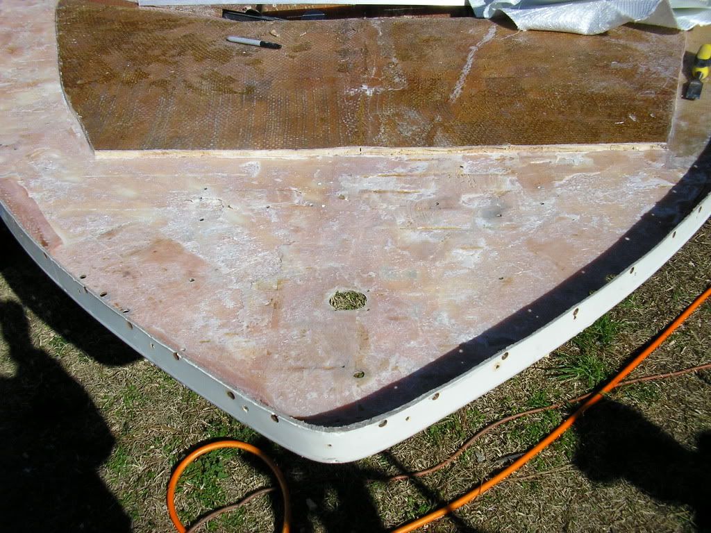

Well we've moved on to the deck/ sole of the boat this week. We've been able to remove the floor and about 500 lbs of "Potter Putty"!! Since these pics were taken I've ground down the stringers some to remove the remaining globs of putty. I believe we're gonna lay another layer or two of mat down on top of the stringers (for piece of mind) mainly and where I got kinda deep with the grinder also.
