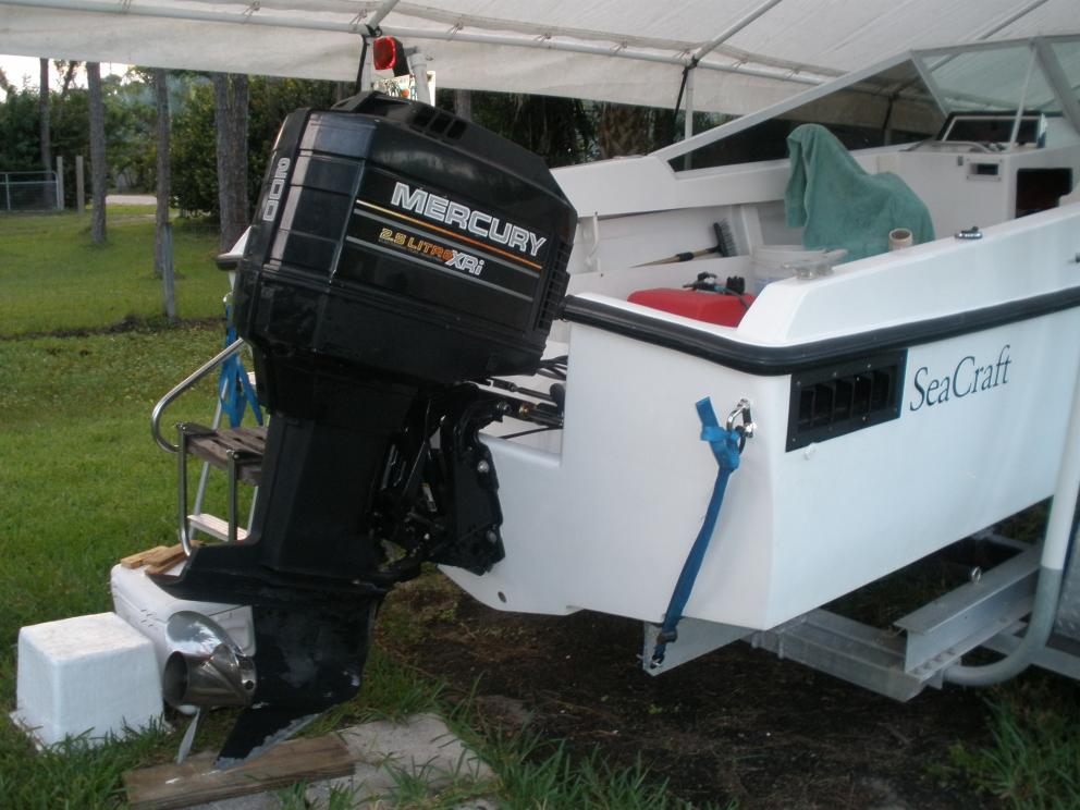

Old 06-16-2014, 08:19 PM
kiwi kiwi is offline
Join Date: Aug 2005
Location: Jupiter, Florida
Posts: 25
Sorry for not posting final pictures. Here's the finished product. Anyone have any clues on why my OB won't exceed 4000rpm? I'm using the same prop that used to push up to 5200 rpm, new gas (from a remote tank), new water separator filter and housing, drained the VST multiple times, fuel pump pressure is good. Also ran some Seafoam thru it, and have a tank full of new gas, also with Seafoam. I'm hoping that one day, a semi clogged injector will open up and she'll be good as new!
I haven't tried measuring pump pressure or timing at speed yet...
Anyway, thanks again to everyone for all of the great advice
