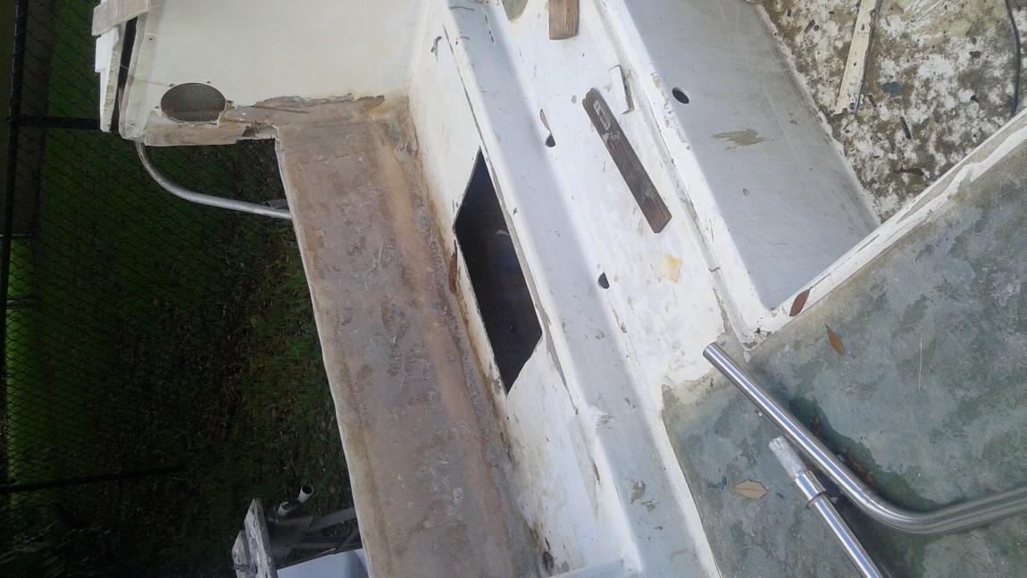

Old 07-02-2016, 12:30 PM
Well I'm done with the top cap and I'm waiting for my son and some of his friends to flip it and put it back on. Took a pic of the raised transom up to 26.
It going to be raining here this weekend so I don't think much can be done.
