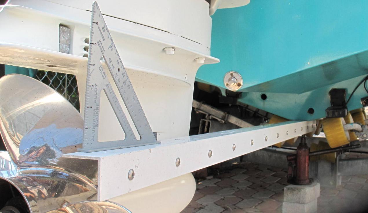

Danny here's how I did mine. I took a 5' piece of aluminum square tubing and jacked it up against the keel of the boat, along that flat spot. Then I tilted the engine so the cavitation plate was parallel to the tubing. I then clamped a piece of 3/4" square wood to the bottom of the plate to get my measurement, In this case it was 3/8"....not good!
After I installed the jack plate I did the same measurement process. And then screwed the jack plate up to where the cavitation plate is 2" above the keel. Please notice how ugly my engine's lower unit is compared to yours. That's 12 years of being run hard and too poor to buy another one. |

Hey Danny,
Your pics of the AV plate under way look about like mine! Hard to see a white plate under all that white spray! Need to put some black electrical tape on top of it to see it until you get it high enough! I've also attached a pic of the height measurement setup. Been thinking about comments from Ken and others, and I believe it's hard to conclude anything about prop selection and potential motor issues till you get that AV plate up out of solid water. The propeller hp vs. rpm curves I've seen in Dave Gerr's propeller book look fairly linear, so I would think that you should be able to spin the same prop as a 250 Zuke 10% faster if your motor is really putting out 20% more hp! Sounds like Don has the motor height dialed in pretty well, although the setback of his jack plate should allow him to run a bit higher than if it was mounted on transom. With 30" of setback, I'm slightly over 4" and it's STILL not high enough! Denny
