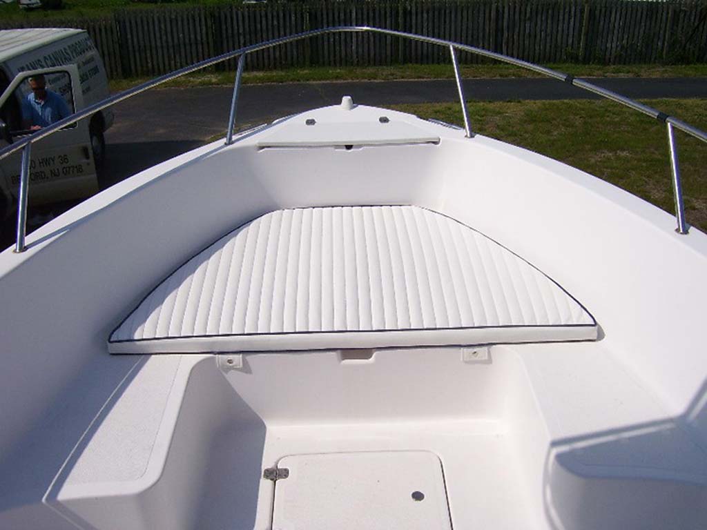

Has anyone added bow seats/storage to a 20 MA? Raise up the forward deck making a deeper fishbox/cooler. Something like this

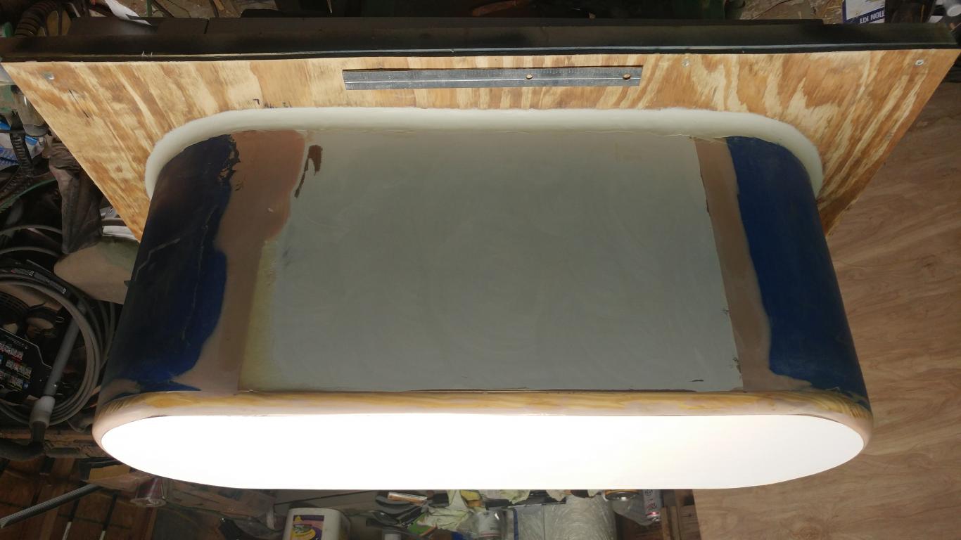

Since it has been too cold or rainy to work on my cap I have been puttering around with a mold for my baitwell. It will be a drop in under the console seat. Here is a pic of the mold. Here are my thoughts on a layup. Gelcoat then 3/4 oz mat then "tape" all the seams with 1708 4" wide then a 2-3 layers of 1708. Built up to 3/16" thick. I will then tab some gussetss inside the console to support the walls and bottom. Tabbing it around the lip of the original console seat.
