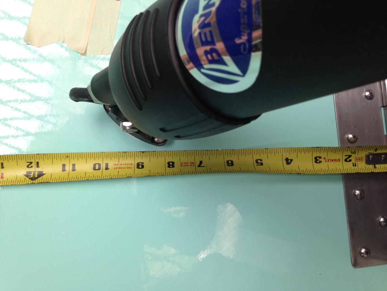

Looks like the Bolt Edge Mounted tabs 1212ED will work. Only eats up 7”. I’m considering the auto tab controller. Is it worth it?
  #43
Old 05-14-2018, 11:26 AM
I'll try again, the Bennett 1212ED tabs will "eat up" 9.75" up your transom. Sorry about the sideways pictures, dang iPhone.

Thanks for the measurements. I would have been screwed.

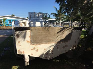

I’m back at it. The temperature has dropped and I have a goal to get to paint in January. I have the bilges gelcoated along with the insulated fish boxes. All the transom holes and voids have been filled. The vent holes in the gunnels have been filled. I’m starting to install the fuel tanks. I have the lines run. Was really tight running two sets of hoses but I managed. Just need to get the fuel restraint brackets bolted in. Next up will be to add lights to the fish boxes.
I messed the deck up a little by not using enough resin in the first layer . I left small air bubbles under the duratec. They are the size of a BB or smaller. Found them when pressure washing. I’m planning on pulling the deck out and hitting it good with the pressure washer to expose the voids then fill them with fairing compound and sanding. Hope it works. I don’t want any opening up after finish painting. I also need to find time to work on the deck hatches and receiver lips.
I cleaned up and pulled her out of her tent into the sun for the first time in a year. Took her to a local shop to talk about having some fairing and painting done. I put the front edge of the center console 10” in front of the fuel chases. The leaning post has a 16” gap. Should move the CG forward some and opens up the transom for fishing and diving fun. Looks good.
I’m looking for a bracket. Armstrong is pricey at $3700, A & J quoted $2900. Still looking. I’m most concerned about the finish or powder coating coming off. Does anyone have suggestions. Looking for a 30” setback 12 deg, 80” platform with a floatation chamber.
