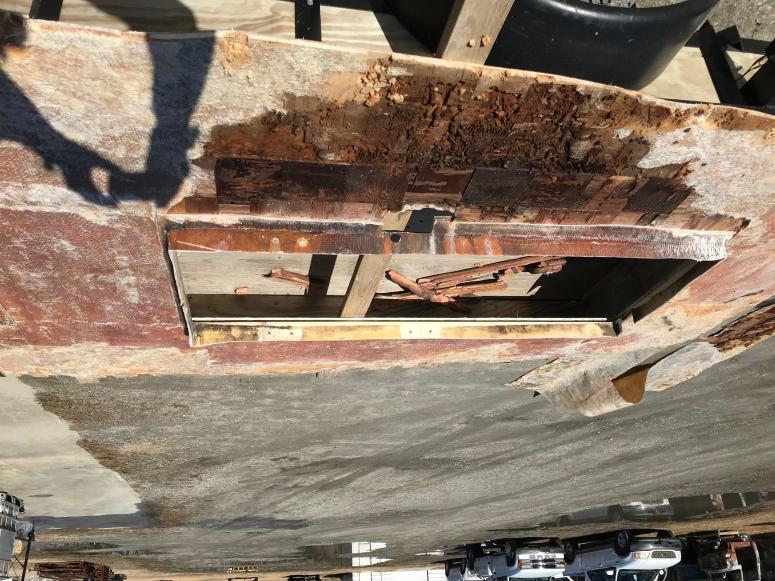

Originally Posted by take a potter View Post
Really a shame to remove the whole sole. Other than 3 or 4 soft spots it was in great shape.
This is what 1- 6" soft spot looked like on my 18 from underneath.
http://www.classicseacraft.com/commu...1&d=1614255920
  #42
Old 02-25-2021, 10:16 AM
take a potter take a potter is offline
Join Date: Apr 2012
Location: lexington, virginia
Posts: 85
Interesting, my largest soft spot was about 18" wide and 30" fore to aft. It was located just to the left of that delta shaped potter putty mark on the above picture. From underneath you can hardly tell it was there. Two years ago I drilled about 40 holes in the area and injected it with gorilla glue just to get me by, knowing that the rebuild was in my future. I figured when I tore this up there would be gorilla glue every where under the sole, but nothing came thru the bottom skin.
Whatever day they made this boat back in 75, they really did a good job of sealing everything up. There is still the original dust from where they flattened some of the pour foam on the outsides and tops of the stringers.
All the foam is as dry as can be. That was a relief.
