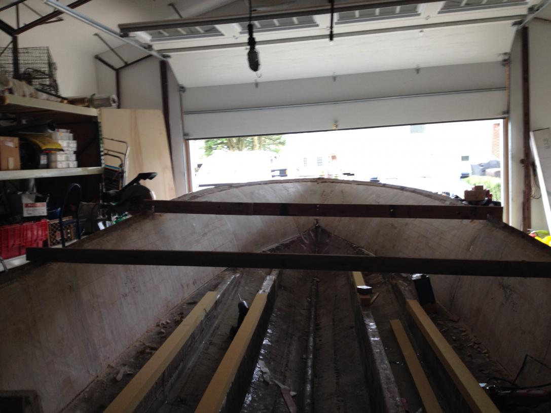

Hey guys i forgot to show the braces i have going across the hull to keep shape . I learned from stricks mistake ! I have 2 braces in one at 5 forward and another at 10ft
The foam is from north american composites. They are a wholesale place so yu must have an account to purchase from them
I did the hull sides in balsa because i have had good luck with it and it stiffened it signifacantly.

As I understand the corelite is PVC. I'm using some on my rebuild. Very easy to cut, is water proof and so far pretty strong. I didn't do my transom core with it though. I paid $124 for half inch sheet,so it's not cheap.

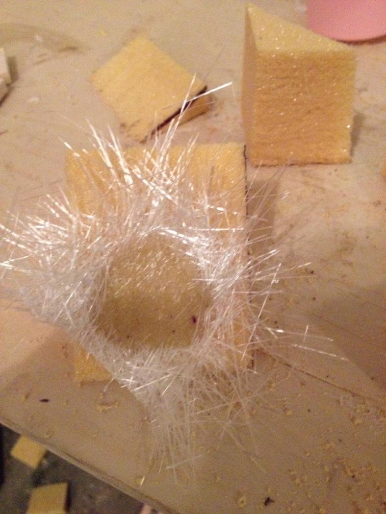

I put a little test sample on a piece of foam to show that the poly doesn't eat through it like the pink foam from homey cheapo
also the braces on the hull

Right on man. Def should be strong. I guess tho the balsa is not adding much weight at all.
