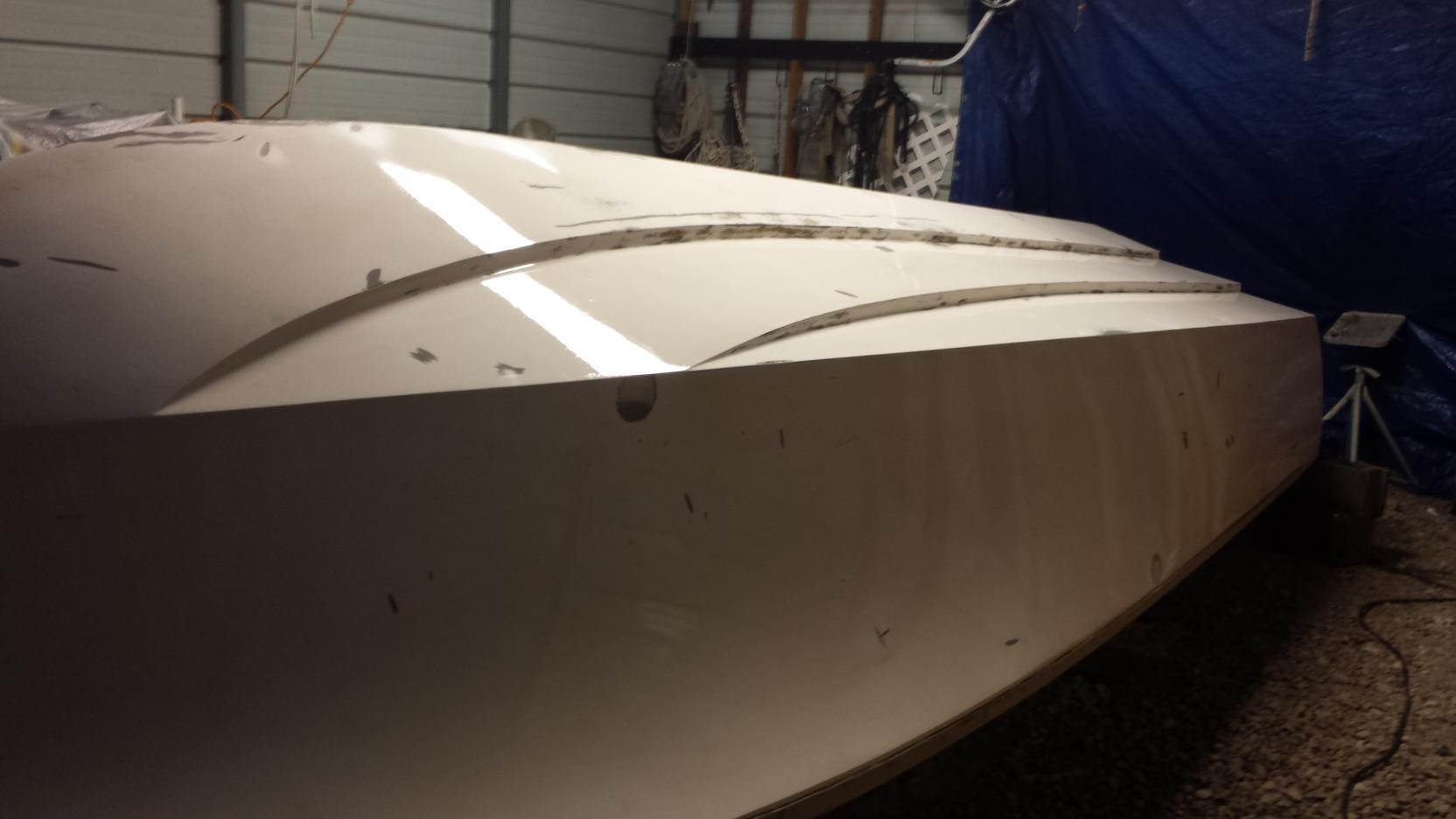

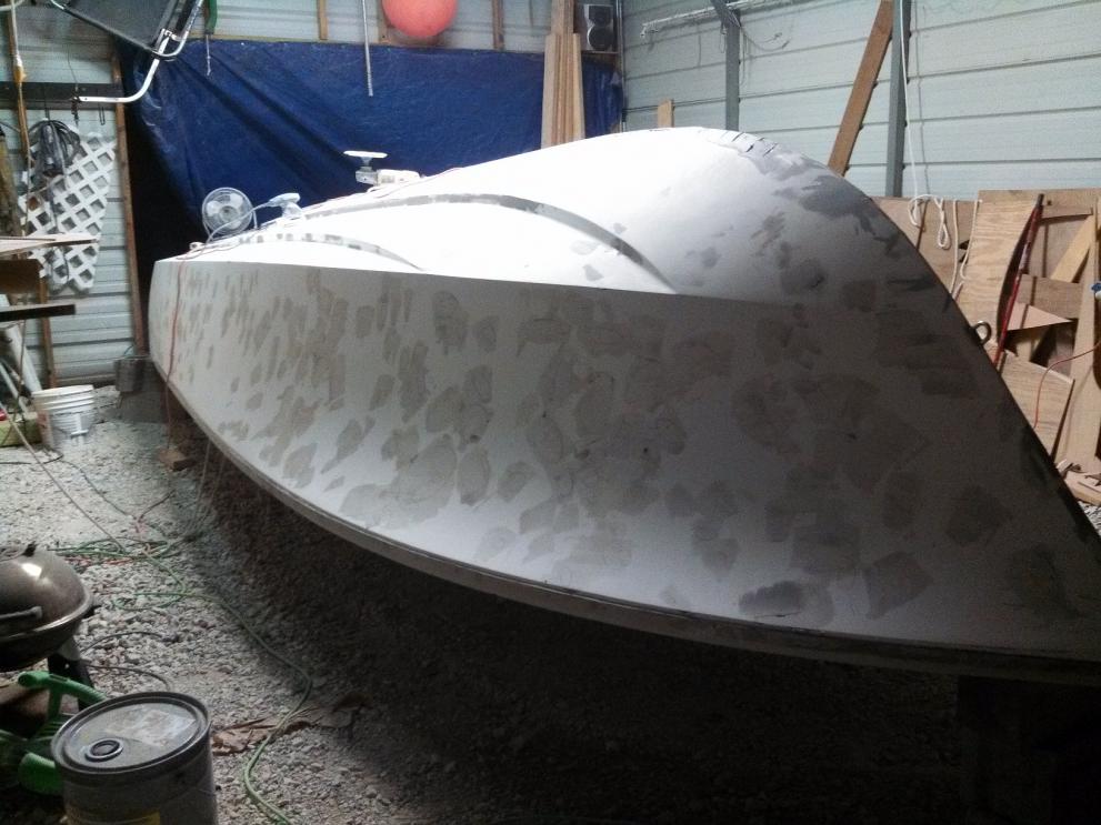

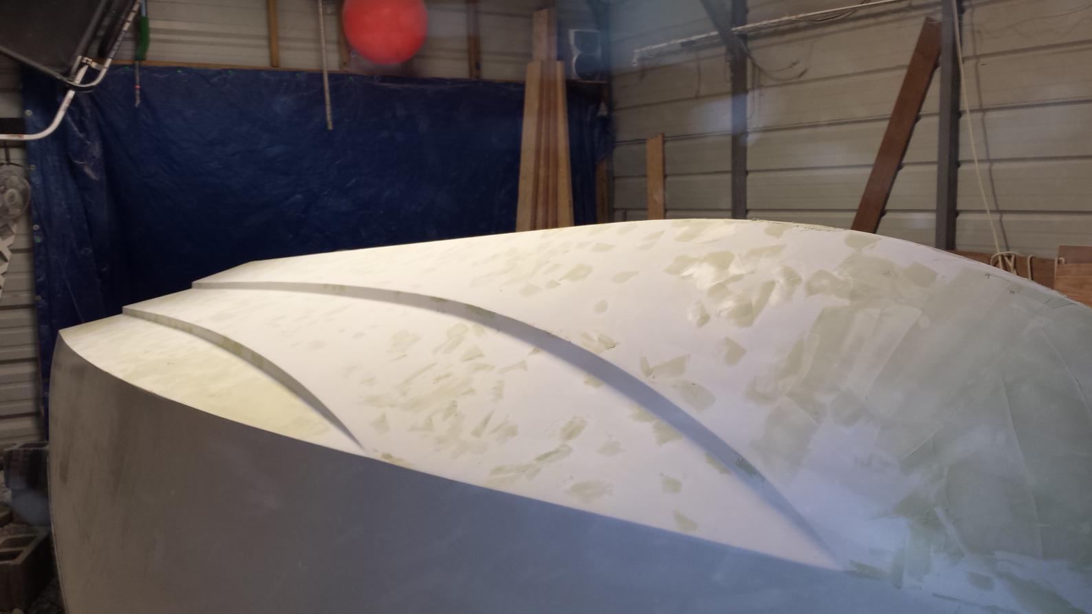

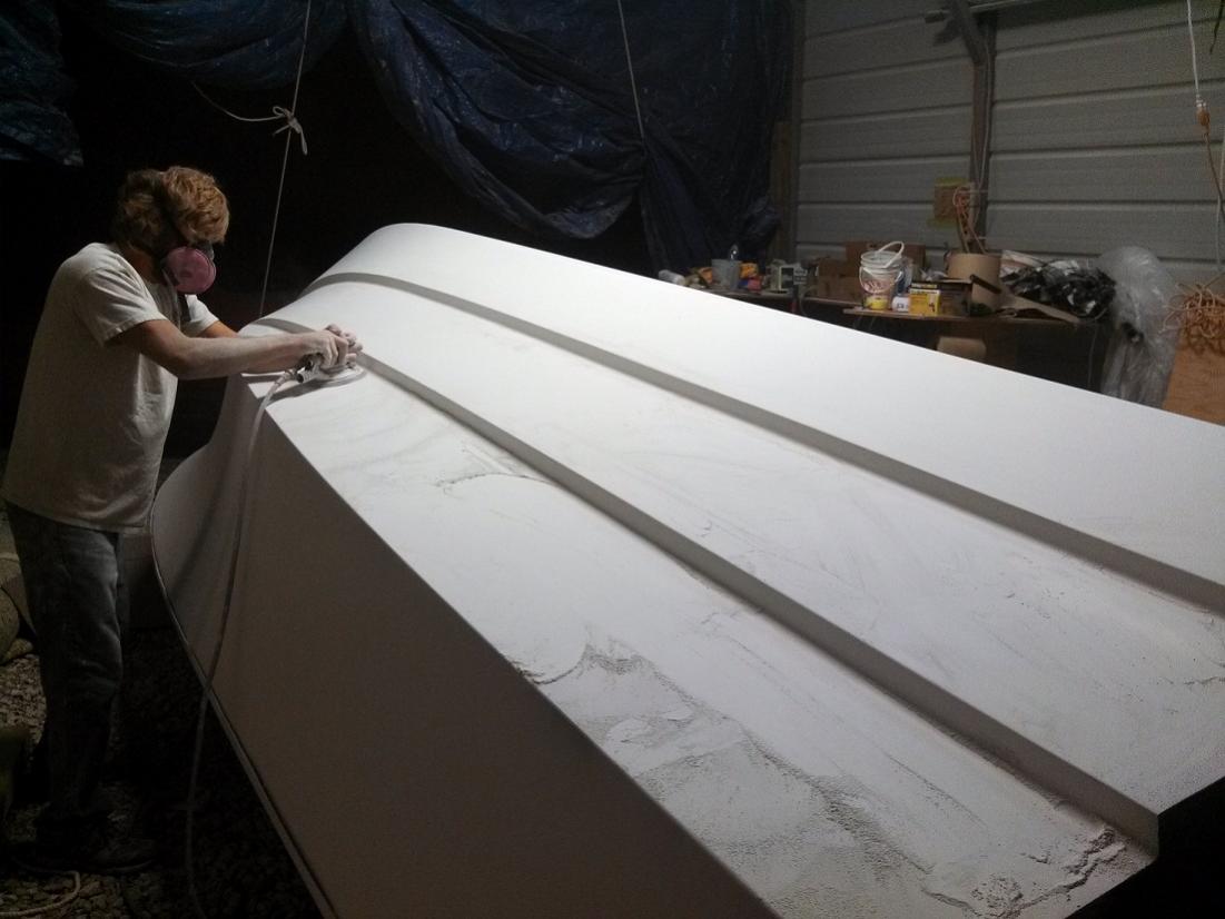

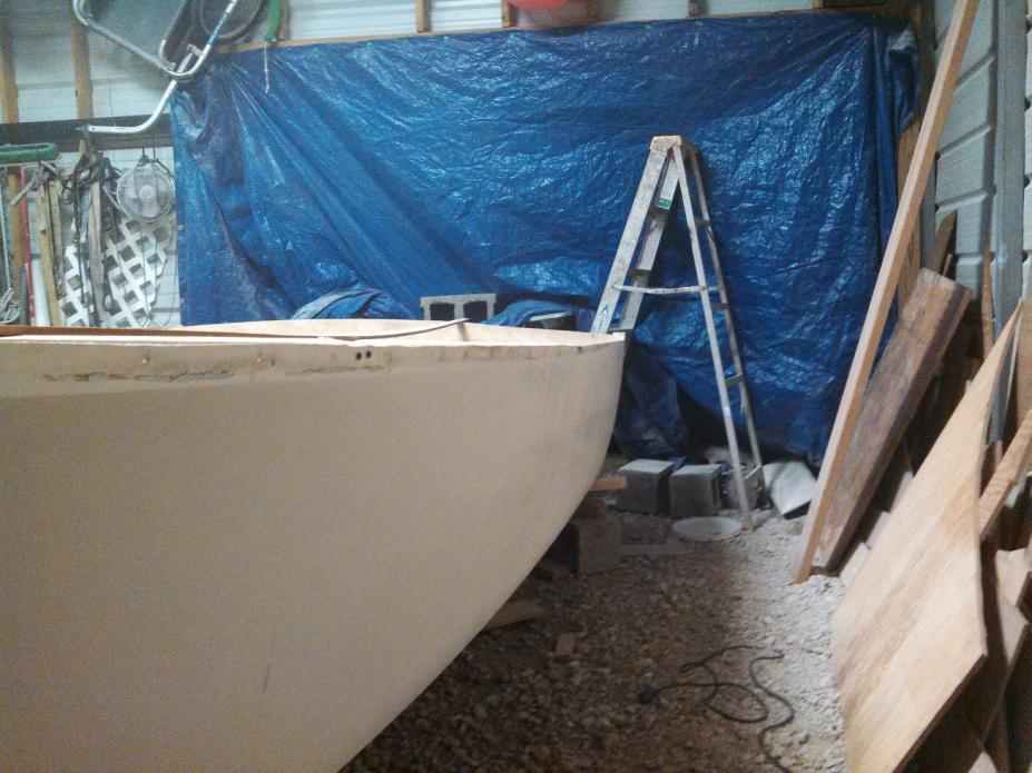

Pulled putty on last time last night. Sanded tonight. Then final prime tomorrow.

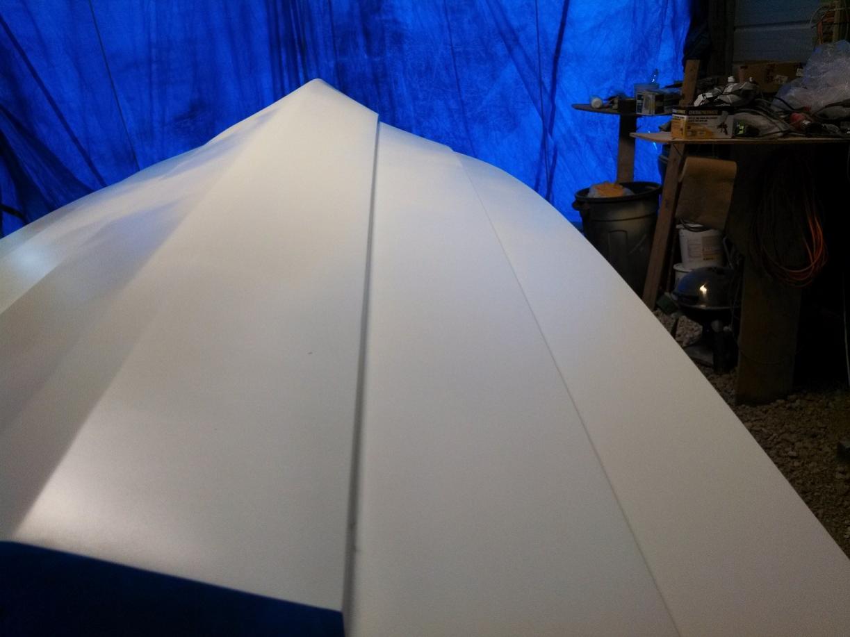

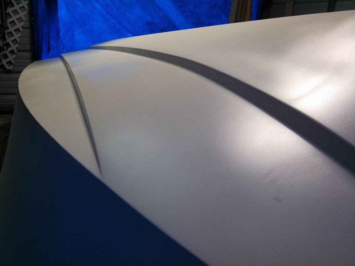

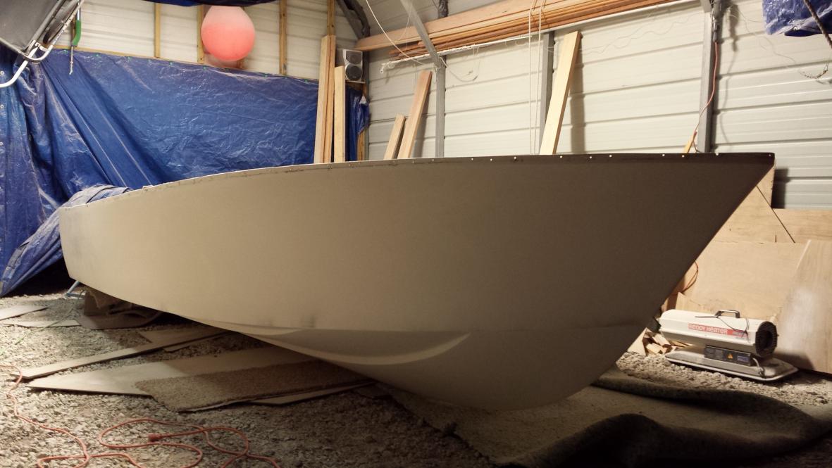

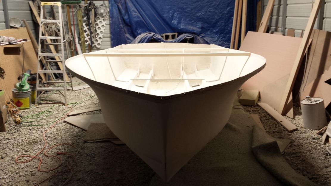

Finish primer on the bottom.
Old 11-04-2013, 11:13 PM
Join Date: Jan 2008
Location: Morehead City, NC
Posts: 352

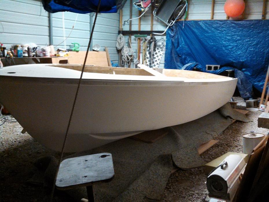

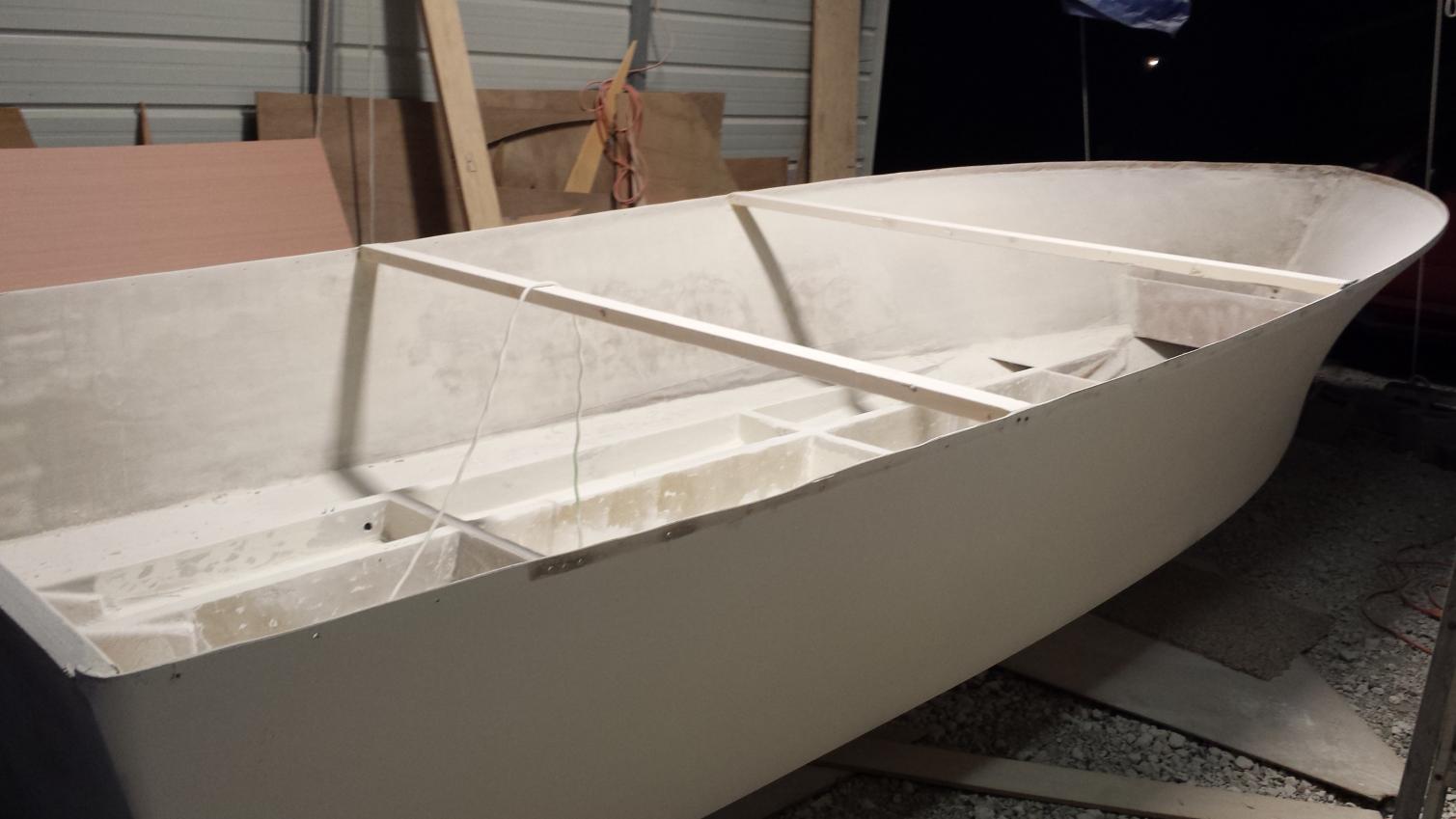

Got the bottom guidecoated and sanded. Smooth as a babies butt and ready for finish paint.
Flipped back over to start the inside.

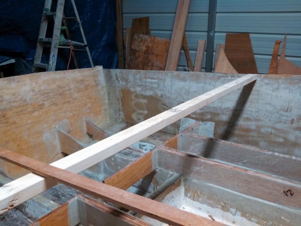

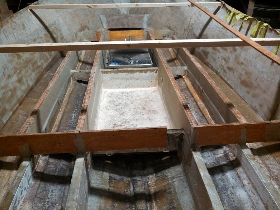

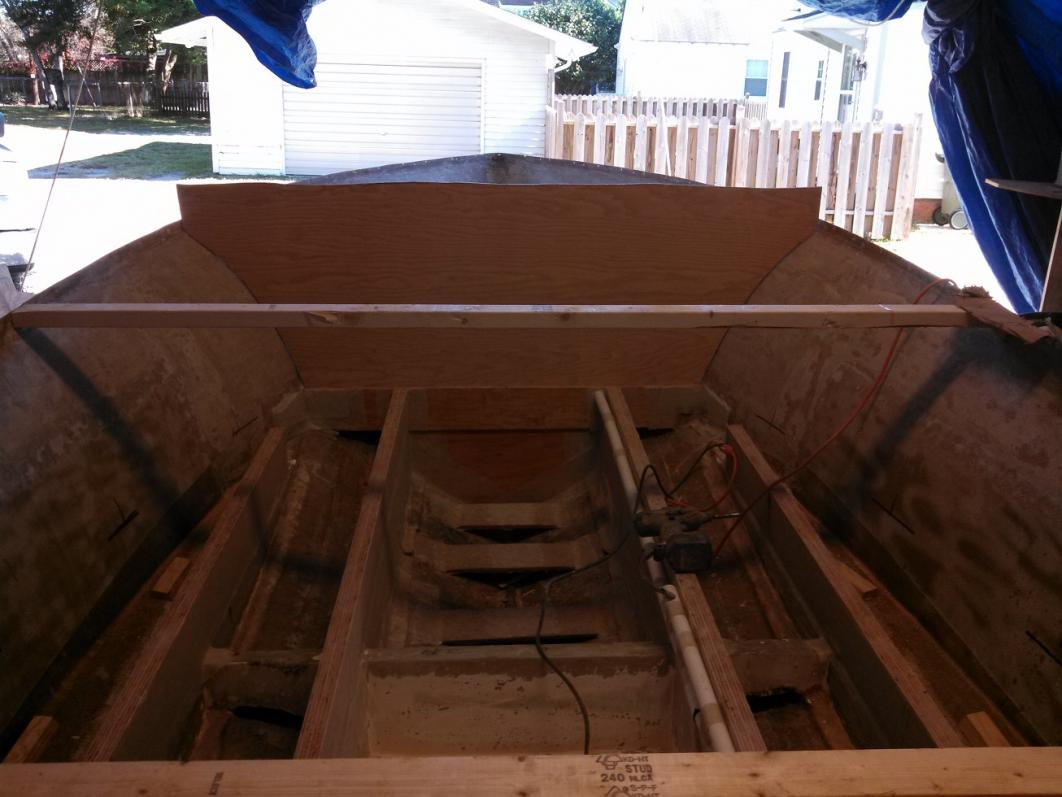

Cap off and stringers grounded down ready for the new stringers to be glassed in tomorrow. Hardest part was removing the rivets. Dang pain
Old 11-07-2013, 12:30 AM
Join Date: Jan 2008
Posts: 352

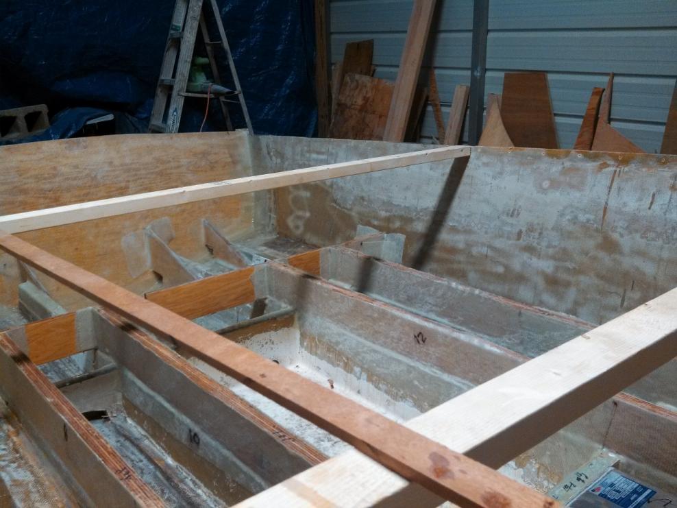

Glassing in the stringer raising.
Old 11-07-2013, 09:46 PM
Join Date: Jan 2008
Posts: 352

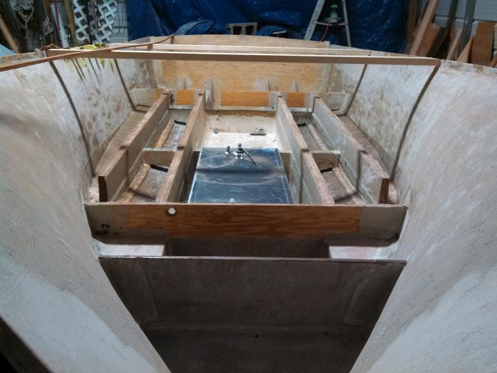

Stringer extensions glassed in. Getting tank ready to install.
Did some shaping on the port gunnel. Didn't get too crazy with the cut. Only about 1 1/2" at the transom to a gradual slope to the shear.

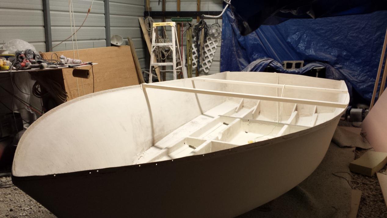

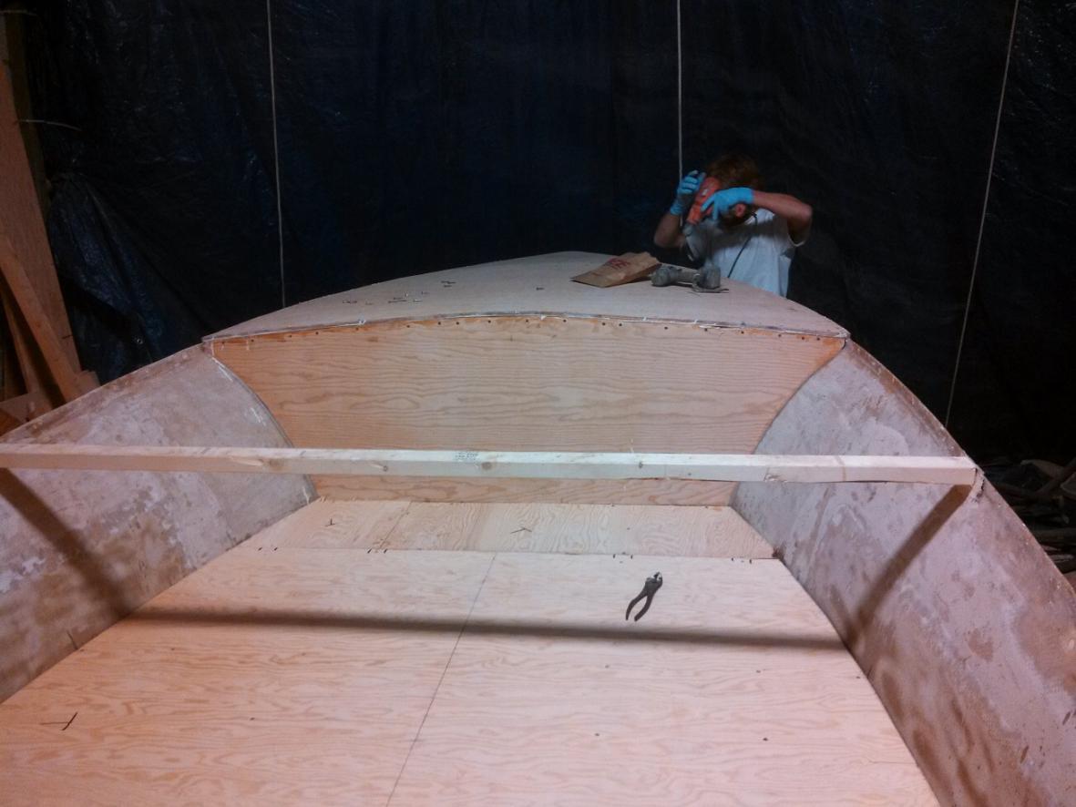

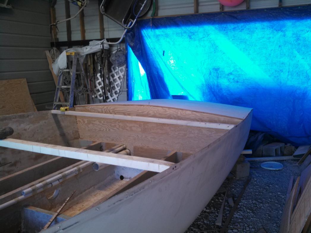

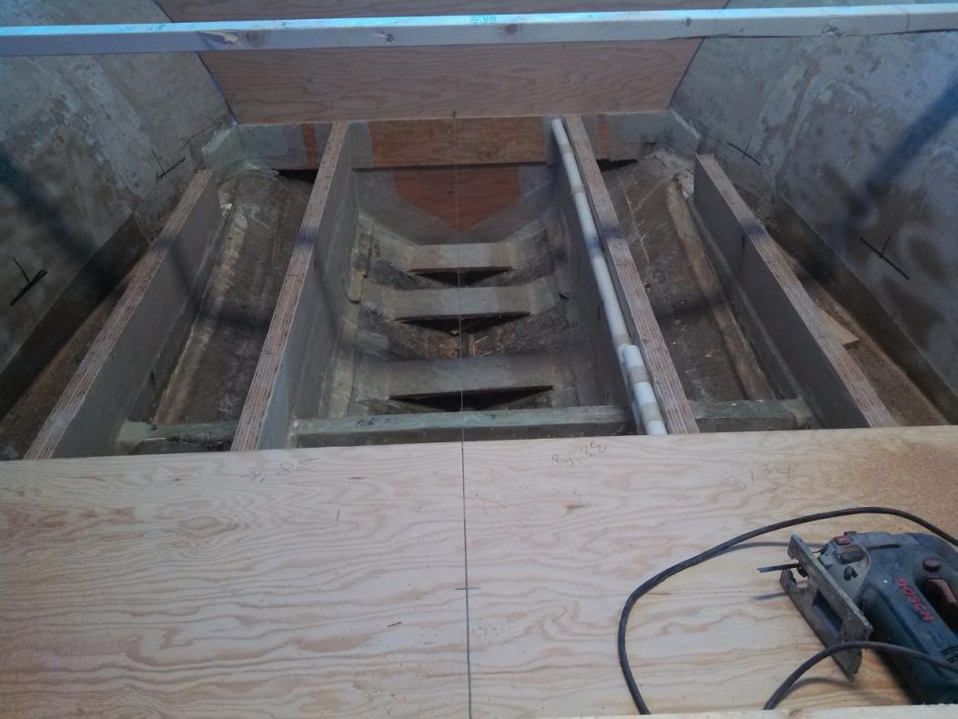

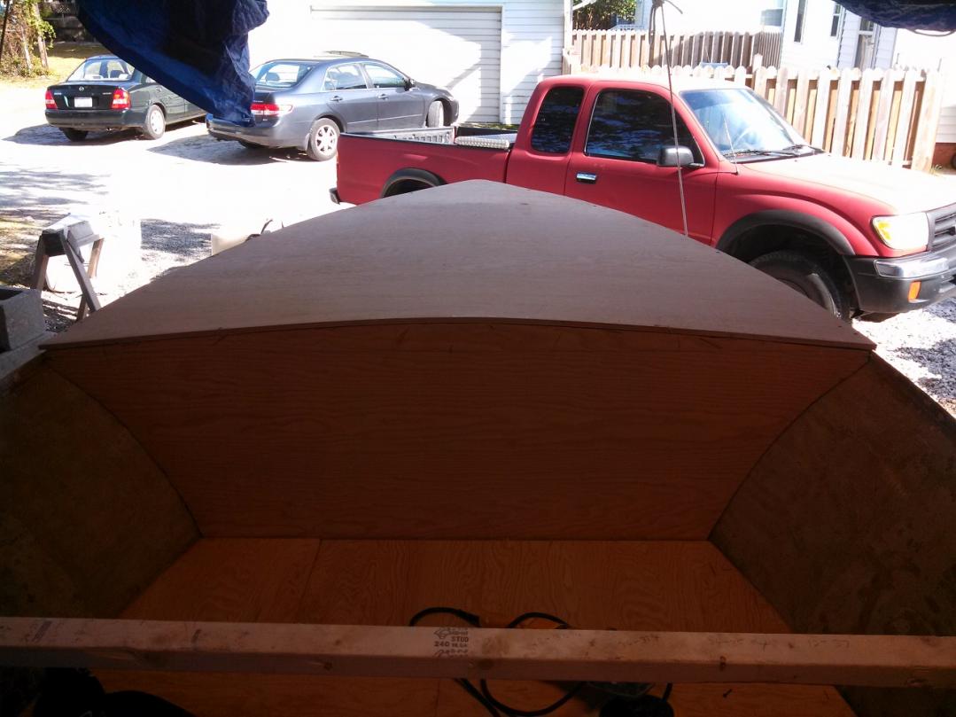

Got the front and rear bulkheads cut and fit. Cut and fit the floor. Left the bulkheads high to put about 3 inches of crown them.
Old 11-09-2013, 07:49 PM
Join Date: Jan 2008
Posts: 352

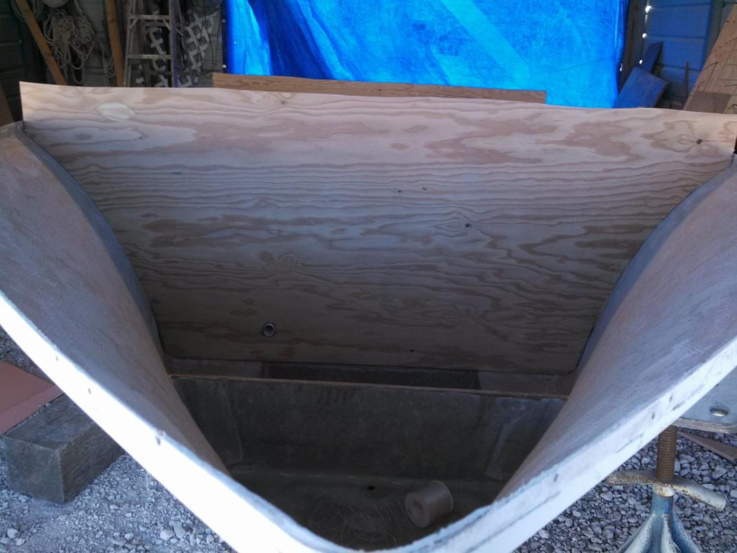

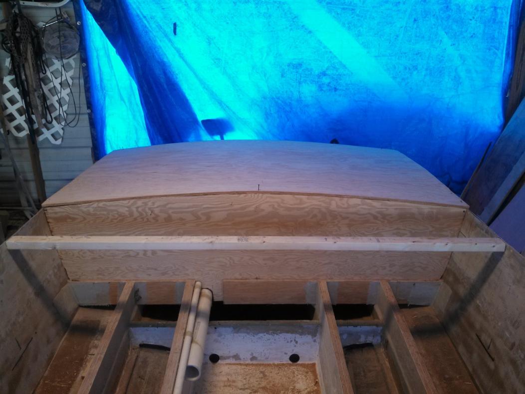

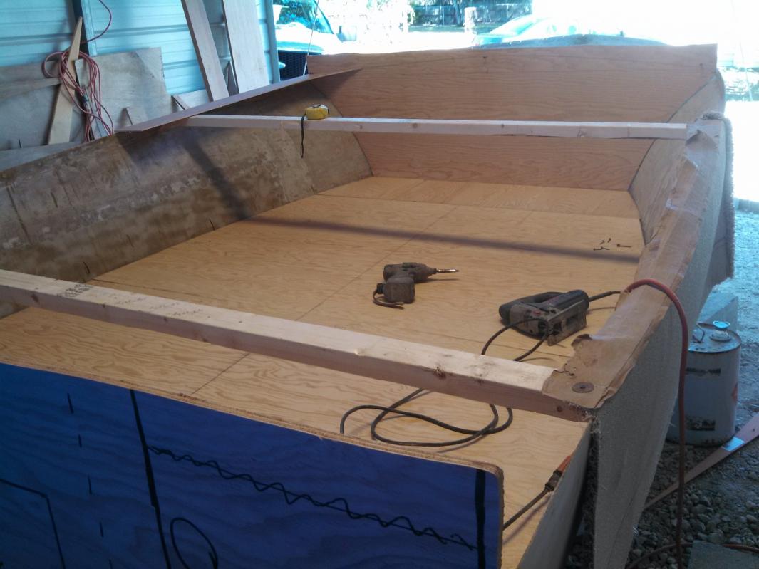

Cut down bulklheads. Front and rear decks cut to fit.
Getting the tank bed prepped for tank installation.
Old 11-12-2013, 08:51 PM
Join Date: Jan 2008
Posts: 352
Front deck and floor glued and screwed.
