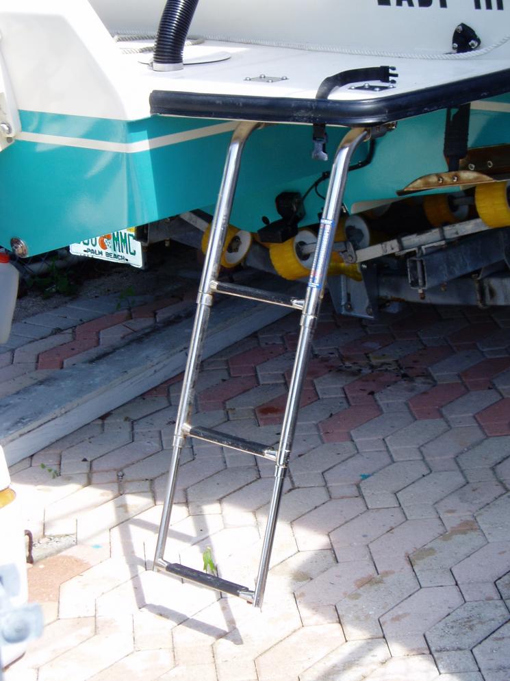

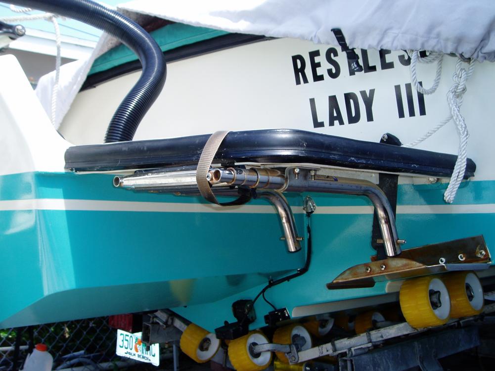

On the width of swim platform, you might want to consider extending it far enough past flotation tub to be able to mount a swim ladder underneath platform! Regarding angling bottom of swim platform, you're losing some flotation doing that. Looks like you're planning to mount it a bit lower than mine to gain flotation (good), so understand desire to prevent dragging in water, but might want to send a PM to Don Herman about that. The Hermco bracket is straight on bottom and longer (30"), but it doesn't drag in water when on plane, even at 12 mph. Even if it did drag temporarily coming on plane, it would act like a trim tab and provide more stern lift to help boat get up on plane, so I don't think that's a bad thing! Might look at making bottom straight with no slope but mount about 4" up from bottom, and see which design has more flotation.
Thanks for the insight, I can make the swim platform wider for the ladder to fit under and that might be a nice addition for the kid getting in and out of the boat (this will be out family boat). How wide of a space is needed for a telescopic ladder like you have? I was going with the 72" wide unit due to that is what my last one was on the 20' hull and I already have the top half mold built. I wanted to make it 84" wide but after looking at the rear of the boat the 72" would give me clearance for the rams for the trim tabs or the K planes that I will probably use. I have the tub so wide and the swim platform so low it doesn't leave much room for the tabs rams. I want the platform low to the water as possible and even with the low clearance model tabs I don't think I have enough vertical room to mount the top of the ram. The narrower platform will let the rams mount beside the edges and clear the platform. I don't want to cut holes in them and run them threw the swim platform or I don't want to use the Volvo tabs (they are nice but not good for my application). I have a sketch of a custom trim tab I will build if I do not get the expensive K planes that is similar to Mr BlueHerons tabs. It looks like I go with have to go with the more narrow platform and have room for the rams or I will have to make some kind of low mounting custom rams for the tabs that will mount low enough to clear if I make the platform wider. I don't mind making a new mold for the top half, but just need to figure out the details so the ladder and tabs will all fit correctly or it will not be worth doing and then it will make more since to use the 72" mold I already have.

You can buy ladders in various widths. The one I got was a Windline and needs 13" of width to install. It's a clever compact telescoping design, and works well when lowered, but the top section has to slide thru some U-shaped brackets lined with teflon so can be a bit difficult to raise and lower unless you remember to spray it down good with some silicone or super lube before you launch the boat! There may be other designs that are easier to deploy.
