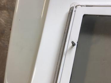

Thanks. I found them!!! Will try your method later today. So, I know this is fine detail but my issue with these on at least my boat is that the legs on the loop hatch are short and thus, don稚 engage the frame to lock. These seadog ones have short legs as well. Now that the hole is where it is I知 not sure that even a replacement will engage the opposite frame to lock. I値l maybe have to start in a new place and bring it further out? I知 sure someone else will run into this if they haven稚 already. Regardless, these are a major PITA.

So, I know this is fine detail but my issue with these on at least my boat is that the legs on the loop hatch are short and thus, don’t engage the frame to lock. These seadog ones have short legs as well. Now that the hole is where it is I’m not sure that even a replacement will engage the opposite frame to lock. I’ll maybe have to start in a new place and bring it further out? I’m sure someone else will run into this if they haven’t already. Regardless, these are a major PITA.
Sounds like your frames may have loosened up - check that first.
If everything is still tight and the new latches don't fit then measure how big they would need to be and I can modify the file to those dimensions - then you can print custom ones. Buying NOS off Ebay is definitely the best answer if they work.
Also - you may be able to carefully cut the nuts off with a dremel or break/split them with a small nut breaker/splitter

So I got the three that were bothering me off! My window is tight. powder coated it not to long ago so I知 guessimg they put it back on right.
No problem, just did the needle nose technique. I ordered the seadog ones, Thanks Zack. Does anyone know if they are the exact same size? One of my pegs is mis-firing bc they started to far off Center. Not sure why? I知 not sure that the new one will even help me any or not. I知 not sure I can move that peg over any without taking off the windshield unless someone has a better idea. Thanks again
