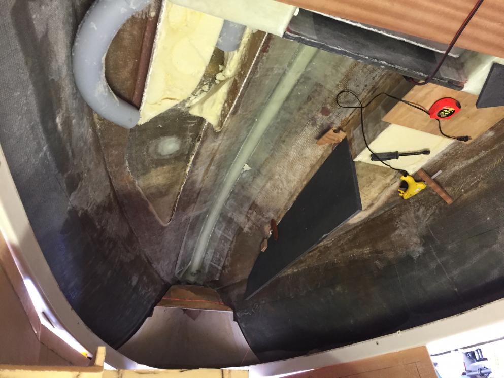

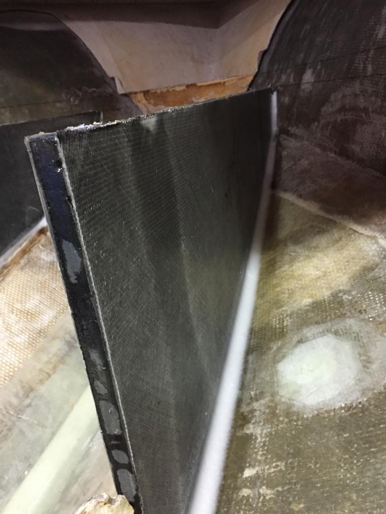

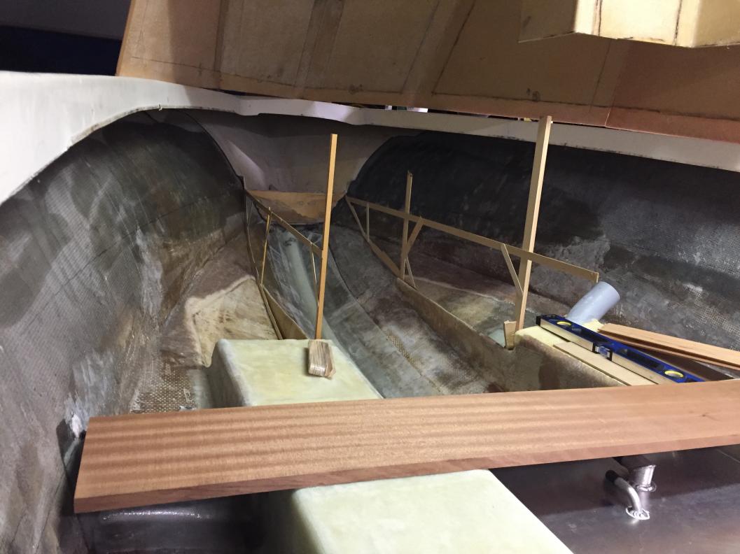

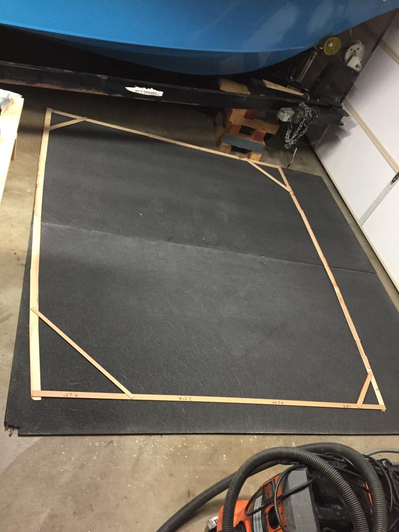

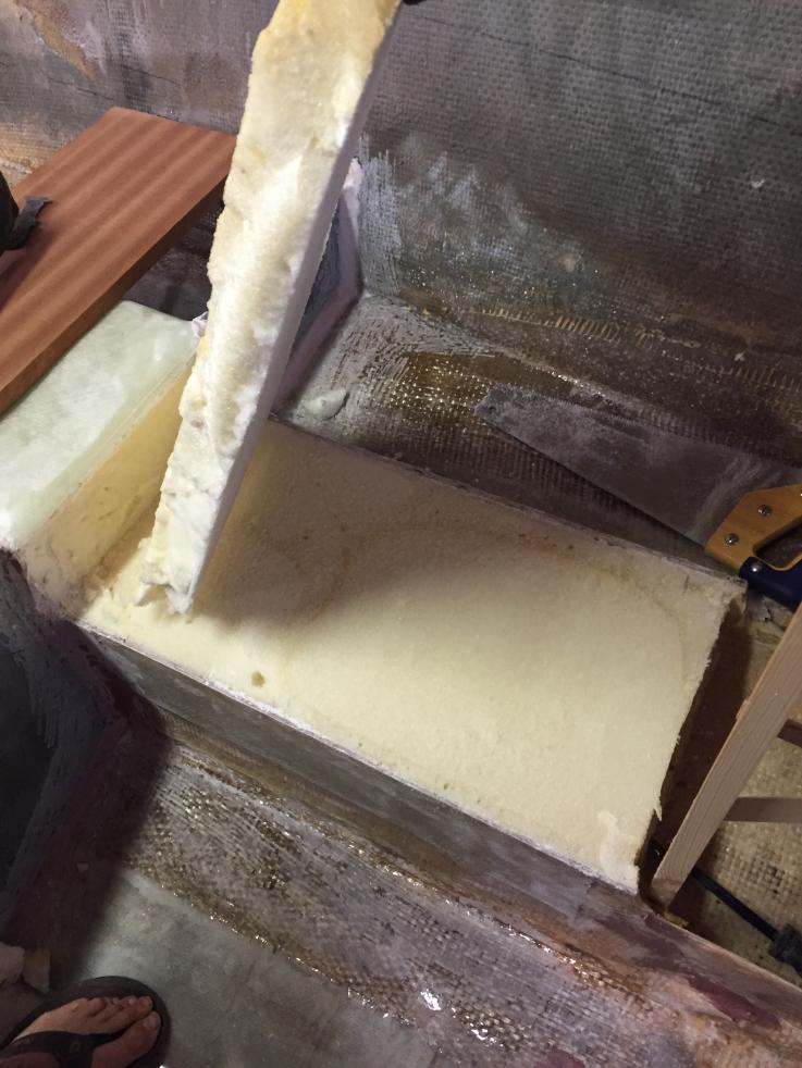

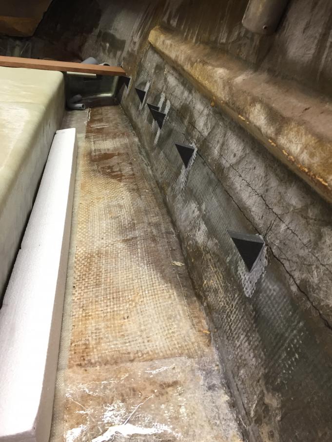

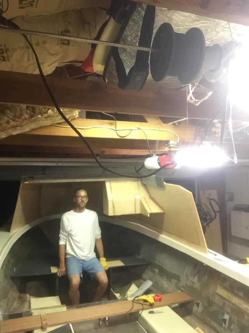

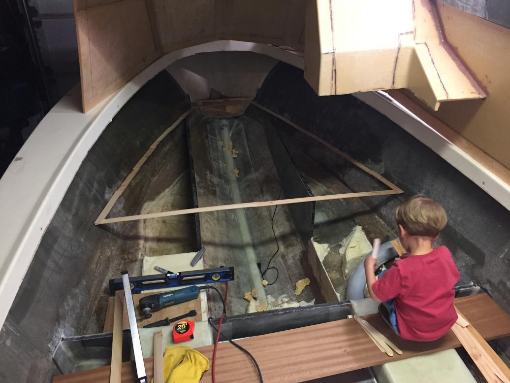

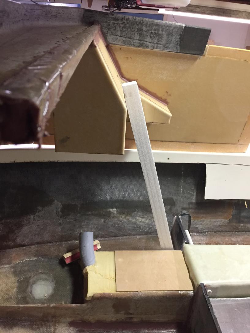

I've been slowly making some progress. The main deck is cut and fitted. and the fuel conduits are drilled and fitted. I've realized I messed up my main conduit location so i'm going to dig out some foam and move it back a 2'-ish. I also decided to lower the cockpit floor more than originally planned. I'm hoping to get the front stringers and deck cut this week.

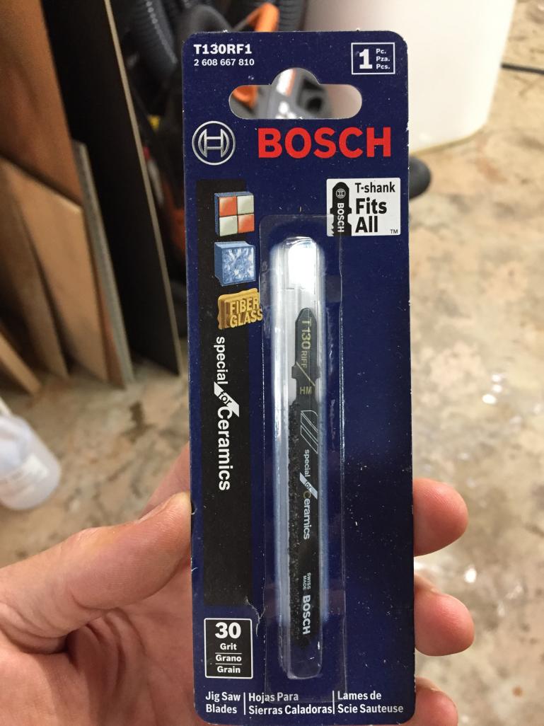

Try the acrylic jigsaw blades too. "clean for plexiglass", they have red paint on em, Bosch too. They last a long time cutting glass and cut real cleanly...

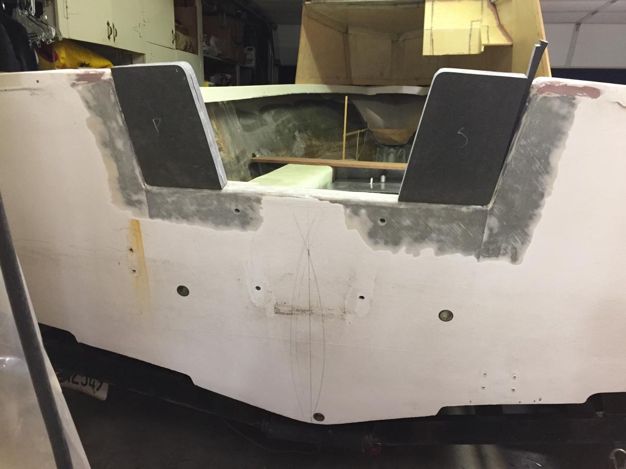

I'll pick some up. I forgot to say I've used the 30 grit saw blades on the coosa and have used the same one through the whole project including the transom, and it's still cutting great.

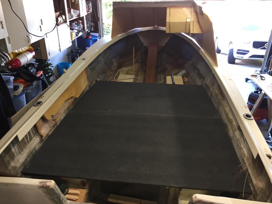

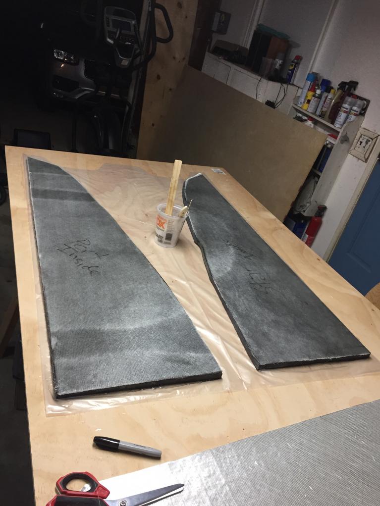

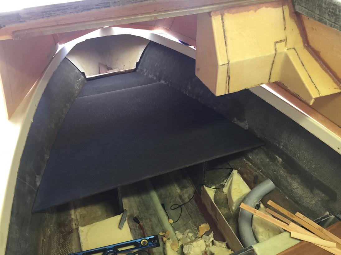

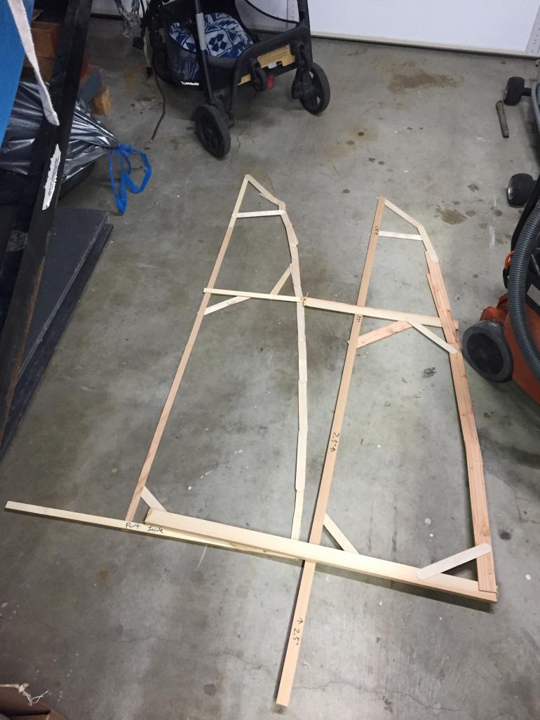

Posts: 177
Some progress photos. I need to order more epoxy before I'll be able to glass the decks.
