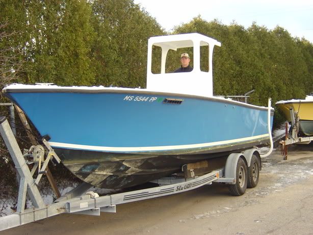

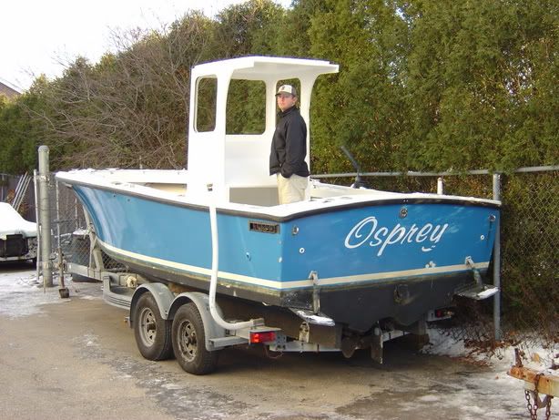

Just a few more pics. These are the first pictures i have had with me actually in her. MAN, I LOOK GOOD.

Looks good...(the boat that is)

Chance, dog house looks good!!
Snow on the trim tabs, already? Glad I live south. See ya, Ken
