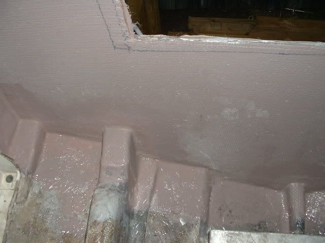

Added some more glass around the edges of the transom last night. Followed up this morning adding some roven supports prepping for the final layer of roven on Tuesday Night.
Glassed the fiberglass tanks supports in today as well.

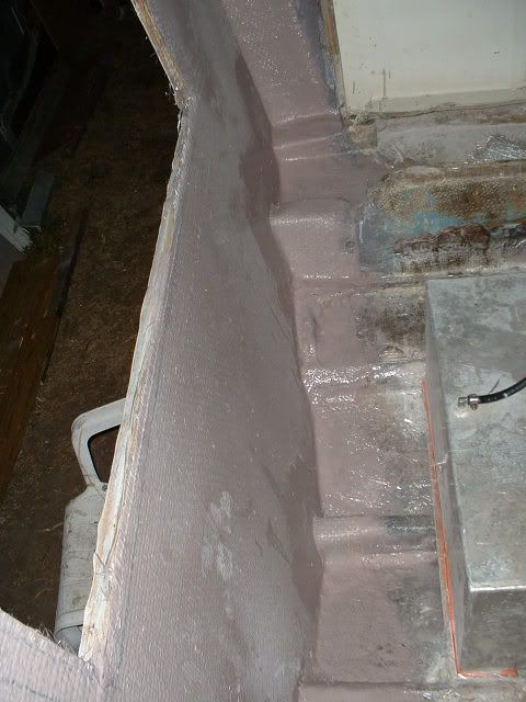

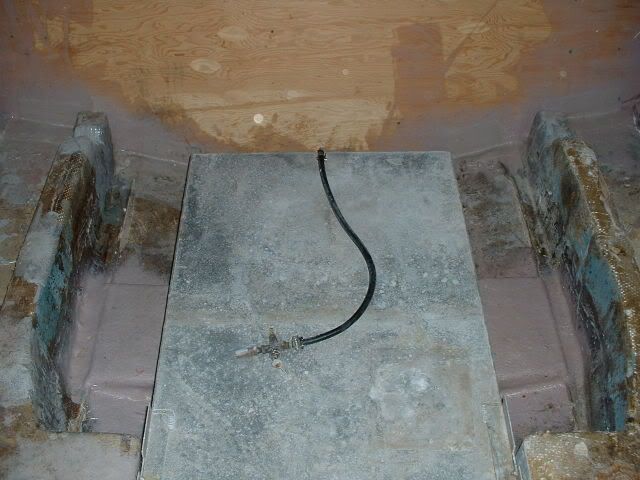

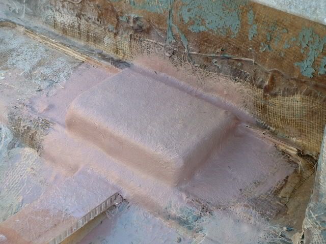

Removed the old water logged ply wood under the area where the battery boxes used to be located. I replaced it with a foam core followed by three to four layer of chop mat. Solid, water proof, and will never rot or hold water. These two platforms will be for my oil resevoirs. If I decide to go with four strokes for my next set of motors, they will become storage.
Some grinding and clean up, and they should do just fine.

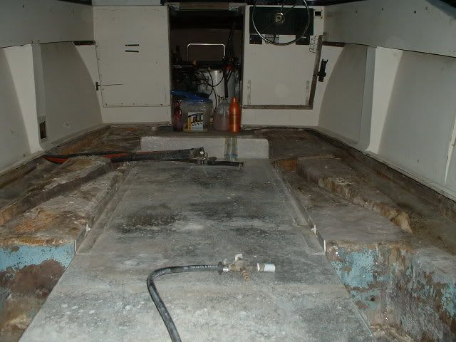

Finished up the bilge and decided to set the tank to get it out of the way. I never totally removed from my boat, as it still has 50+ gallons left in it.
This shot is of the tank in place as well as the oil res. platforms.

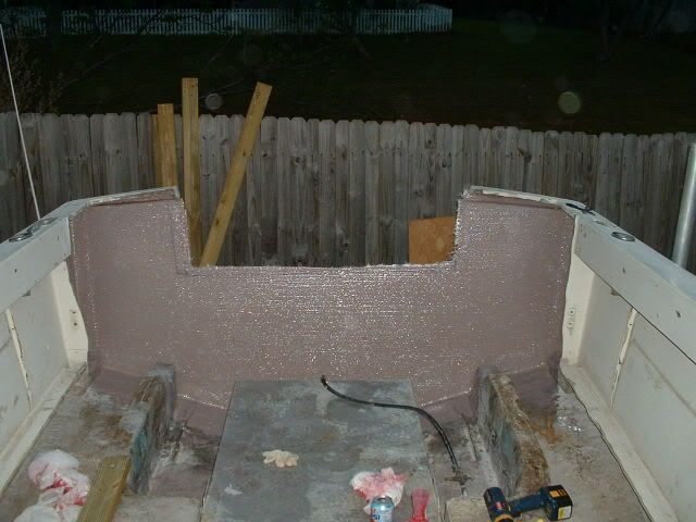

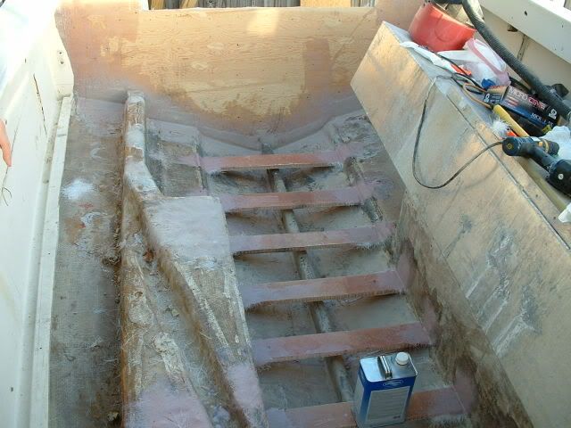

Transom shot facing the bow. Took off another 30lbs of that putty crap used to stick the original deck.
Next on the agenda, finish final layer of woven roved on the transom, fill in the deck scuppers, grind and fair out the out side of the transom.

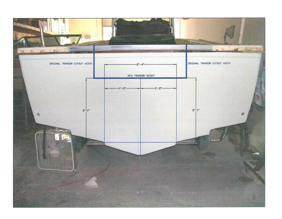

Completed final layer of 24oz woven roven on transom. Came out good, but it shure soaked in the resin.
Need to measure, cut and cap the transom at 25 inches.
With twins, the transom can come up a few more inches
, I think. Anyone know what the over all measurement
from the bottom (apex)of the hull? A diagram, or some
kind of photo showing where the measurement should be
taken from would helm. Thanks for any assistance.

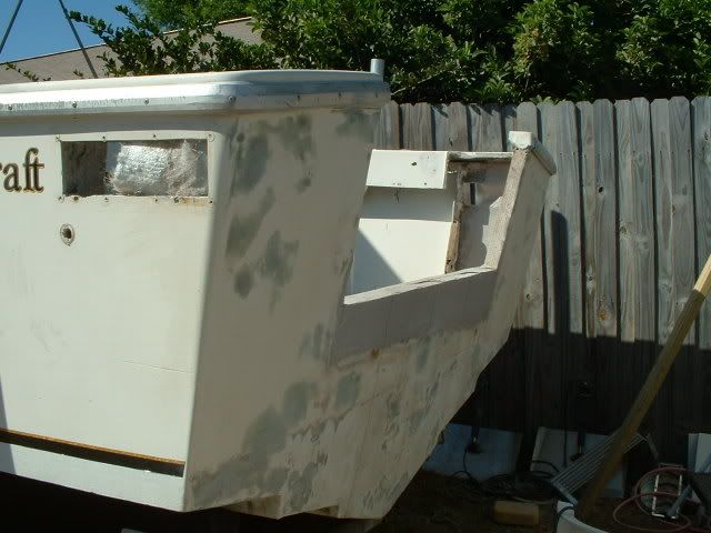

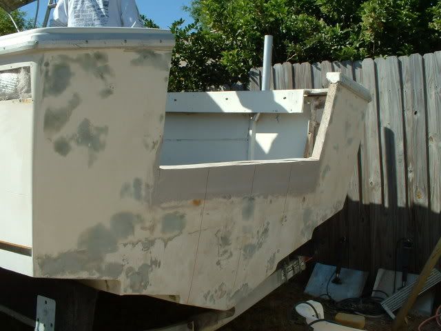

Find a vertical centerline on the transom. Measure out each side for the new motor centerlines. Standard was 26" centers so you would go out 13" from the centerline each side. The new 4 strokes want at least a 28" engine center line so you may want to setup the holes for 4 strokes in case you repower in the future. Measure 25" up from the engine centerlines for 25" shaft length motors and this will be your final transom heighth. Make a horizontal line at this heighth and cut your transom. Be sure you have allowed enough width for steering cyllinders and cowling clearance to the outsides.

Thanks Hermco,
If I understand you, this is what your talking about, please advise. Did I take the transom height measurement from the right place? or should it be on the lower chine. Thanks again for the assistance.
I borrowed this transom photo from earlier in the post! Thanks guys!
Jason

Measure up 25" from where the engine centerline begins at the bottom of the boat.
