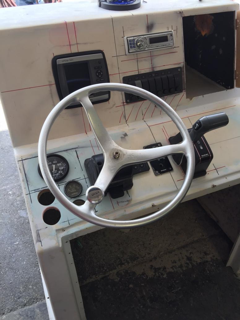

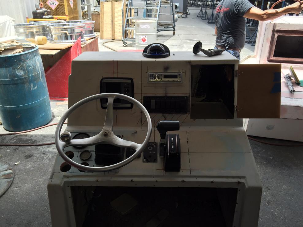

Finally, after the boat sat for one month with nothing happening, now we are making progress again. In the last 2 days, the center console has been redone. The next stop for the console is the paint shop. Check out the new layout. And when the new smaller 13.5" steering wheel is installed, everything should fit nicely. The steering wheel was separate, go figure!
Note, there is room for a much bigger GPS... just sayin'. Maybe when the boat is done, I'll save up for a big-screen.

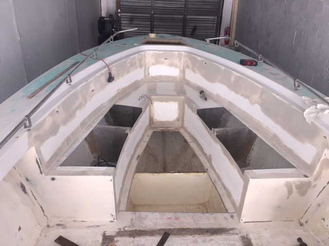

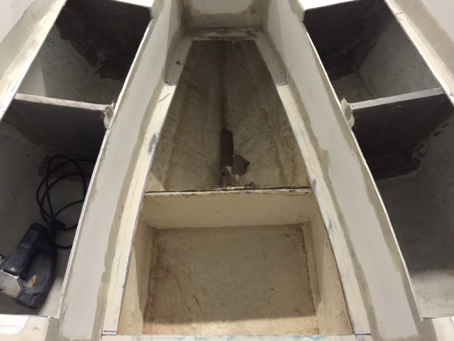

Cutout for storage hatches in floor and seats. Also cut out for anchor locker.

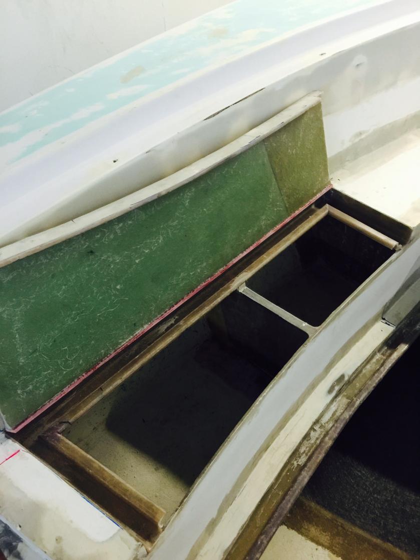

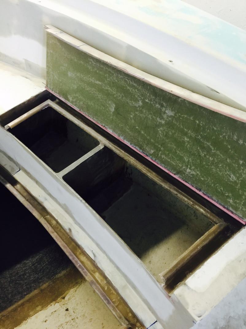

The hinges and lids are on the front seat storage now. It's easier to see in the video:

Gutters installed around the edge of storage in the floor. Also removed bulkhead inside the storage compartment and the front section has a flat floor now.
https://youtu.be/95D2qHhL9aY
Here's before and after.

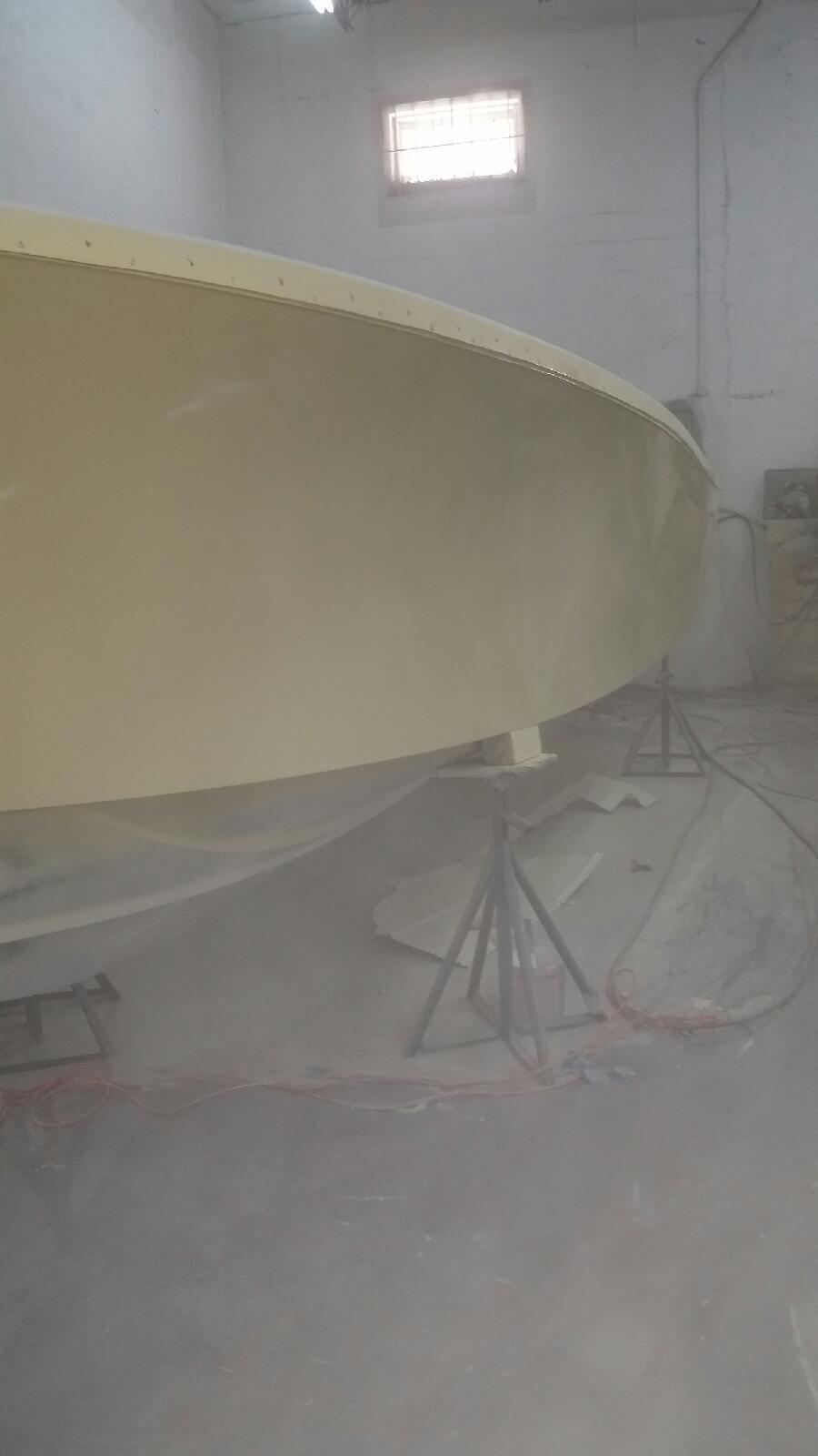

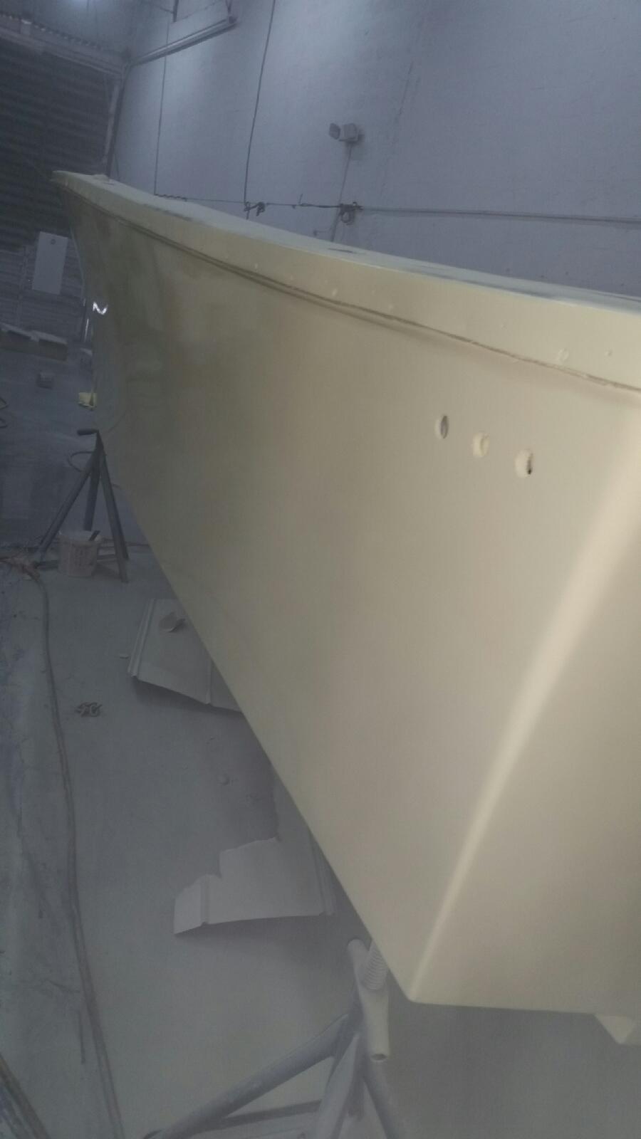

Finally, some Fighting Lady Yellow. Alexseal.

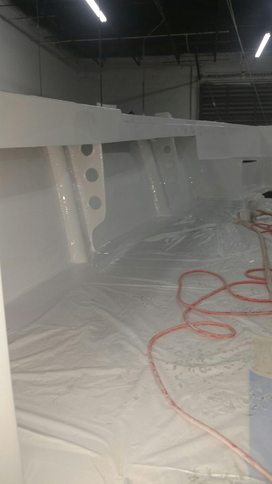

Cloud white, Alexseal Paint sprayed on.

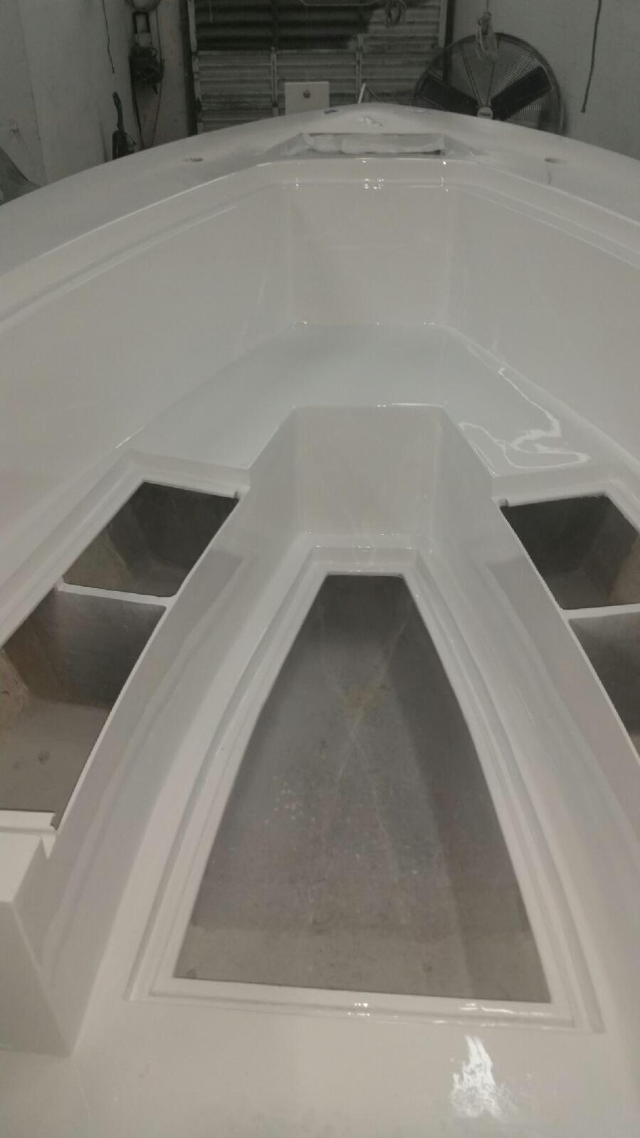

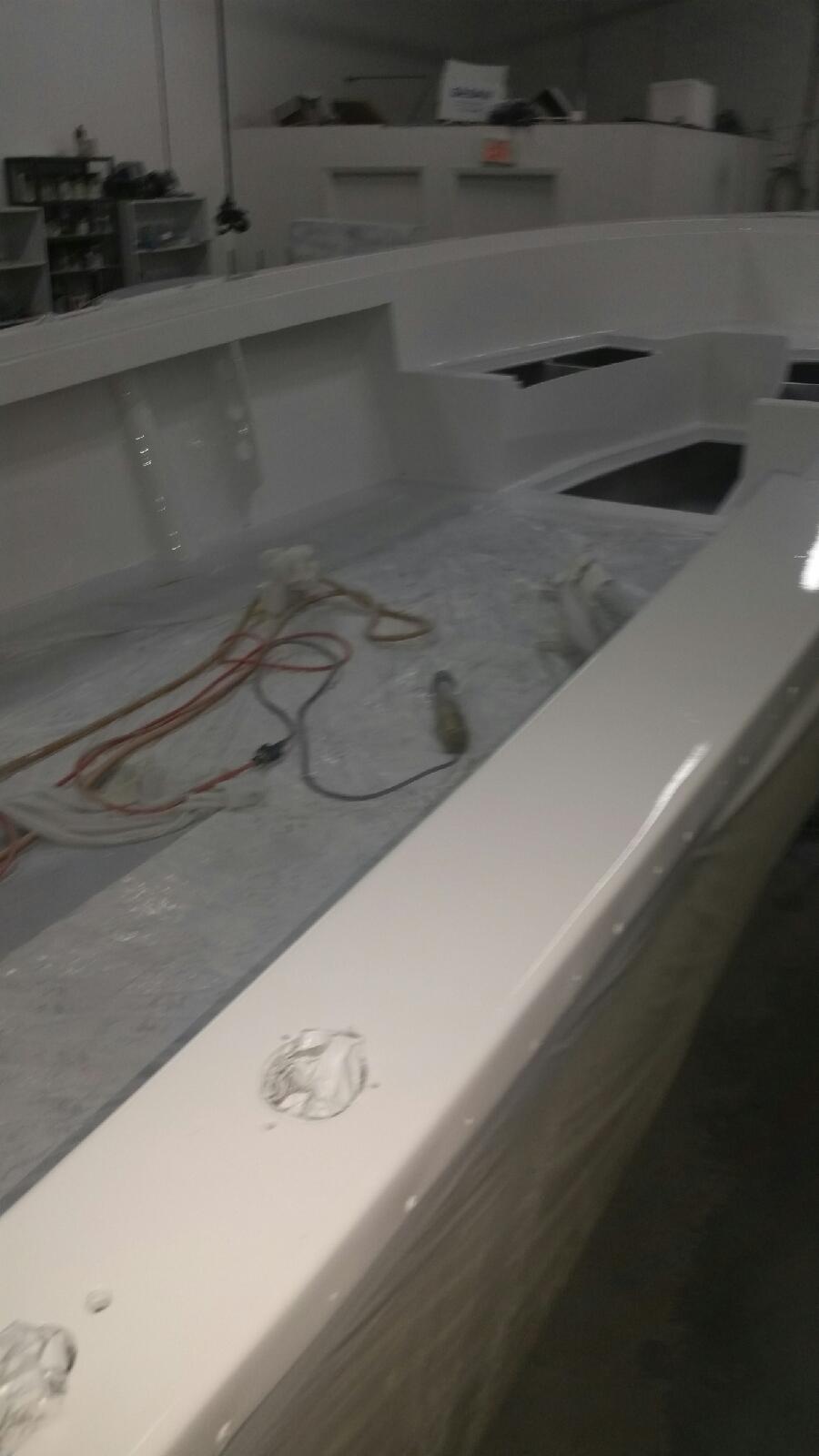

Alexseal fighting lady yellow and Alexseal cloud white interior, white gel coat on the bottom.
