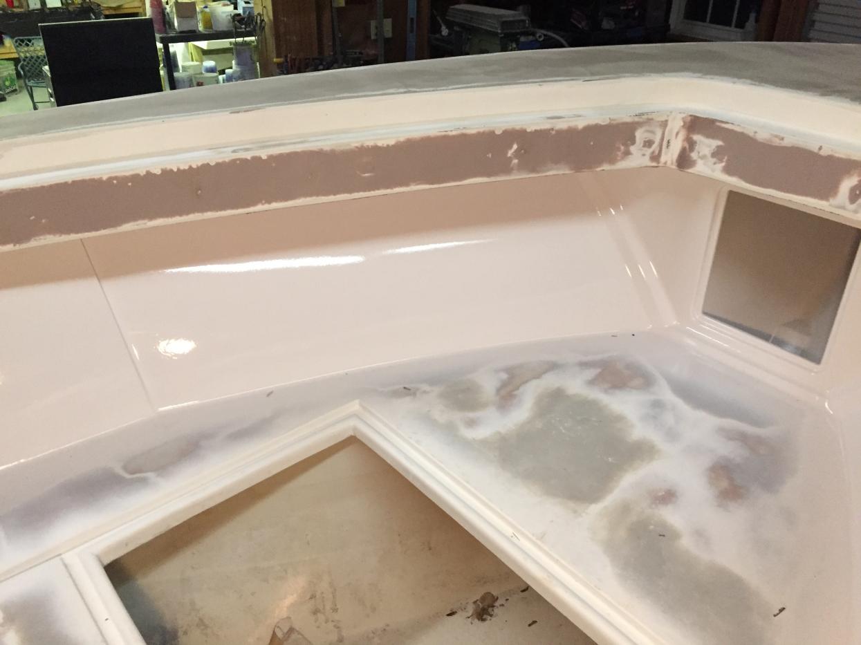

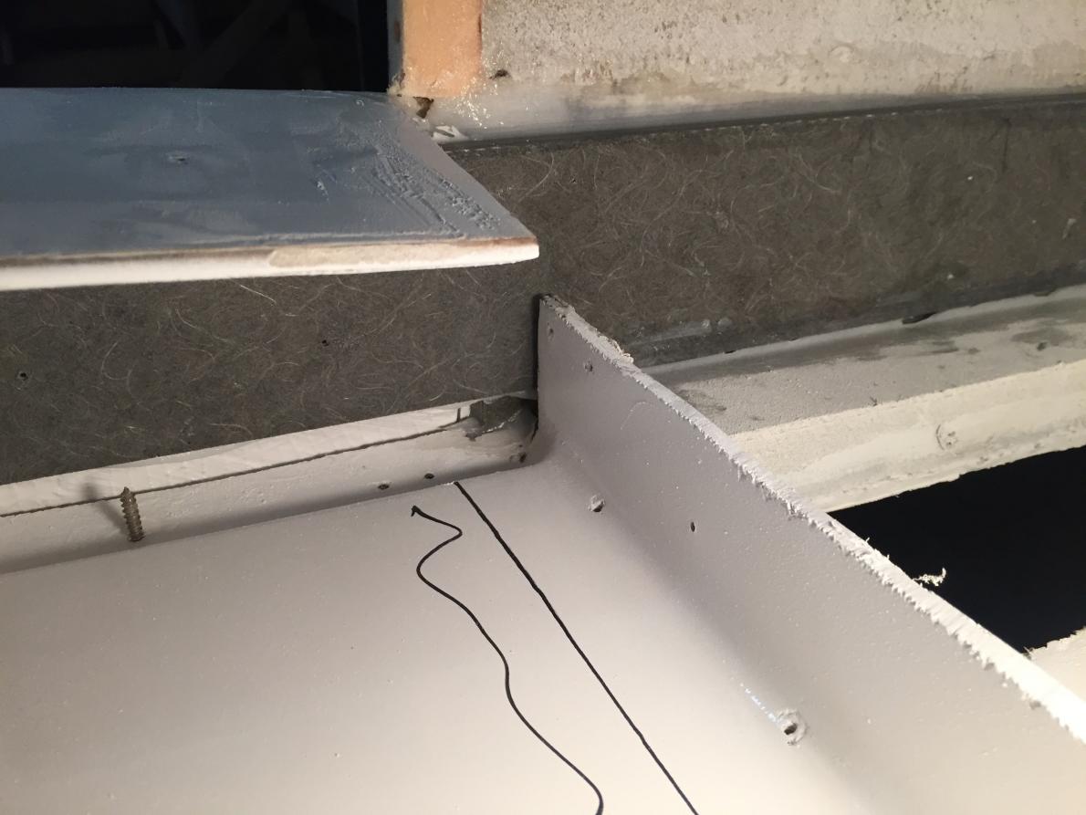

Not much visually, but a lot of work. We put the second layer of glass on the deck, faired, and faired the gutters. After sanding the superbuild we took the first picture.
The second picture is after some more fairing. Nothing spectacular.
Note the Cap. It has a bunch of holes in it. We are going to remove it and make it pretty. There are some places that have some rotten balsa which have to go.

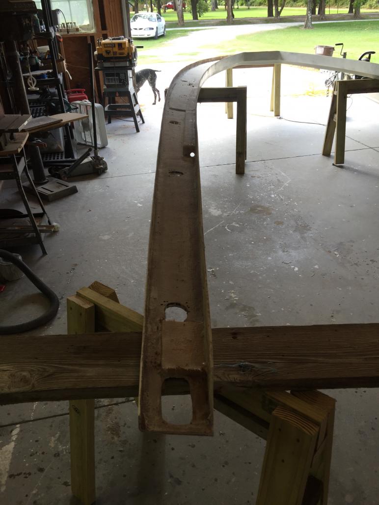

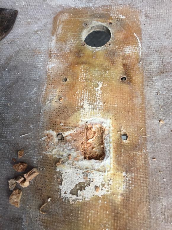

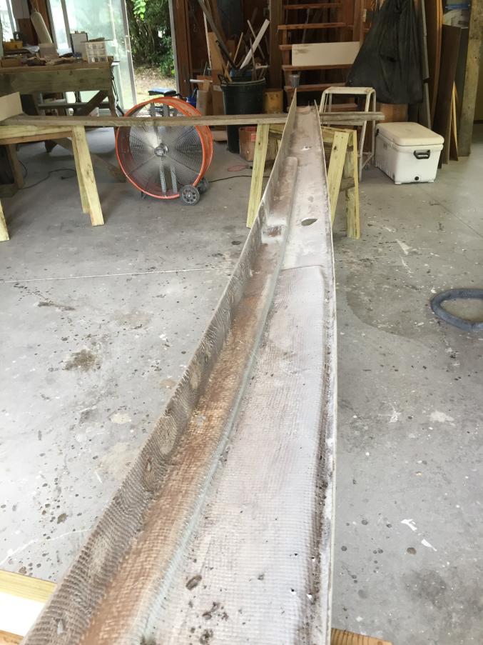

We removed the cap and flipped it over.
The cap had a huge cleat at the bow with a teak block backing. Most of the balsa had rotted in the bow and the rot on the sides was localized by the holes in the cap-naturally. We ground everything out. See first picture-I had a 24 grit disc from the big grinder disintegrate at speed and it went into my knee. I should have bought the variable speed grinder-thats too fast for a disc.
That meant removal of all of the balsa in the second half (stern) of the cap and several areas forward.
To rebuild the cap, we put half inch Coosa 20 in the bow area. We put glass and cabo under then glassed on top (17 oz always). We reinforced the bow areas since we are putting a windless up there. We used foam for small areas of rot that were isolated in the middle of a field of balsa. In the stern areas we used coosa and we filled all holes save on rod holder on each side since I liked that position and wanted to save it. Now we have coosa whereever we want to put a rod holder or cleat. For rod holder backing plates we are using some pieces of 3/16 glass from Parker boats (scrap they give away-useful in some places for backing). I apologize for not getting finished pictures of the upside down position of the cap. Basically we roughed it in, glass, faired and put topcoat on it. Looks very good for underside of a cap. Yes we are anal retentive sometimes.

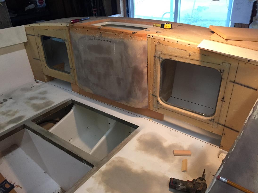

Default Transom and live well

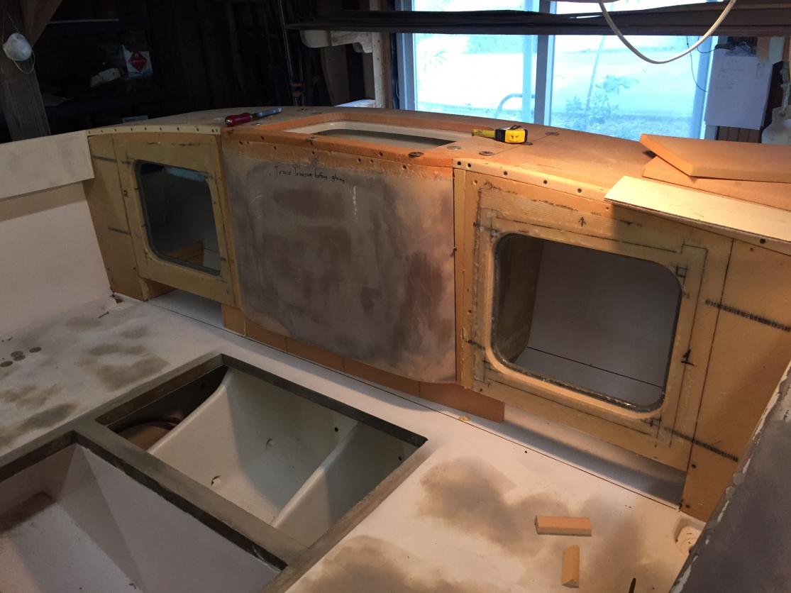

We are dry fitting the transom fascia. This is a very hard part of the build, since so much is going on behind that front wall. Much of which must be done before final glue up of that panel.
Shown in the first three pics are dry fits early on in the construction (before we faired the deck). It should be noted that the liner has a right angle where the old transom made that turn. We saved an inch of that to guide our front panel. It should be noted if anyone is going this in the future, that it is not square to the floor. We made our panel square to the floor. That right angle is a good attachment point so we did save it.

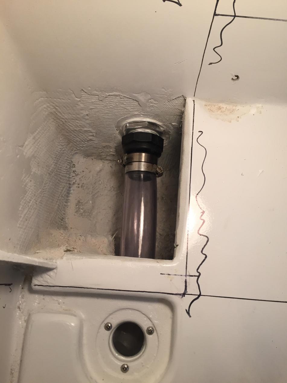

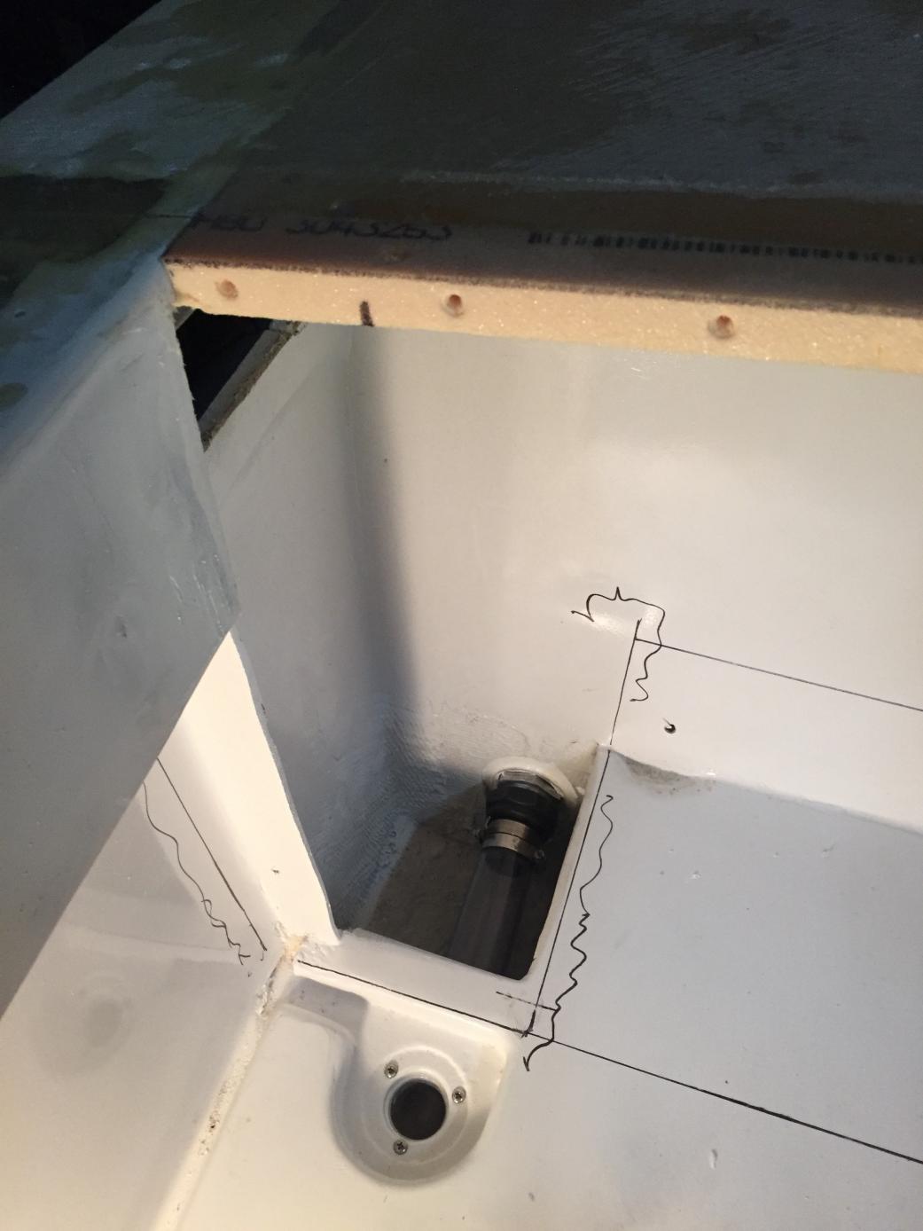

The fourth pic is the port corner showing four holes for thru hulls in the side of the boat. One large baitwell overflow, two aft bilge pumps and a lower one for baitwell draining.
Also note the corners of the transom have access openings (those square holes) where the wiring, fuel lines and saltwater washdown come up. On the starboard side, will be housed the fuel filter and probably the washdown hose.
The fifth and sixth pics show that area. Note the nice Gemlux scupper system. There is a drain cover that is not installed yet. Really slick system-has a duck bill inside to prevent backwash.
The last picture shows where the read of the deck meets the transom. We had to leave little devits where the bracket washers and bolts fit.
I will get additional detail of the panel construction shortly.
