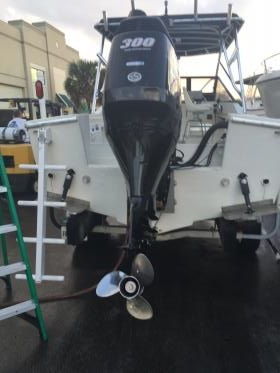

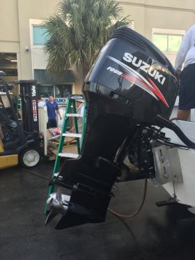

Hardcore...
  #62
Old 01-08-2016, 10:19 PM
More Poppy!
  #63
Old 01-08-2016, 11:18 PM
NOW we're talking......
  #64
Old 01-09-2016, 08:56 AM
Looking good in black! 20" prop? Any top end rpm numbers yet?

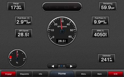

Ok, I'm back home with the new jet engine and all I can say is WOW! I did start with a 20" and saw 42 knots at 5700 lightly loaded. Considering I had a 20" at the house I tried the 18.5 and got 42 knots at 5900. Considering my regular trips run pretty heavy I kept the 18.5 on to see how it goes. I'm not going to get all wrapped up on top speed as the motor will loosen up and I anticipate a few hundred more rpm. The real story is cruise speeds and an overall increase in fuel economy of about 25%+ across the board. Here is a shot with the tide at my back.

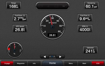

Here's one with the tide in my face.
