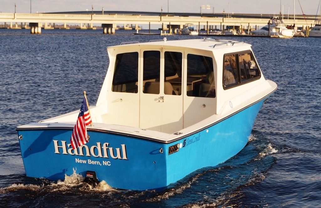

I am about to replace the windshield and soft top on my '77 model with a hard top/enclosure. I am 6'3" and wanted to stand without hitting my head in the '74 model in this thread, but the height of the top messes up the esthetics of a beautiful hull. Since I mostly drive sitting down on the river, which is where the '77 model lives, I really don't need the headroom.
Below is the '77 model with its soft top on the Neuse River in New Bern, NC:

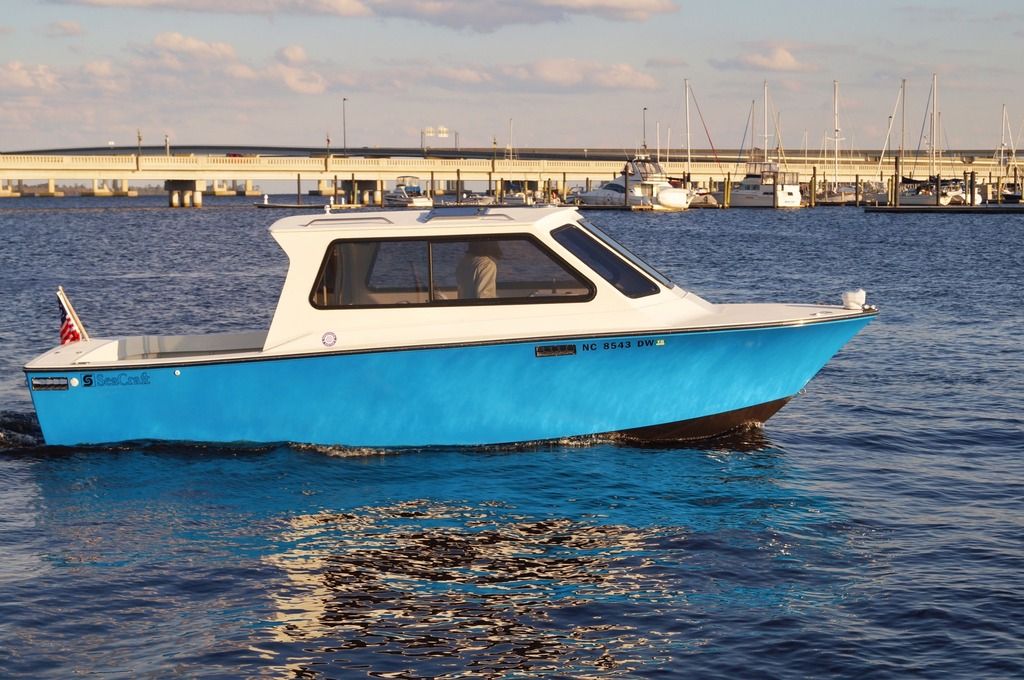

Below is a recent picture of the '74 model on Bogue Sound in Morehead City, NC. Man, do I love that boat! The great feeling I get every time I step aboard make all the time, money, and effort that went into it worthwhile.
I plan to lower the hard top on the '77 hull about 8-10" and remove the side and front overhang. Removing the overhang will allow fabrication from a one piece mould, greatly reducing time and materials. The eventual goal is to make a prefab hard top available as a bolt-on retrofit for others, at reasonable cost. To get an idea of what it would look like, here is an edited image of the proposed design on the '74 hull.

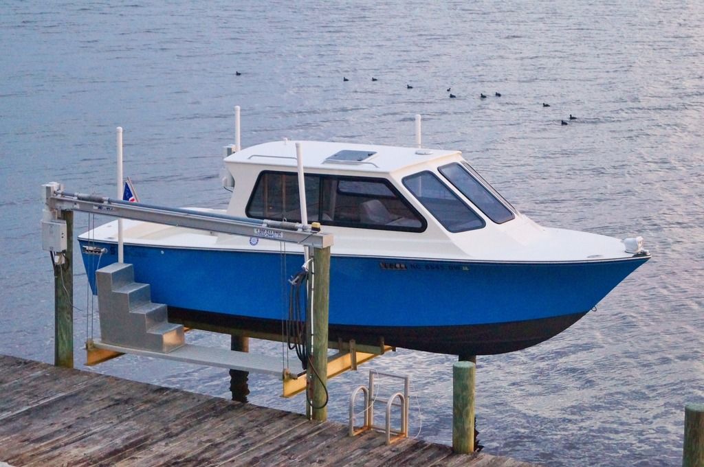

The new top is made from the same mold as the first top, but reduced in height. Interior headroom is about 5' 8". It is much better proportioned than the top on the other boat, in which I could stand up straight (I'm 6'3"). Windows are on order from Wynne Enterprises.

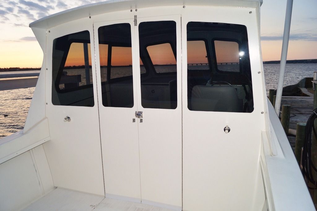

And here are the roughed-in rear windows. I used 1/2" pvc board, which was MUCH cheaper ($100 for a 4X8 sheet) than Starboard, and also easier to work with. It can be glued, screwed, patched, and painted. In this situation, strength isn't really an issue.

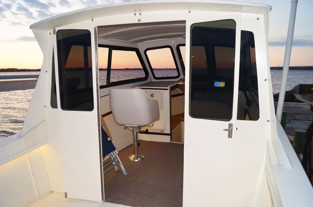

Winter project finished on the '77 Sceptre!!! Canvas enclosure replaced with a cabin. Interior head room is 5' 8". (The '74 was 6' 4" - great for standing but too tall esthetically. I think this one looks LOTS better.)
I can stand up in the open hatch - great when you need direct vision. The hatch is also a very convenient vent.
The cabin doors are 1/2" PVC board - so much better than starboard. (You can glue, screw, paint, and repair it, and it's a lot cheaper.)
