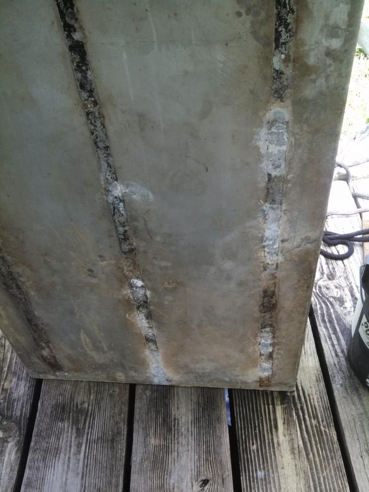

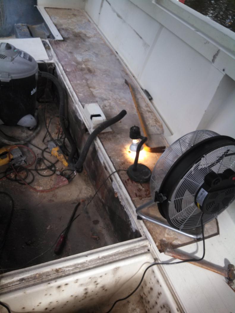

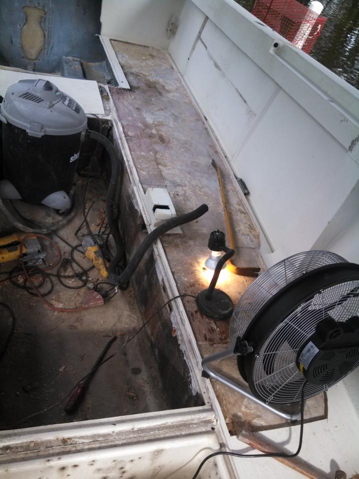

Well I knew there were some bad spots around the t top legs so I decided to tear the top skin off and replace with foam core.. this is were I am at now.. I removed the tank and found some bad spots will weld them up as that is all about five little spots about 1.00" around... I am debating on removing forward box and moving tank far forward.

I will a agree a twisted wire cup brush on a grinder made the balsa core
come right off

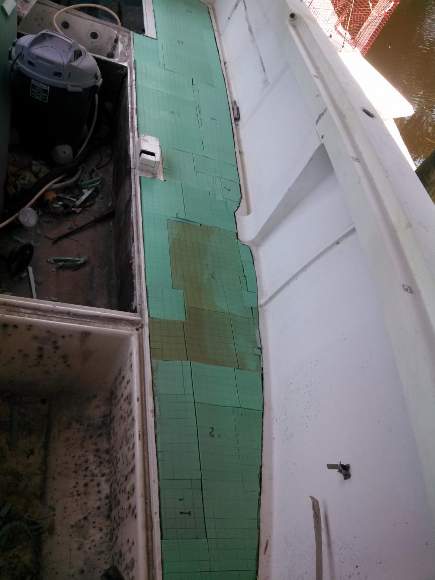

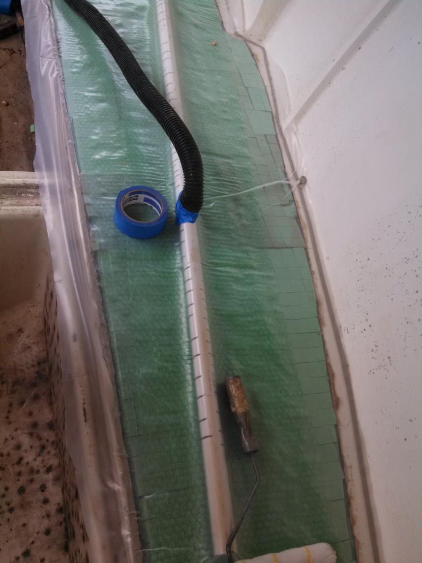

Here is the rest of the glass skin pulled and played new scale of 1708 down then I vaxumm baggws yje foam down. My vac pump died while glassing so I had to improvise...

Here is the foam

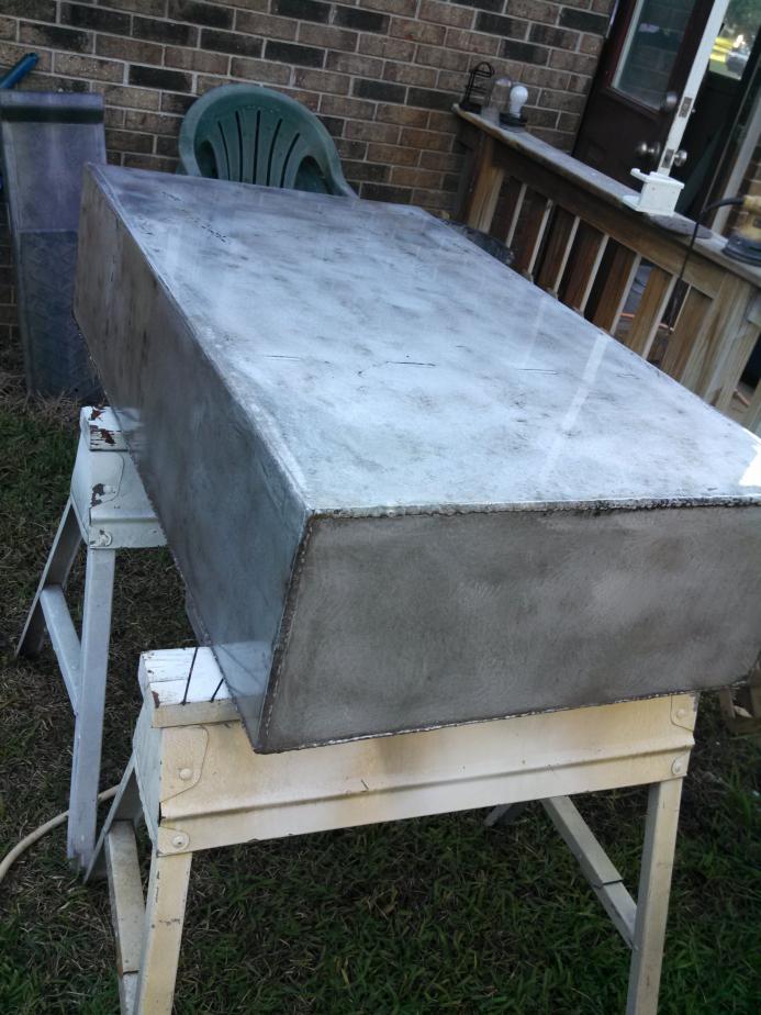

Finally have fuel tanks blasted and coated with 5811 belzona immersion grade.. I first sanded with 40 grit and cleaned with ppg alum cleaner.. Then i white blasted all the seems and hard to reach areas.. Cleaned again. Let dry then coated with belzona... 3 coats on bottom. And three coats on top then 2 coats on sides.. Also finished coating alum transom bracket supports.. Once installed i can finish up the floor cause theses brackets bolt to the deck as well..

tank before and after

this stuff is very good at keeping corrosion to a min. I have used this in some of the most corrosive environments. Such as Large heat exchanger plates for Gulf power electric. and For all wastewater applications for coating of wastewater pumps. the pumps are cast steel and this stuff really protects these pumps from corrosion. Belzona can be used for concrete, steel and Alum..Oh and as far as elongation for expansion and contraction. It is excellent..
