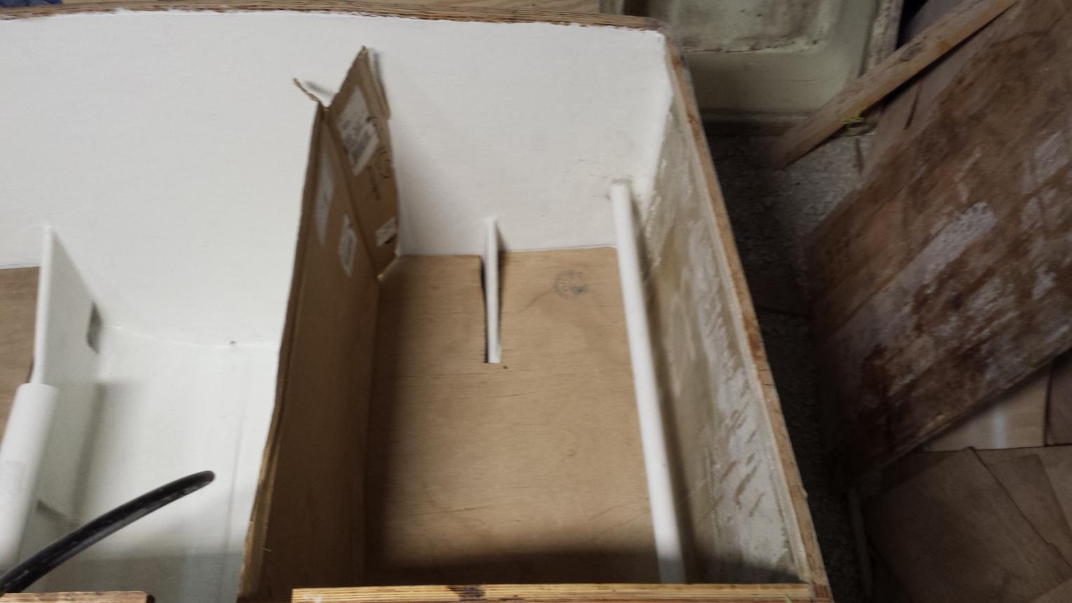

Front deck glassed.

Glassed some pieces for the gunnels to fasten to.
Gonna end up keeping the rear two storage compartments simple. Was gonna do the whole mold for some boxes to be glassed to bottom of deck and all, but now we decided to put a floor in straight across the stringers and glass 1/2" plywood vertically to close the box in and also help support the back deck. The port side will get about 2" of foam glued inside the box then glassed over to make a good size cooler/fishbox. The compartments measure 39"L x 24"W x 23"H. Plus it will give us easy access to the thru hulls for bilge pumps, trim tab hoses, and the scupper tubes.

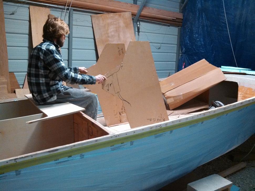

Cut and fit 2" foam in the port rear deck hatch for cooler/fishbox.
Played around with some cardboard, shaping the console.
