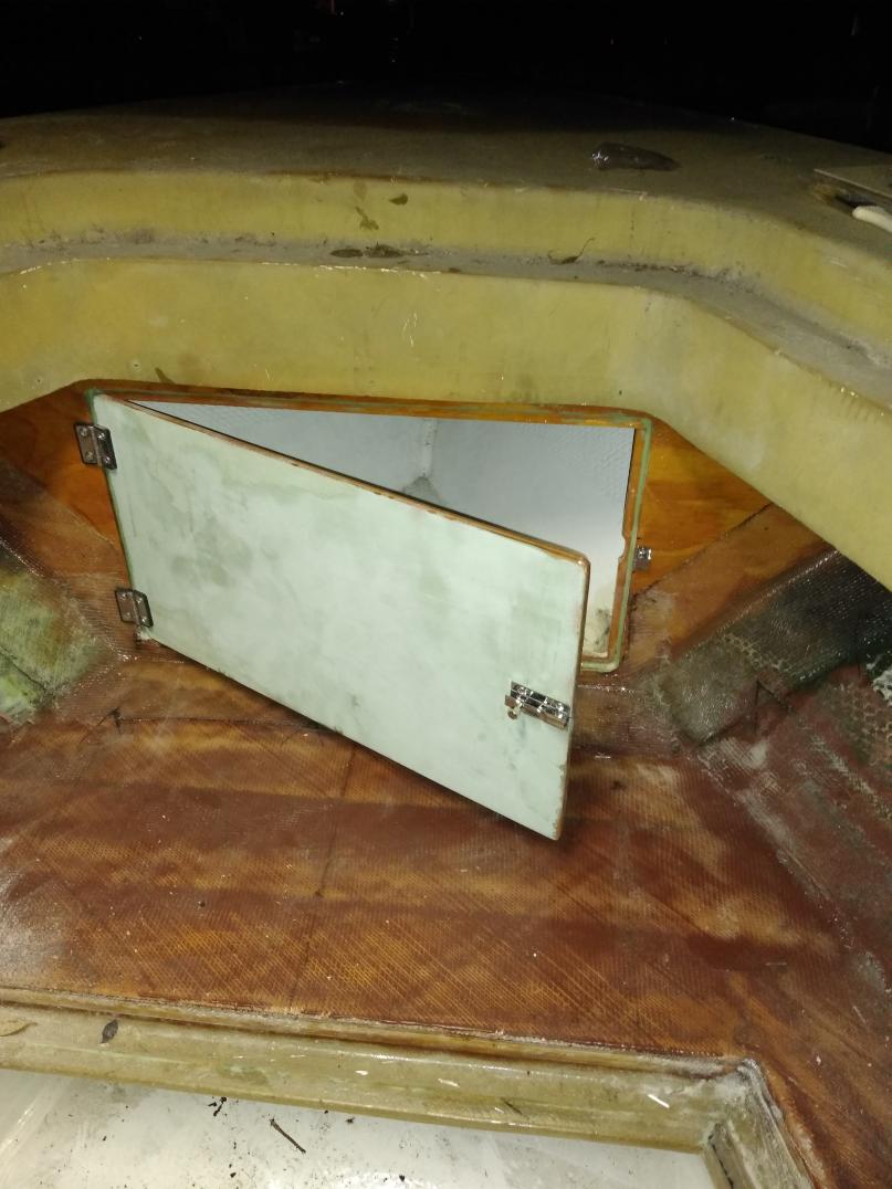

Got the casting deck glassed and rough faired, anchor locker faired and bilgekoted, bulkhead tabbed and door test fitted.

Making headway Leland!!! Remember buy sandpaper in bulk!!

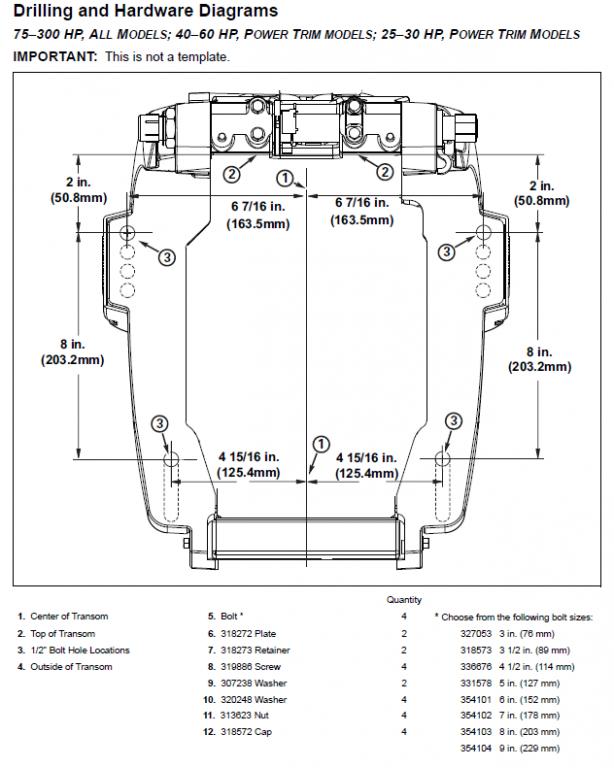

Anyone have an unmolested MA with a 20" transom. I cannot find my measurements for the original mounting heig]ht for outboard bolts. I need the distance between the arrows.

Yes. But I can't see your picture very well. What do you need?

Top of transom measured straight down to the upper motor mounting bolts?

Leland, Google "engine mounting template". 2" seems to be the number.

I found this here:
http://www.bbcboards.net/showthread.php?t=819368
Does this help?

Thanks guys.
