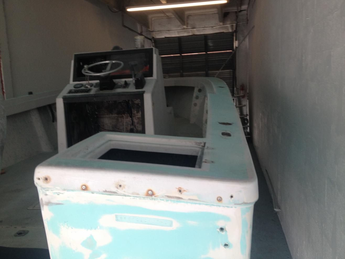

Even though the boat's not completely done, I had to compare the before and after paint job.

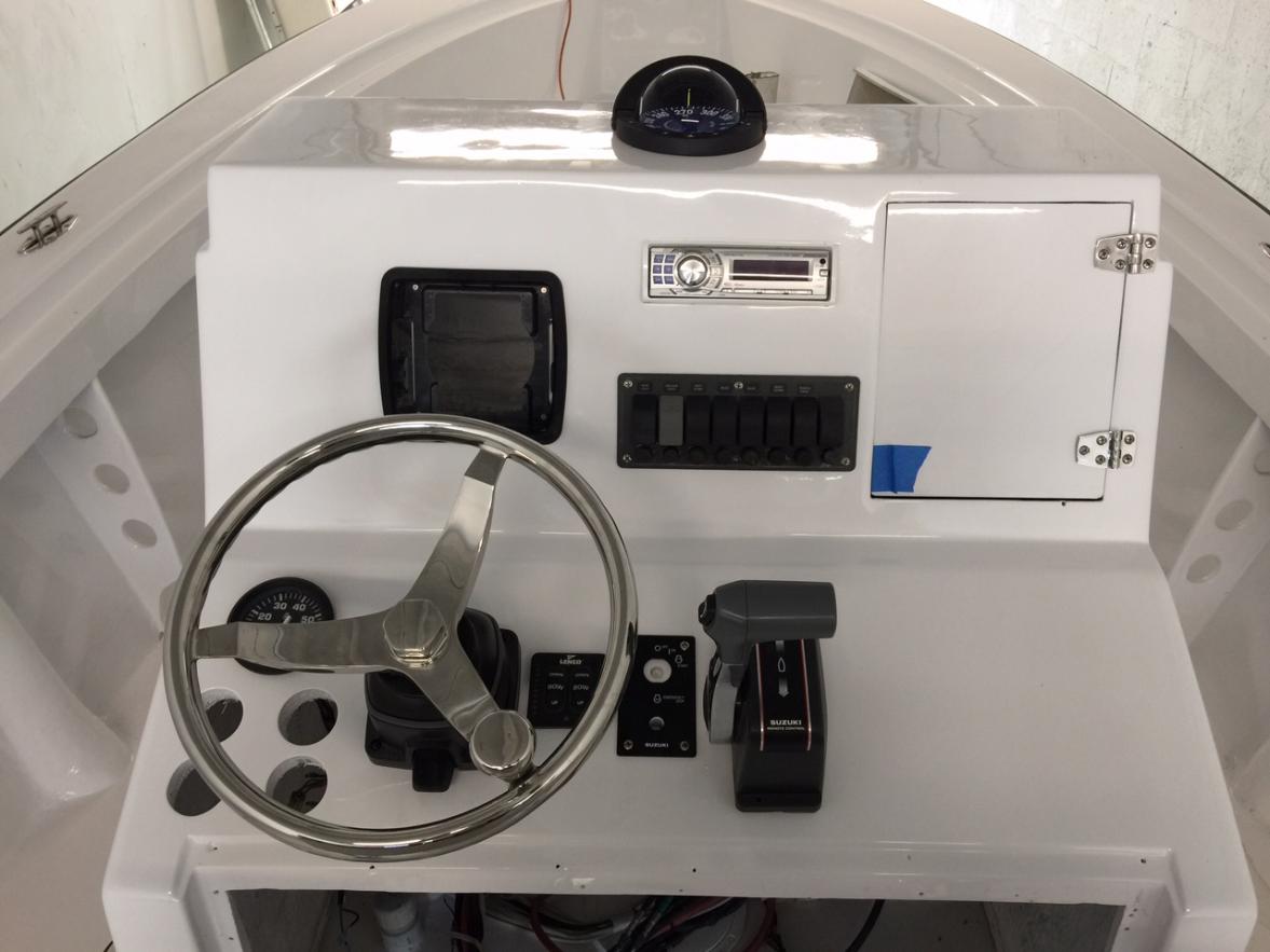

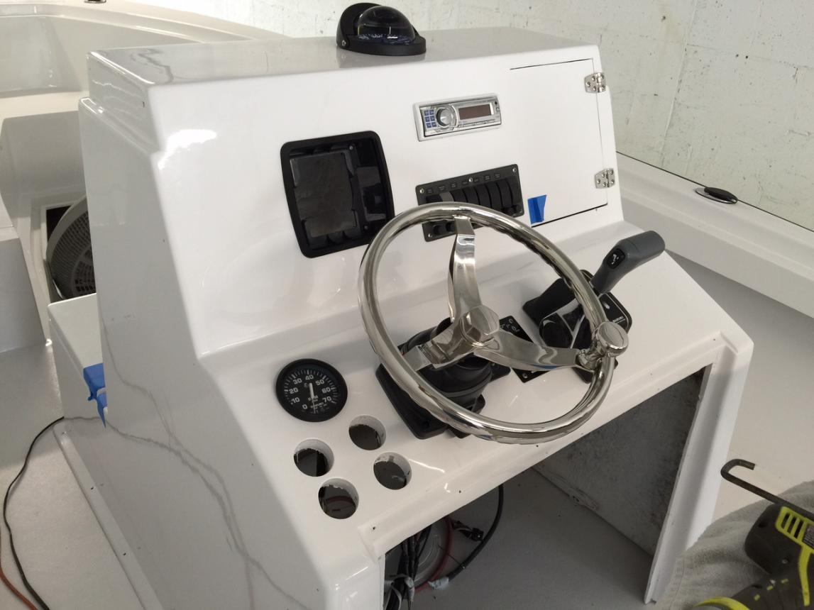

Posts: 96
Got the Center Console back in the boat with new paint, new compass and new steering wheel. Moved anchor locker hinges to the side. The crooked bow light hole still driving me crazy every time I see it, it's still on the list. Replaced pull-up cleats with pop-up cleats and added some shiny new hinges at the stern.

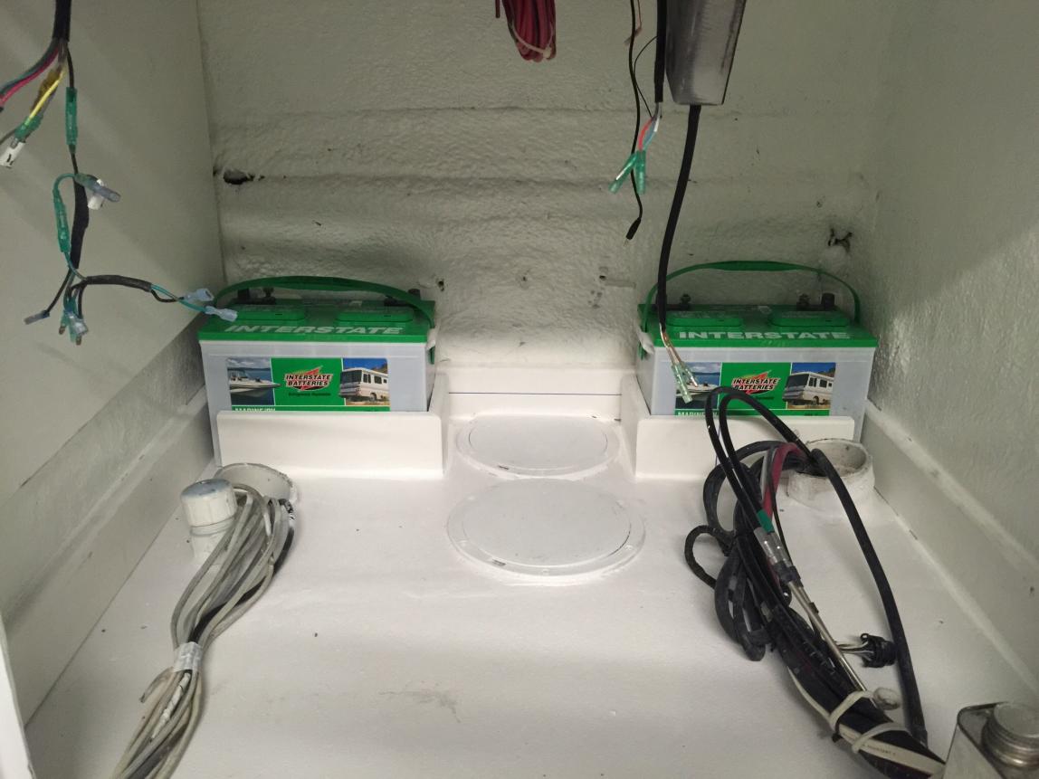

Posts: 96
Inside of center console gel coated, battery holders installed. And plywood (painted white) on port side of center console so amps can be mounted without screwing through the outside of the freshly painted center console.

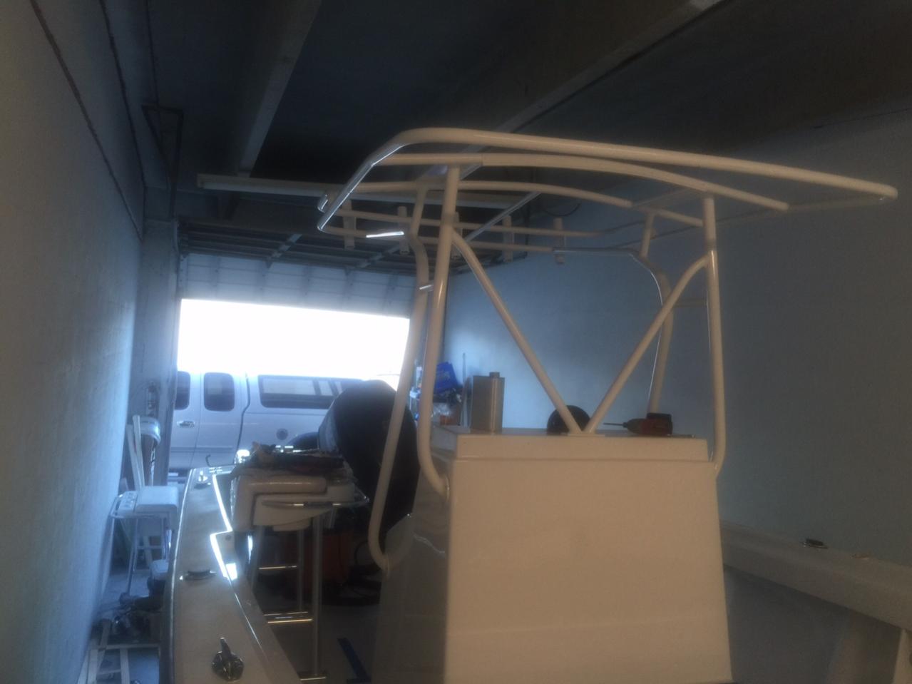

Posts: 96
Powder coated T-Top and subwoofer installed.
