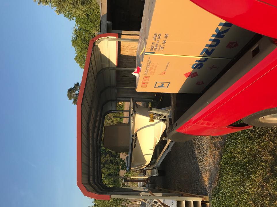

OK, so I now have everything I need to get her going. Picked up the motor last Thursday, mounted it Friday only to confirm I needed the wiring harness adapter to connect my old gauge to the new motor. My dealer ordered it Friday and I picked it up last night. I will get everything connected to the motor and then will be ready to go for a ride this evening...I hope! Wish me luck.

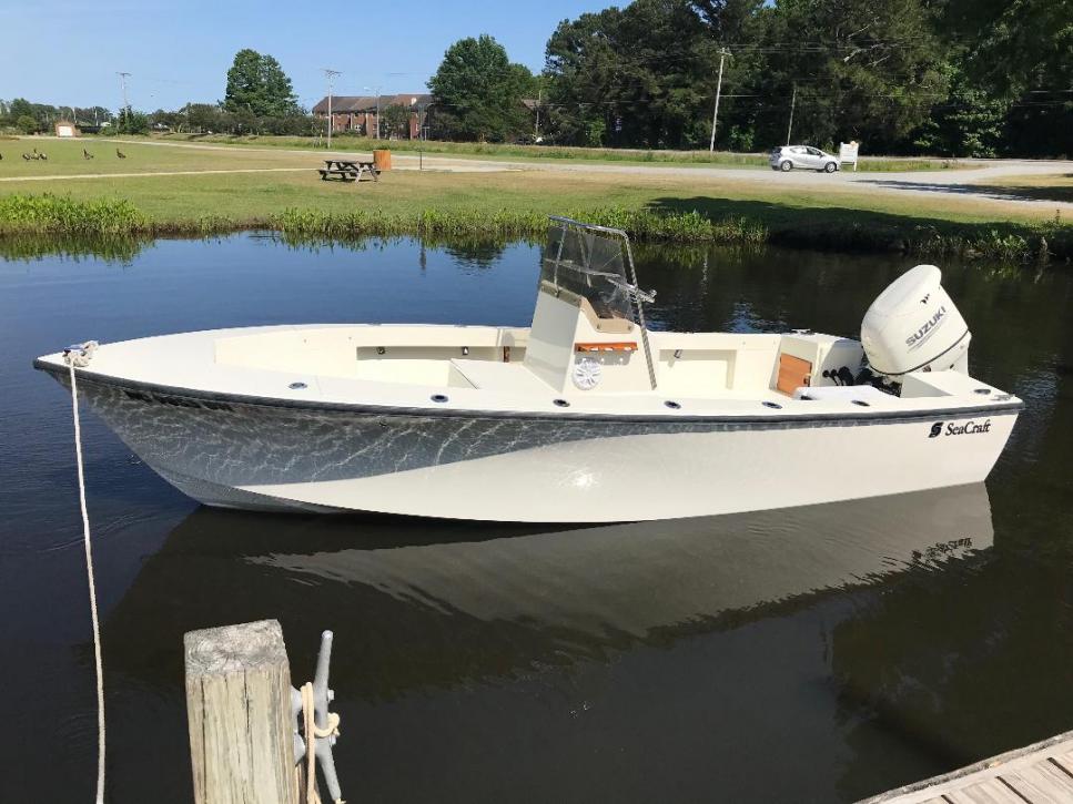

The prop I'm running is the same one from before, 13-1/4 x 21P ss. I have to log in another 5 hours and I'll be ready to go.
http://www.classicseacraft.com/commu...1&d=1559246046
Looks sweet and performs sweeter!

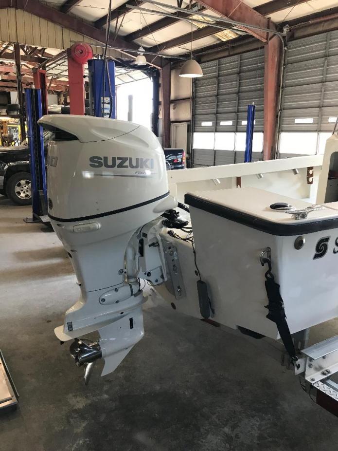

Nice Martin! Is that a manual jack plate?
Michael.
  #88
Old 05-31-2019, 10:03 AM
Michael.
Yes.
Another pic. Can't wait to get her wet again!
http://www.classicseacraft.com/commu...1&d=1559311334
