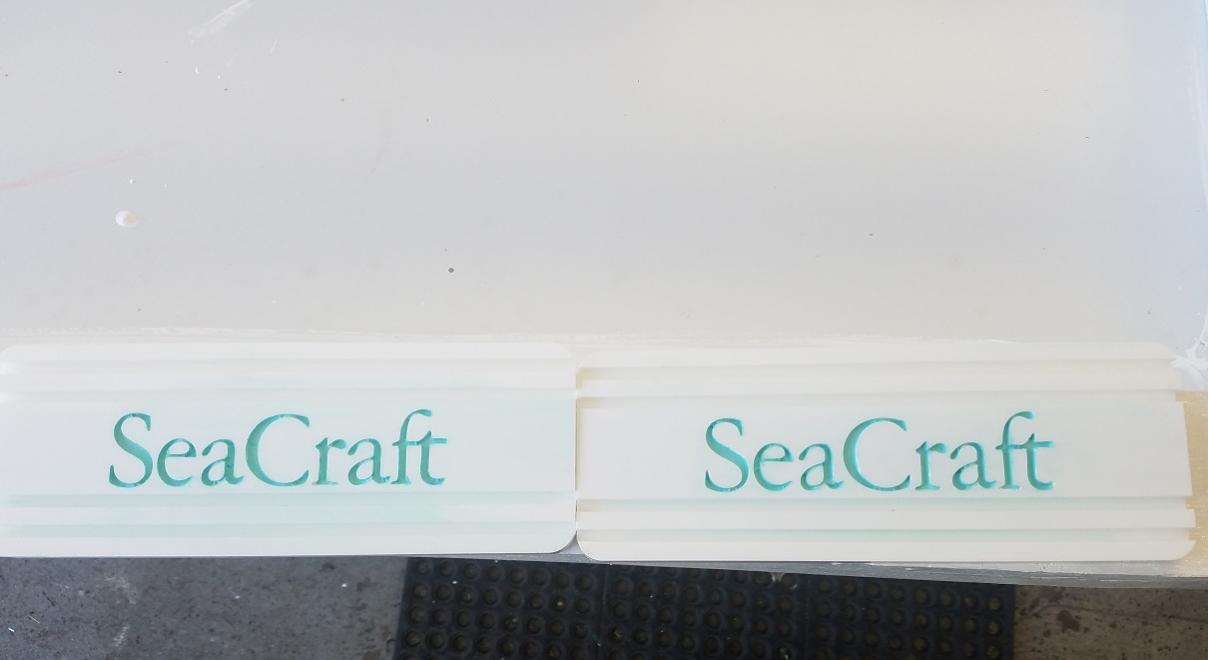

Made some custom starboard step pads for the cap.

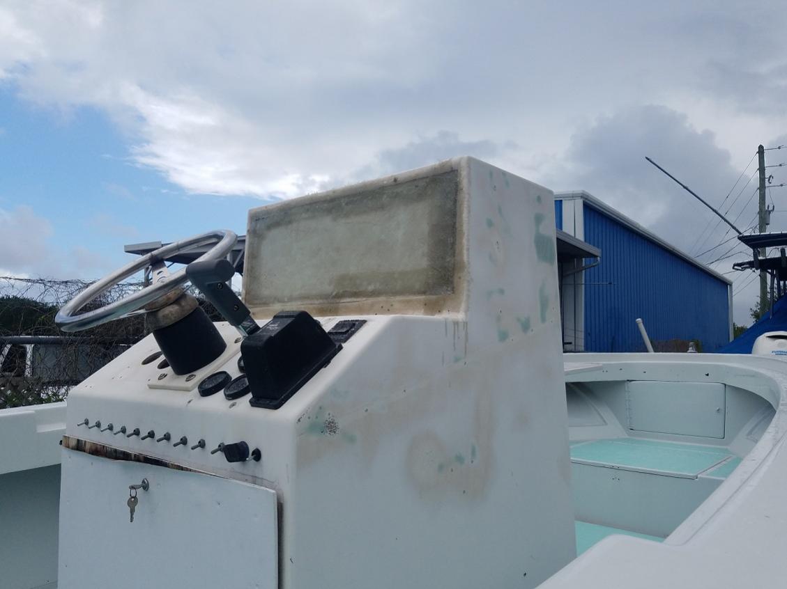

Posts: 318

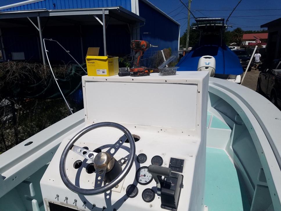

Finally got back on her yesterday and this morning. Filled a bunch of screw holes in the console and then started to work on making the plug for the old access doors on the top of the console. I plan on flush mounting the gps/fishfinder, vhf, and stereo for a more modern look.

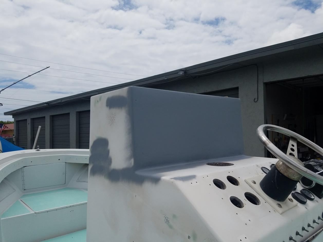

Posts: 318

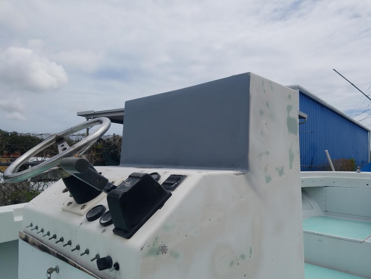

Finished off the fiberglass, faired it in, and gave it a quick shot of primer to reveal low spots. All out of fairing material so calling it a day.

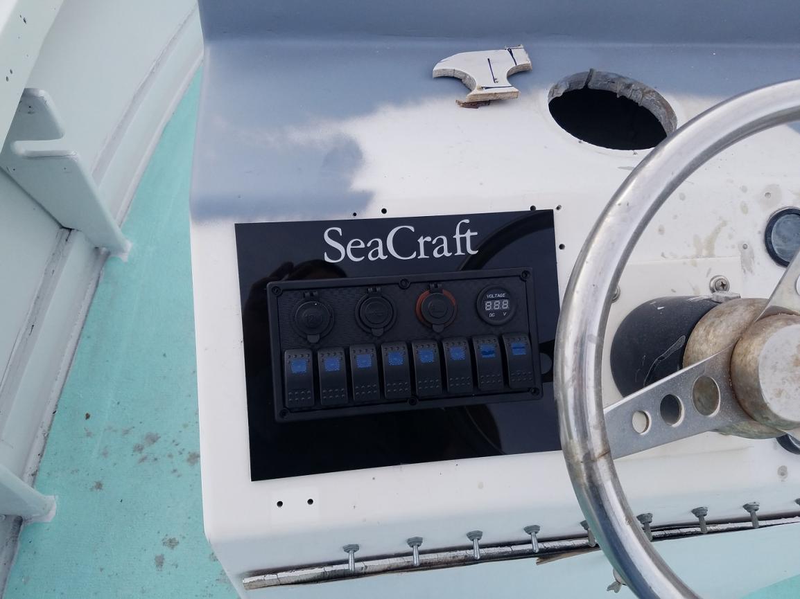

Posts: 318
made a nice little placard to hold the new switch panel. Hope to paint the console early next week and then start the actual rewiring process

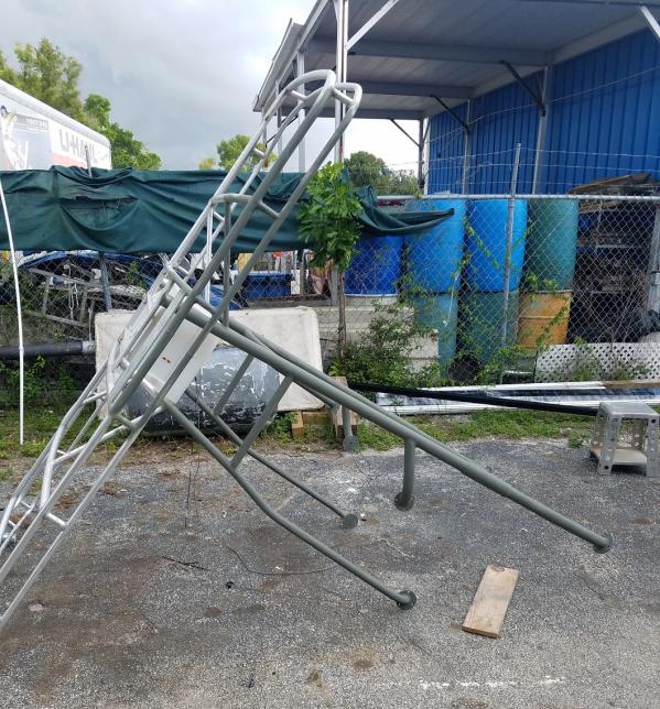

Took a couple of weeks off from working on her to house hunt with my wife plus the rains did not cooperate.
Neighbor finished raising the legs on the t-top 4 inches for me. Now starting to sand and spray with self-etching primer to get it ready to paint.

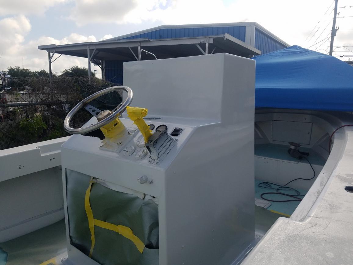

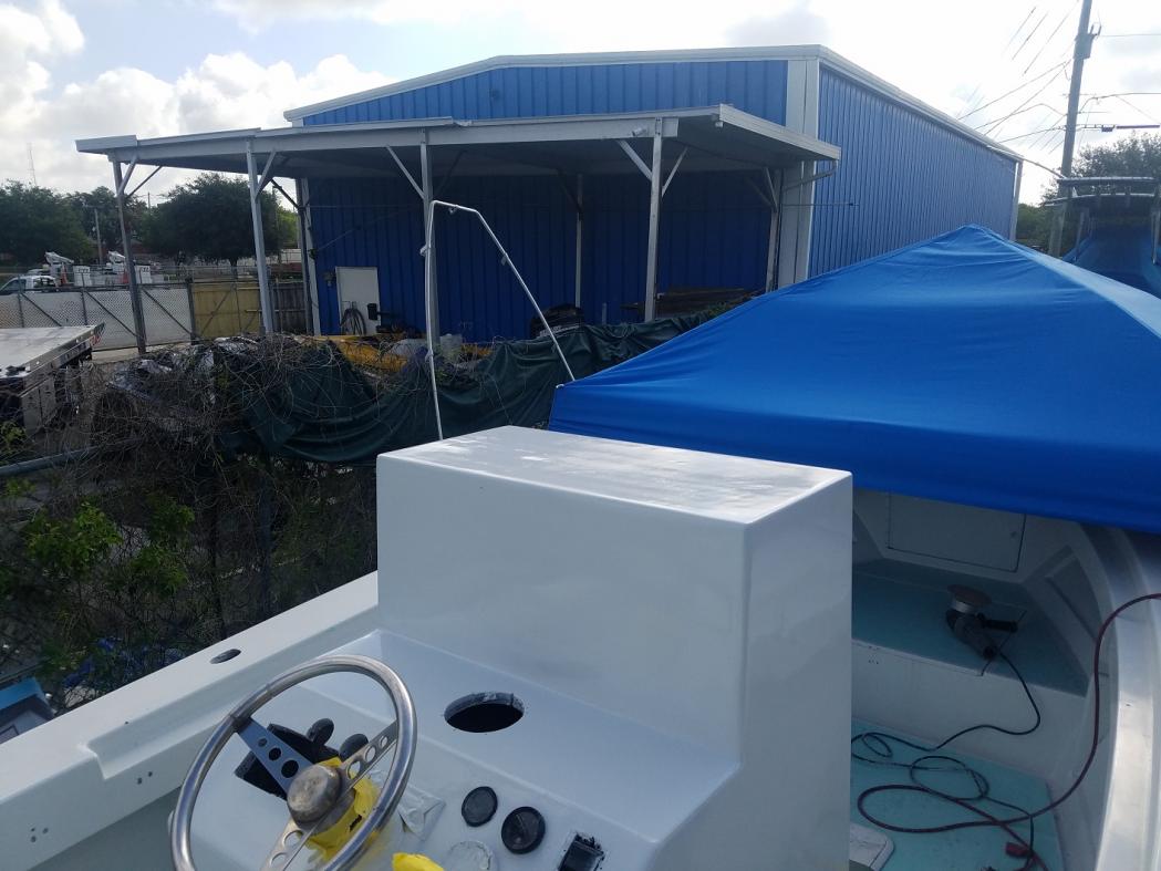

Posts: 318
Worked on the console yesterday and got it ready for paint. Got up early this morning and got it done before it got too hot to allow the paint to flow.
