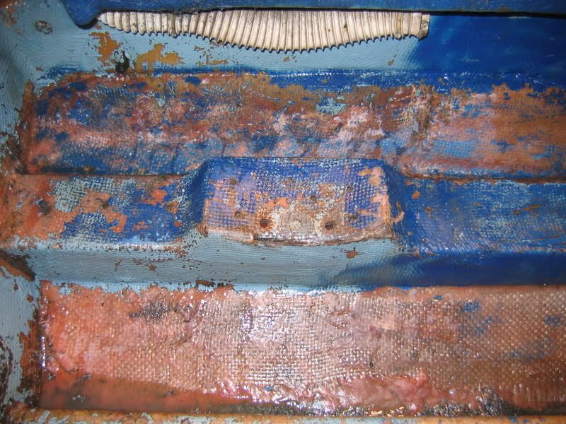

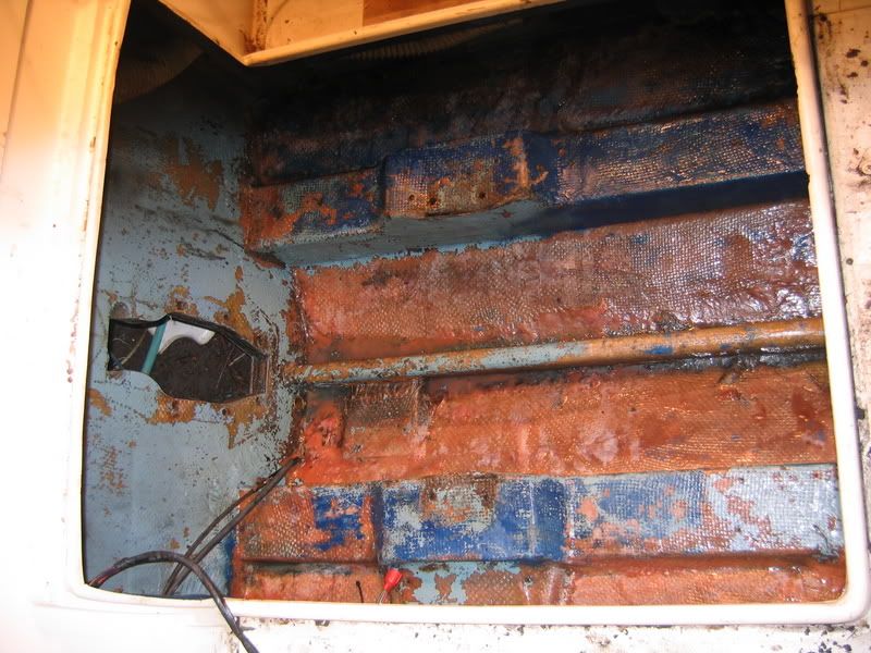

I'm getting ready to do a transom replacement on my recently purchased 1974 Tsunami I.O,and have a few questions.
Asyou can see from the pictures,the short box stringers that the engine was mounted to,need to be rebuilt.The original mounts in the picture had a raised portion where the front engine mounts were fastened.
Should i make the new ones the same,or should i make them flat across the top for their whole length?.
The original engine was a 351 Ford,but i will be replacing it with a 5.7 350 GM.I figure that it might be better to make them flat across the top,and raise them if necessary when i get ready to install the new engine.
I'm also going to do the transom from the inside,i know that it's more work than from the outside,but i think it makes for a neater and more secure repair,and it doesn't compromise the integrity of the hull.
Any comments or help would be much appreciated.
The pictures in order are
(1)bilge area before cleaning
(2)bilge area after cleaning
(3)Raised motor mount area,showing the deterioted glass and substrate.
Should i make the new ones flat across the top,and are any measurements available for Mercruiser engine and outdrive placements,such as location of transom cutout in relation to engine height or placement

I dropped a 350MAG MPI FWC/ Bravo I in a sailfish (really sportcraft) back in March....
Installation diagrams with measurements are on the Mercury web site....there's also some on the installation CD. The sportcraft had pretty high stringers with aluminum angle plates through bolted on the insides. I think if you stick with the raised areas you will have somewhat better access under the engine. Not that you need to get there much, but sometimes you do....that's my $.02

John,
That is a good question. I agree with the other post about access below. More importantly, on my set up, it had to be lower at the transom because the Y pipes, or part of the transom housing would have had an interference problem. That transom of yours looks to be in pretty good condition. It could be a bear to pull that out.
FYI, I just raised the whole deck cap to get at the transom, without having to cut anything. Not the best working conditions, but kept me from having to patch the inside back up.
Jim
