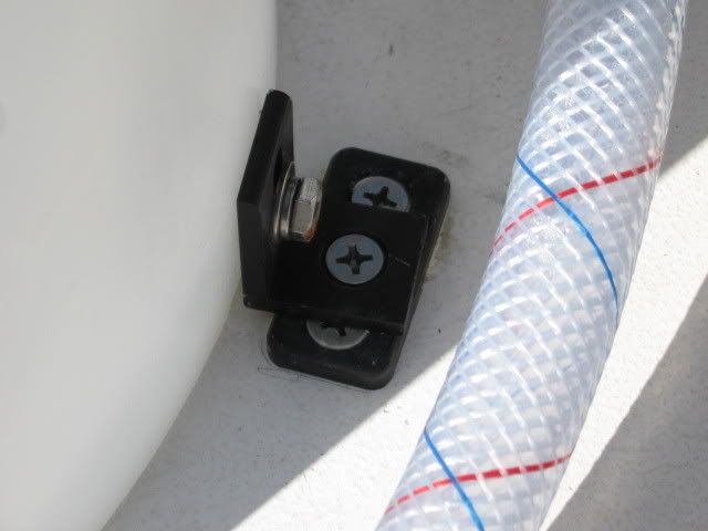

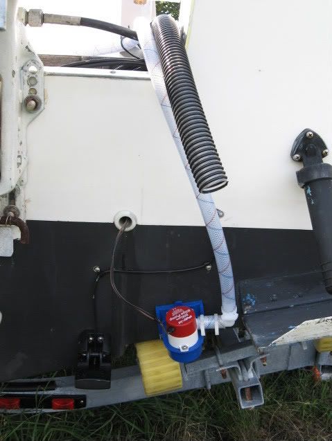

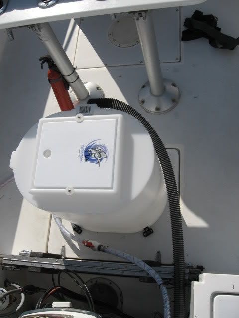

Possibly someone might like to see this option on my '18. 22 Gal Kodiak with 500 gph pump. Easy to set up and remove, only 4 bolts,slide on pump and plug in wires.Cost $316.16 delivered.

Rhody's set up is identical to mine (right on, Rhody). Except his is much cleaner - can't even see thru my hose... Wire the pump just like a switched bilge pump (effectively, it is a bilge pump), turn on and it sucks water. Fills to overflow level, and drains out over the transom well. 3/4" hose in, 1-1/2" out. No check valve needed. Only thing I don't like is the extra 180 pounds of plastic and H2O aft.
West marine wants $85 for Rule/Kodiak 500gph transom mount. C.G. Edwards in Boston has 'em for $56 online...

Because the pump is always in or on the water it does not need a primer.
There is no check valve but I installed a ball shutoff valve in the intake hose to keep tank full if I choose to shut off the pump. A check valve would do the same and might be an improvement.
There is one intake (3/4"?) and one overflow (1 1/2?) both over the motor well. A third hose seen at the forward bottom of the tank is to empty the tank and send the water to the port scupper.
