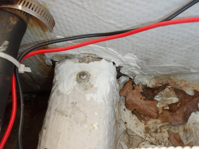

The crack looks much bigger than it actually is since its a closeup, but I agree that its not good. I haven't checked her for moisture yet, prolly should. I have a 98 140hp Mariner 2 Stroke on the back of her, not sure of the weight. Doesn't seem like it should be too heavy considering some of you guys are hanging 175's on them. The entire hull is original...deck, transom, console, etc. Here is a pick of the stringer from that same side (port). Looks like its detaching as well? Also looks like someone tried to repair it by filling it....

Mitch, it's not even a question. You really need to do the transom.

Looks and sounds like a "might as well" project to me!
