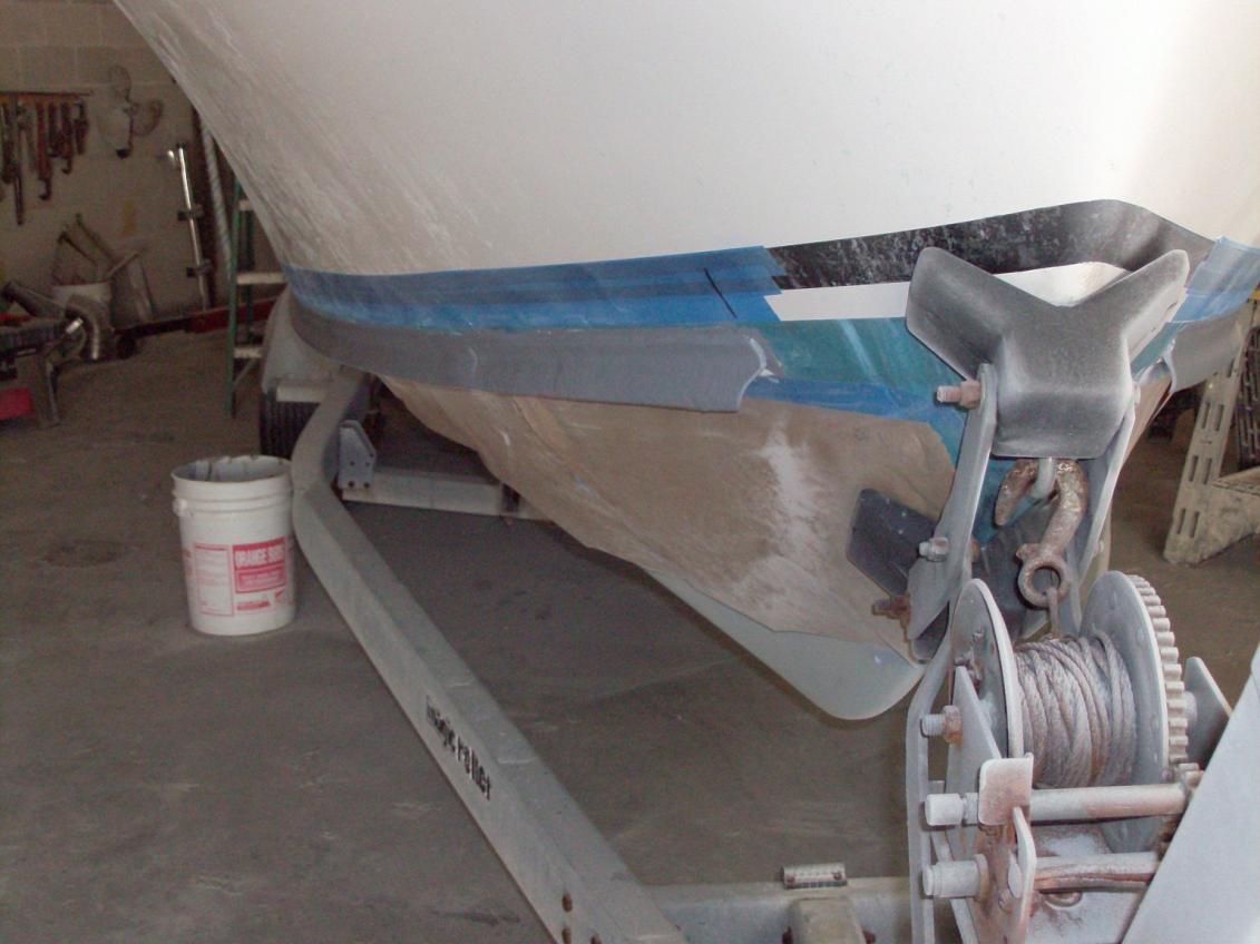

these are spray rails,i made a mold to produce these a few years ago - these are a great addition - these will definatley keep you dry.i laminate these to the hull - no cheap tape,glue,or screws - these are made integral with the hull - virtually unbreakable
my rig's inside the shop - it will be wearing a set of these next year...

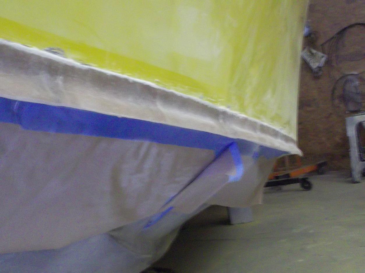

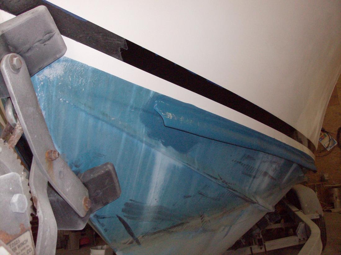

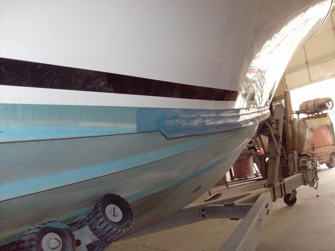

this is what they look like on my sea craft...they're faired in,and primed - i'm thinkin' about squirting the boat,not sure what color yet...
