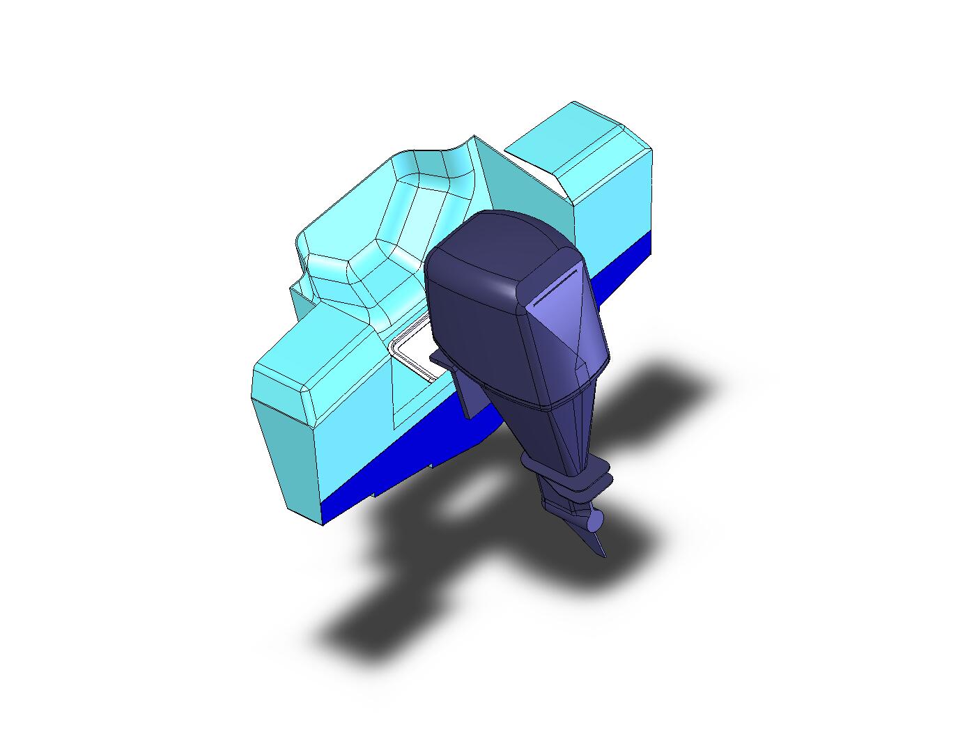

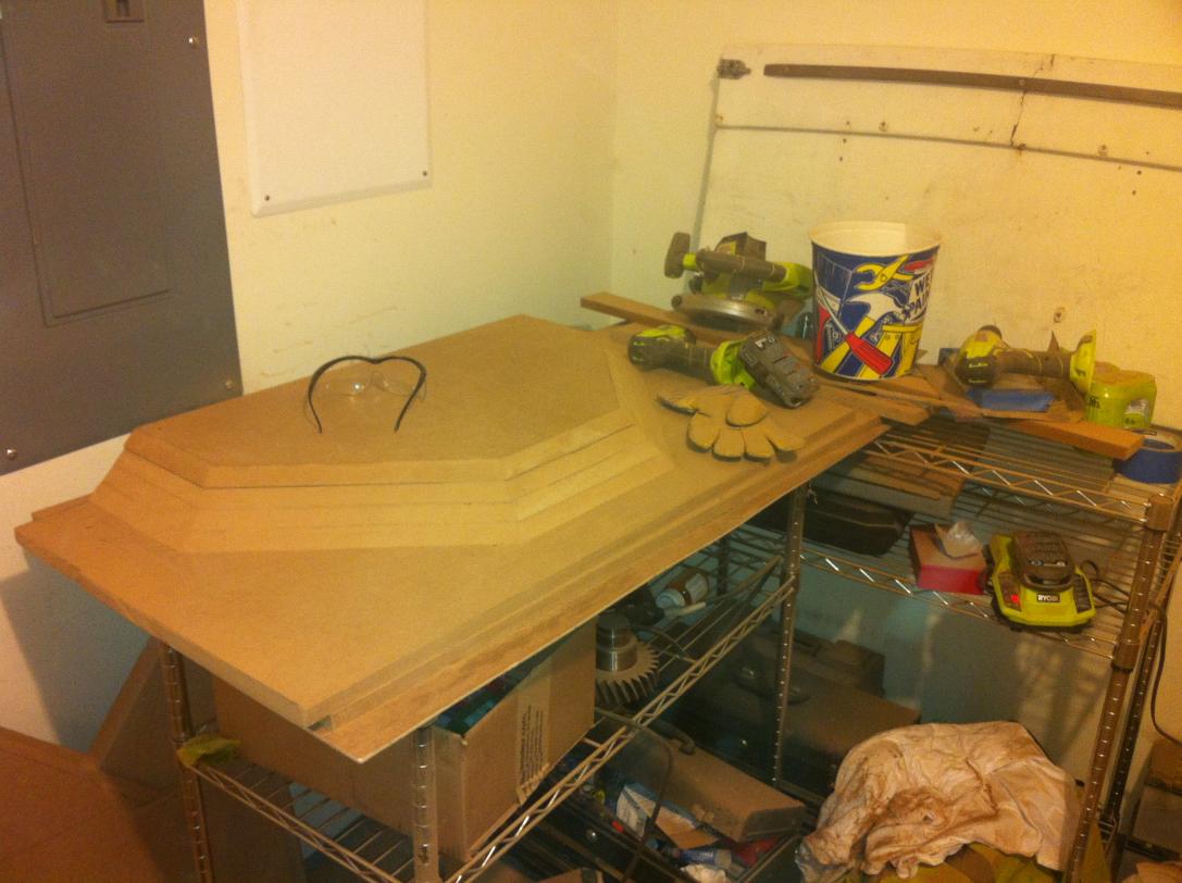

The plug is started. It is solid, as I am thinking of vacuum bagging the plug and mold, just to keep the mess down, plus I can sand the radii into it with a long board before I attach the "bump out" to the door. Plus I don't have a nice table saw for compound joinery. I am more of a CNC mill guy than a Delta table saw guy.
I haven't done parts from scratch in a while- I am working in the corner of my garage for now until it gets too big.
I will post the CAD screenshot of the tilted motor showing where the motor interferes. It looks like 8" is what I need with an in-line 4 cylinder 4 stroke like my Yamaha. Maybe Jorgeinmiami can take a tape measure to his to check clearance. I think he has a tower of power on his 20' MA.
Two things I noticed:
I haven't worked extensively with MDF before. Wow, is it dusty. I am using my paint respirator with the pink N95 "bodyman" filters.
Cordless power tools have come a long way with lithium-ion. I bought a Ryobi 18V combo package, and the circular saw has paid for itself already.

Ah fishST . . . have you considered adding a 9" jackplate and seal the edges of the splashwell gate permanently? That should give you the room to get full tilt range without having to fold down the gate.

My CAD model dictating the minimum protrusion needed.
