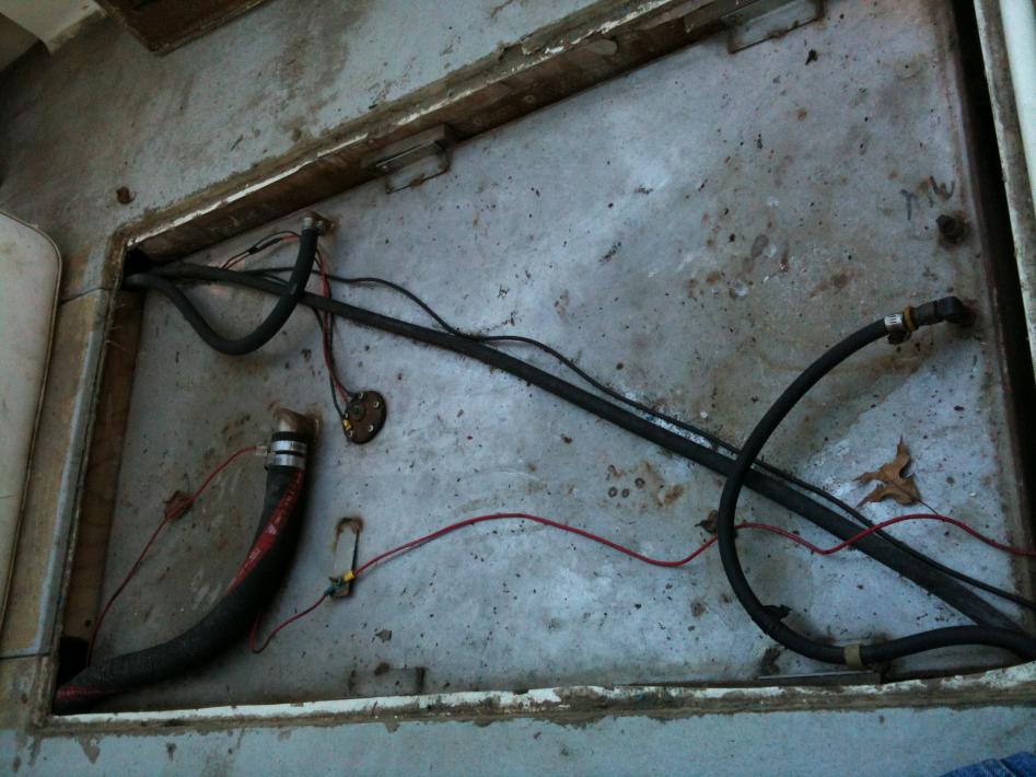

So for my first few questions: Does this fuel tank look like stainless to anyone else? Whats the chances that the "314" written on top of the tank is in fact the grade of steel used?
It looks like provisions may have been made to allow for "breathing" around the tank to prevent corrosion.
I am on a very tight budget and would rather not fork out 1k for a tank but at the same time, I don't want to die in a fiery explosion. Which of you forum members would risk keeping this tank? Thanks

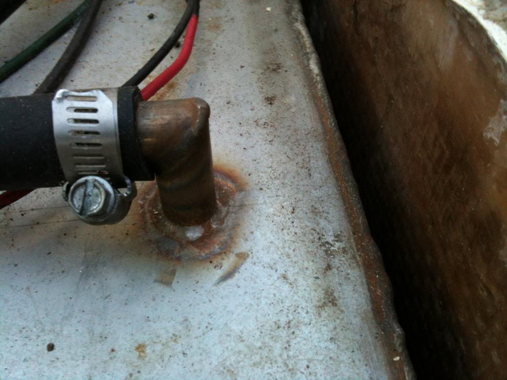

The welds in the second picture, along with the fill elbow makes me want to say yes.
Old 06-17-2012, 07:18 AM
Actually I meant to say it's a vent elbow, my mistake.

stainless steel is a poor choice for a fuel tank- stainless is prone to failure at welds,along with it being prone to crevice corrosion...

Boats gonna be put to the test so I'm trying to think ahead a little.
Will a .25" Moeller Cross linked poly tank hold up to the abuse of daily pounding offshore?

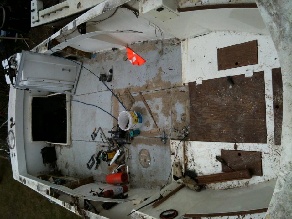

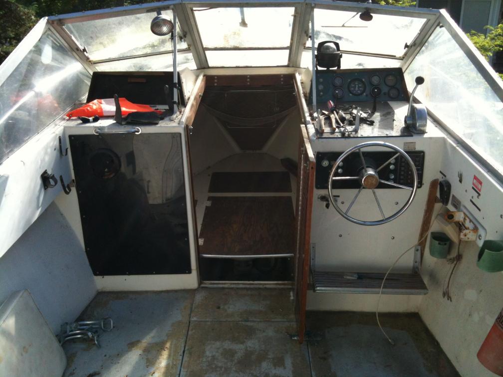

Cabin, bulkhead, and windshield are off. I unbolted the center section of the windshield, slid it out, and cut the cabin in half. It was too heavy for me to manhandle in one piece.
For those who may attempt this, a valuable tip is to screw a piece of 1x6 to the circular saw base, this raises the saw guide enough get the blade a little closer to the curve thus saving more usable rail. It also lets you guide the saw from a better location.
I used an old carbide blade, cut through like it was nothing, with very little dust compared to a grinder/mason blade.
