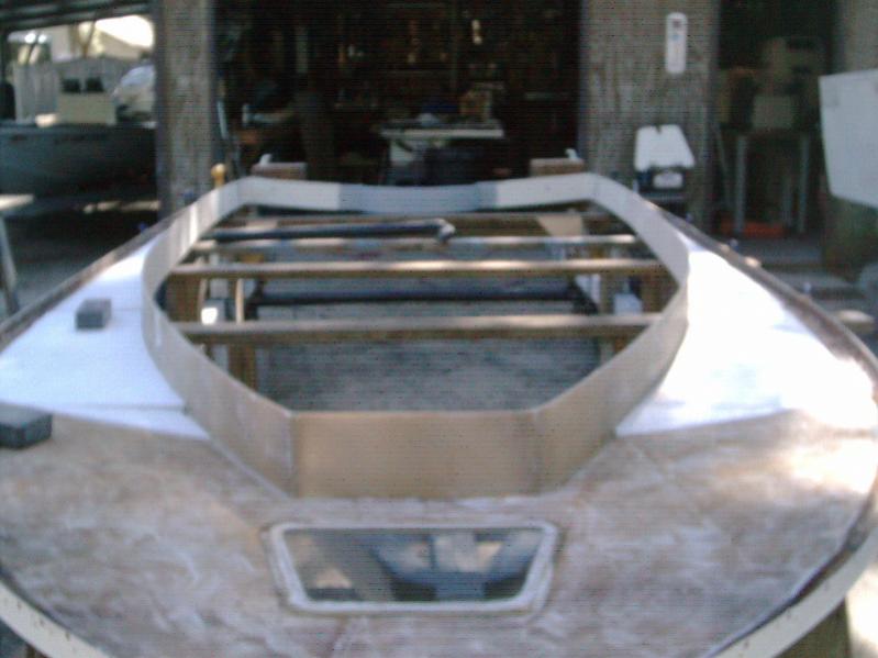

Cabin, bulkhead, and windshield are off. I unbolted the center section of the windshield, slid it out, and cut the cabin in half. It was too heavy for me to manhandle in one piece.
For those who may attempt this, a valuable tip is to screw a piece of 1x6 to the circular saw base, this raises the saw guide enough get the blade a little closer to the curve thus saving more usable rail. It also lets you guide the saw from a better location.
I used an old carbide blade, cut through like it was nothing, with very little dust compared to a grinder/mason blade.
