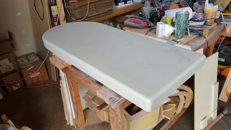

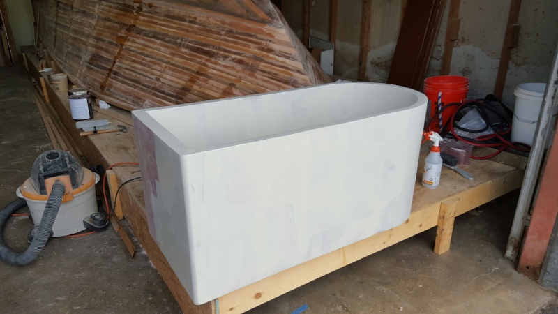

thought some of you might be interested in this. Building a coffin box using temp molds. Box top and bottom are cored with honeycomb. Made a mold for outside skin and a male mold for inside skin. Next step is to fill with foam...
Using all epoxy. Box gets faired before prime/paint. Painting it to match the boat its going on.

Nice CB. What was your thought in making the one and outer skins filled with foam (2 part expanding?) Vs building out of a foam core or even seen roofing insulation.

The coffin box is coming along nicely, poured the foam yesterday, will pull all the molds apart Monday and start fairing.

out of the molds and trimmed, next is fairing and making the bottom piece.

rolled some prime on yesterday, using the EMC high build epoxy primer.....
http://www.gulfstreamcomposites.com/...mers-s/126.htm
at least one more application of fairing, then several more coats of primer. *Will be cutting hole for drain and holes for mounting bolts next.
