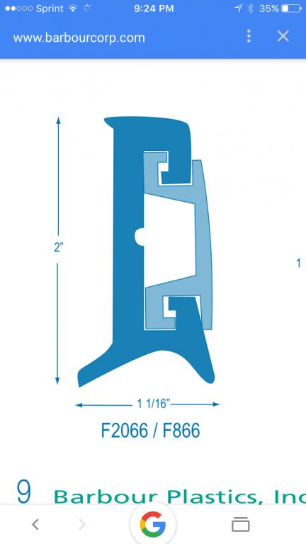

Regarding spray rails, they're definitely needed on the Moesly 21 and the 19' Bowrider, but the 20's already have a ~1" wide flat at the chine, so my experience is that generally if you get wet in a 20 it's because you're going too slow! However if you can find the vinyl rub rail that Potter started using in the mid-70's (I replaced my aluminum rail with one I ordered from SeaCraft in the late 70's), they have a concave ~1/2" wide surface on the bottom side that does a great job of deflecting any water that does manage to run up the side of the hull when you punch into a big sea! I don't know why TACO hasn't discovered that, but I haven't seen any aftermarket rub rails with that feature.

IMG.3194 jpg just recently bought this original style rub rail for my 23' cc great people to work with
