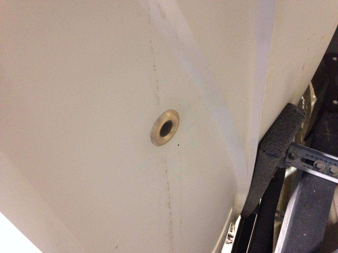

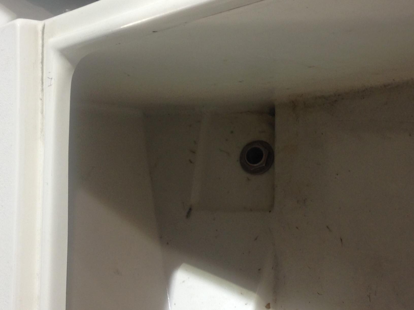

There was still some of the plywood was there, so I filled the void with 5200 and installed a larger cast bronze thru-hull fitting. I had to hone the inside of the fitting so a plug would seal up.
http://www.classicseacraft.com/commu...1&d=1573485386
http://www.classicseacraft.com/commu...1&d=1573485418
