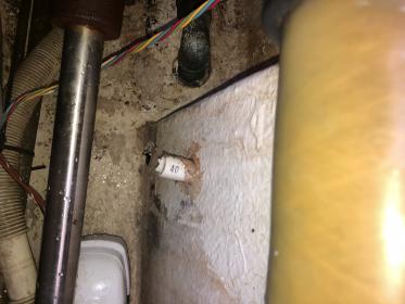

Does anyone have photos of the bulkhead configuration on early 70s inboard 23’? Noticing water pouring through the bulkhead drain on the starboard tank not sure how water would be getting into this space and keeping the bilge running more often than it should . Photos are of the starboard bulkhead drain.

If you have the original scuppers, take a very hard look at the stbd one. The brass corrodes through, then the wood block around it rots, then it leaks in...
The port one on my 23 had a slow leak from that sequence and the block was jello. The stbd one had just started to rot. Both are now replaced with fiberglass pipe. If you can get to it, try sprinkling baby powder around the area - makes it easy to see slow leaks.

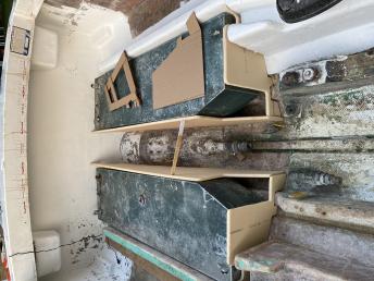

Here are the new bulkheads that I’m building. There are two empty spaces under the gas tank on each side of the engine stringer that can trap water.

Not intending to hijack thread here so I will keep it short. I used 2"OD/1.5 ID pipe from Max Gain Systems (mgs4u.com/fiberglass-tube-rod.htm) and then wrapped it in 1700 w epoxy to get to 3/8" wall. Cut out old stuff and cut sections of pipe to fit angles (neither were easy tasks - access is hard). You can see the blocks in the corners of Petey's bulkhead picture. Centered tubes on old holes, epoxied tubes in w glass fiber fillets then 1700 or 1808 (can't remember which). Match drilled liner n hull to 1.5". Sounds easier than it was, but I wanted to keep the drains which I think are a good idea but miserably executed.
