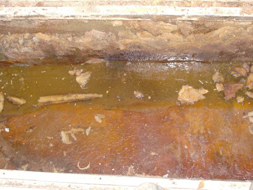

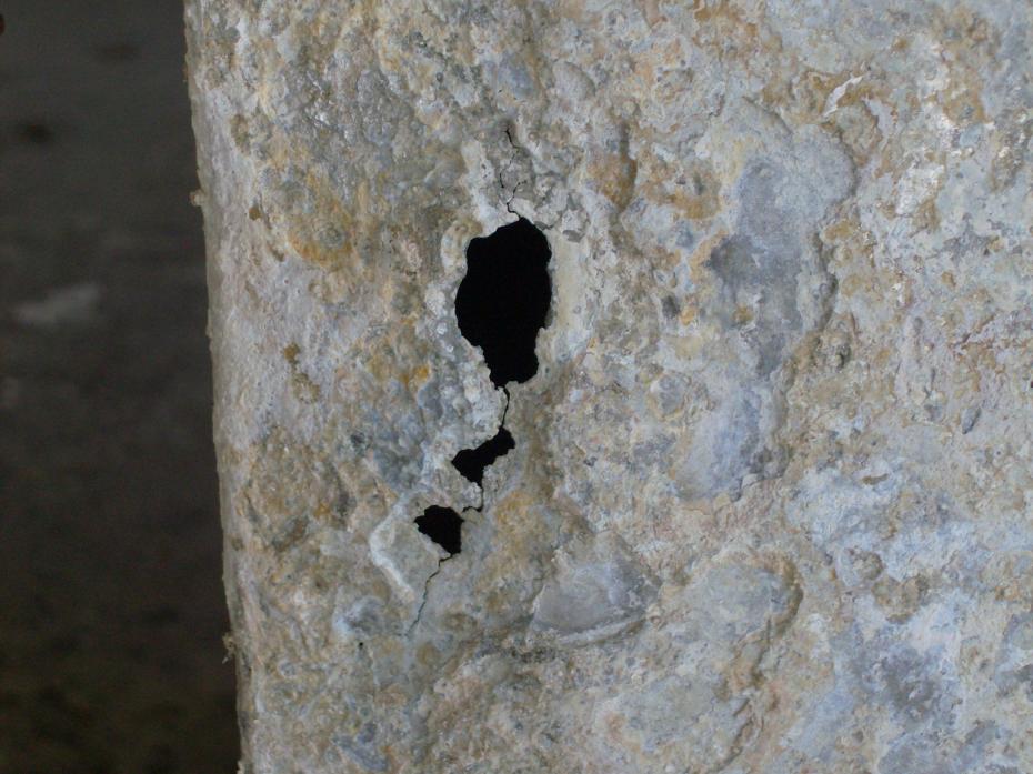

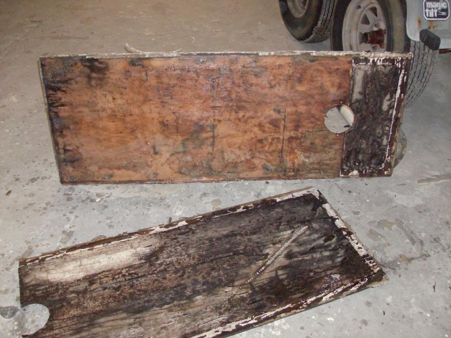

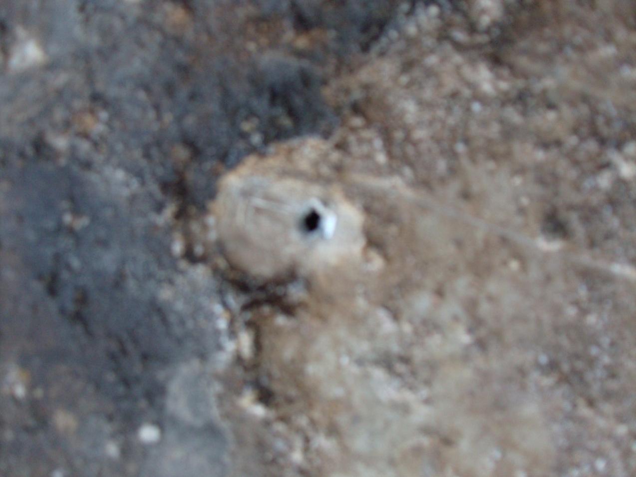

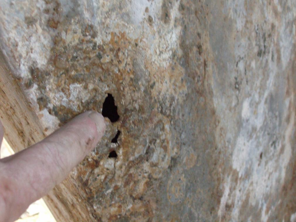

here's one -
this is a client's boat - he had a fuel odor - i explained to the gentleman - the boat needs a new fuel system,he,as most owners do,doubted that...finally,the boat arrived at my shop - to have the needed repairs completed - check out the fuel tanks...look close...
that's not water - the picture with the foam in it - it's a mix of sea water and fuel - that's the port tank cell - the area was soaked in fuel - the hole in the bottom - this tank had 8 holes in it,in total
