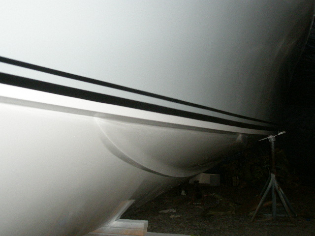

The boot stripe on my 2001 SC 21 is getting kind of beat up after 13 years. I have to replace it or have one painted on. Anyone here have a painted on stripe? Worth it? Thanks!

They hold up good but take lots of time to do it right. Lots of taping. You are going to want to go to a automotive paint supply store and get some good tape. I have used both Awlgrip and pettit boot stripe paint with good results.

Yup. I've painted all of my boot stripes. Looks much better than the vinyl kits you can buy for the same purpose.
I recommend using a single part paint for the stripe despite my strong preference for AwlGrip in the hull. Easier to apply; easier to repair.
