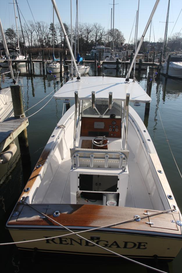

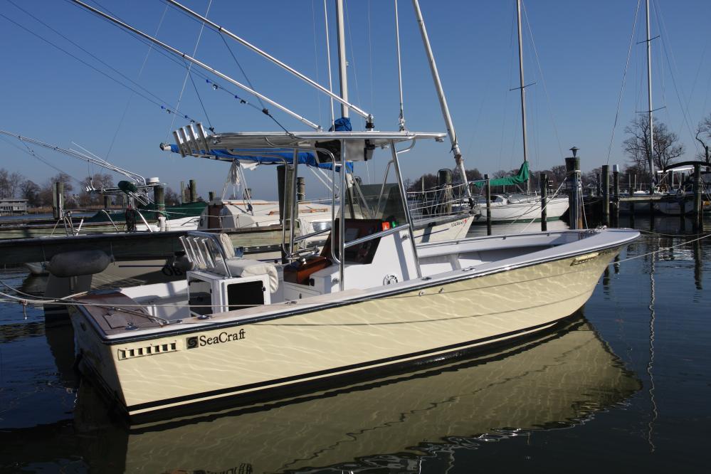

What exact model engine is it, and how is the noise? Looks great!
Old 10-07-2013, 12:07 PM
Highway12 Highway12 is offline
Join Date: May 2011
Location: Annapolis
Posts: 44
Yanmar 240 4LH
I cored the console with Coosa board and made an internal motor box. The plan was to insulate the box and we found that it wasn't really necessary. Noise is not bad at all and the boat runs awesome 26 kt cruise 30 kt wot.
The coring also allowed us to attach the T-top to the console.

did you make your helm pod? if so please explain the process!! i love the looks of it!!!!
Old 12-09-2013, 07:26 AM
Join Date: May 2011
Location: Annapolis
Posts: 44
Yes I built the helm bubble. I made a mock up out of scrap coosa board to get the general fit that I wanted and then used the coosa as a template. I used 5/4 teak for the actual helm pod. I glued the basic shape using angles and then scribed the curves and shaped it with a hand plane. The finish took the longer than building it... 10 coats of Epihane clear varnish. I never liked where the steering was located. Now you can sit in the seat and steer without using your feet!
