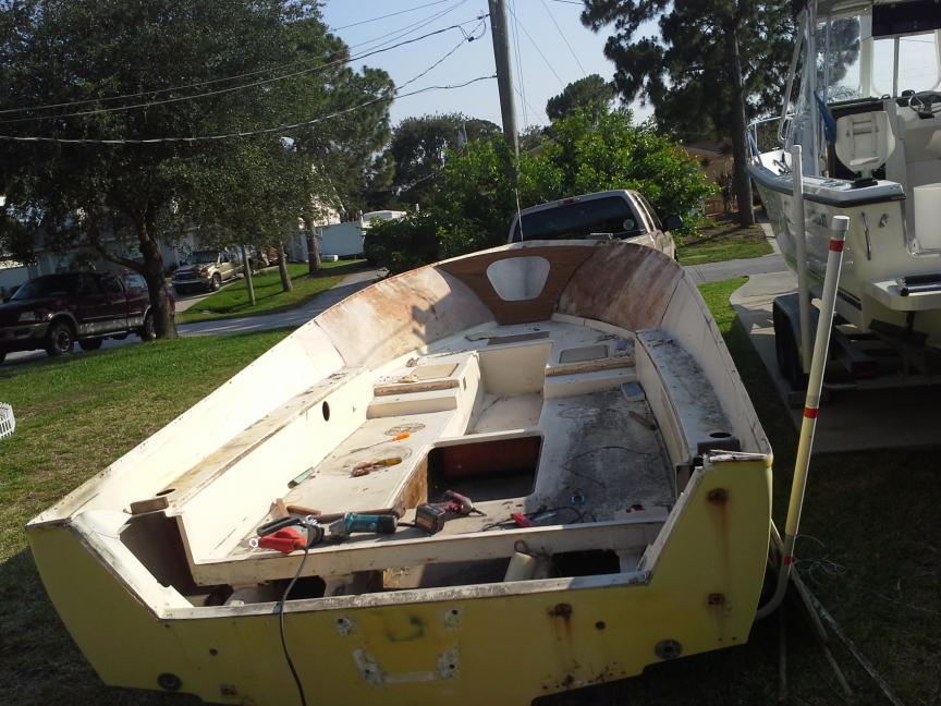

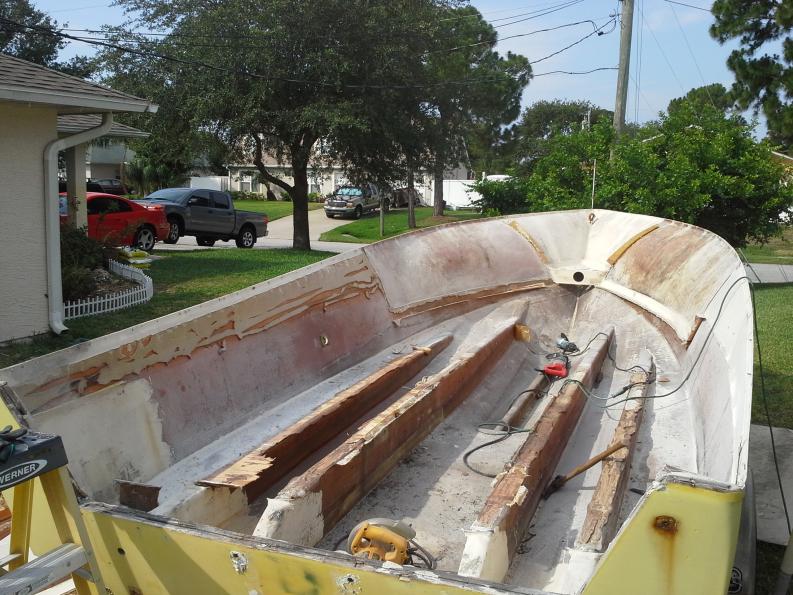

I got this boat for a great deal and am lookin forward to make this boat like new! I jumped in head first and have already ran into something I am unsure about I got the cap and floor off and noticed that the stringers are hollow except for a single 1x3 running the length of the stringers. I want to cut the tops off, raise the sides of the stringers, foam fill them, and then reglass them. Not sure if there is a better solution that will be less work, but if there is I would love to know! So im just gettin started and hope you guys will chime in if you see something that doesnt look right. Thanks!!

I want to put a flotation bracket on the boat and raise the floor to make this boat a self bailing cockpit. Im unsure about putting a bracket and 4stroke 150 on a boat this small as far as how the boat will run. Also if anyone knows how high the floor needs to be raised to be at least an inch above the waterlinewould be great. Or do i have to load the boat down with 50gal drums to find out!

As others have said, you are definitely making a CC the hard way! You would have expended much less time, sweat and $ if you had just bought a CC in the first place, as they are relatively common, having been been built by Moesly, Potter, SeaCraft Industries, and Tracker, as late as 2005 or so. Only Moesly and Potter built the Seafari 20, and they only built 349 OB models over 10 years starting in 1969. During the same time they built over 2600 CC models, counting the 18 and 20 SF/MA models. I'm sure thousands more were built by SCI and Tracker. However they only built 80 Seafari 25's, so they are even rarer than the original Moesly 21, although many of the 21's were raced and probably did not survive!
I do see a couple of problems with your plans. The worst is hull stiffness, or lack thereof. By removing the cap, bulkhead, and inner liner you've significantly reduced the structural stiffness of the hull. The Seafari had the stiffest hull of all the 20' models because of those features and cuts through big seas like a tank because of it! Most guys put 2x4's across top of hull when they remove the cap to keep hull from distorting. Note that the original CC models do not have openings in the inner liner below the gunnell at the rear . . . I believe that was an attempt to retain some of the stiffness that's created by that shelf and high coaming of the Seafari cap. I hope you're planning to core the hull sides to restore some of that stiffness to the hull!
The other problem is that the Seafari has more weight forward than any other 20' model, so it's the best suited for a bracket. Plus it has a much higher coaming, so you could raise the deck more in it without having the gunell down around your ankles! Unless you mount the CC and fuel tank fairly far forward, you'll be stern heavy with a bracket, especially with a 500 lb 4-stroke motor on it. If you're dead set on a 4-stroke, the only one I'd consider is the 140 Zuke, but a 150 Opti (or an E-TEC if you want quiet) will have much more mid-range torque for planing with heavy loads. Or a 115 2-stroke would about match the Zuke for mid-range torque, but be about 50 lbs lighter!
As for deck height and the scupper issue, it looks like you may have a Moesly hull with the scuppers out the transom. If so, I'd leave 'em there, install the Raybud ping pong ball check valves, and cross the drain lines below the deck like Moesly did, i.e., port scupper drains out stbd side, etc. If you do that you probably won't have to raise the deck more than a couple inches to keep your feet dry if you keep motor weight under 400 lbs. For reference, my boat, which has the highest flotation bracket available, is still self bailing at the dock, but just barely, with no one aboard. And of course I have more weight forward than most CC's, and I don't have a 500 lb motor on the bracket. You might also want to reconsider the bracket. It's main advantage is the solid transom and more room in the boat, but the performance benefits are over-rated! A good friend of mine has the same boat and motor but a transom mount, and his boat is 4-5 mph faster than mine, which is compromised by the 4B prop and Doelfin required to compensate for the heavy stern!
I wish you well with your project, but I'd suggest that it needs more thought. Also, did your boat have the galley seat and if so what did you do with it? Some other Seafari owners might want it. Also do you still have the windshield and bow rail? That's a beefier Moesly style bow rail if it has 4 stanchions/side instead of the 3/side on Potter rails. That windshield also looks better than mine, so I might be interested! Where are you located?
