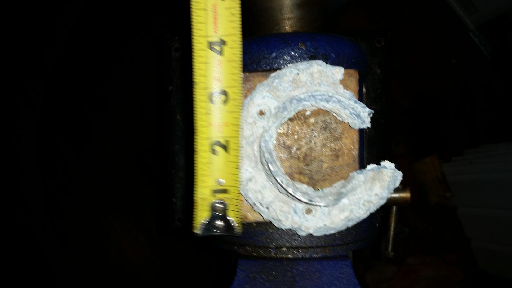

Anybody know what the fitting on the bow behind the bow light is? Where can you find a replacement? I am guessing it is a guide for the anchor since it is open into anchor locker. As you can see in the pic mine is gone. See pics.

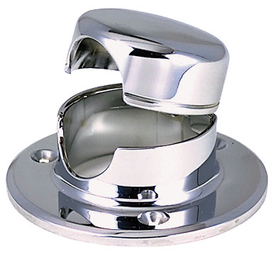

Might be one of these?
http://www.perko.com/catalog/deck_ha...ope_deck_pipe/

Looks like it was made of Zamak (zinc based pot metal), which basically dissolves in salt water! Definitely not OEM equipment! A deck pipe that allows you to mount anchor on front deck for quick deployment is a good idea, but get one of these, not one of those small dinky ones where you have to push the rope thru it! The weight of the chain hooked on to the cap holds it on.

Thanks guys,
erebus and Bushwacker the links you posted are defiantly what i am look for. Mine is just totally corroded to the point of falling apart when I pick it up.
