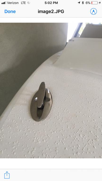

Was hoping to get some help from some of the experienced sceptre guys. I have finally found drain cups (eBay) for my Attwood pop up cleats. I want to route the water with the 3/8 inch hose it comes with into bilge. Question is if I pop a hole just under the cleat on the liner where will that water go? Will it channel somewhere bad or will it catch a stringer and go to a limber hole? Thanks so much

My fear would be if the floor meets the liner below and the water channeled to the helm. My original thought was just to drop a line in the liner and it would just go straight to the bilge
Any help from you demolition, previous restore guys is appreciated

Ehhhh, that’s a tough one. I don’t think there is a path unless you can fish a tube down to the area under the front locker.

Ouch. Yea that was a fear here. Man I sure didn’t think it through hard enough. I sssumed if I just got a hole in the liner it would drain to bilge. Would love to hear from others who have seen the guts of a sceptre. Thanks Kmoose

Front anchor locker you are referring to?
Plum it to this to be safe ?
