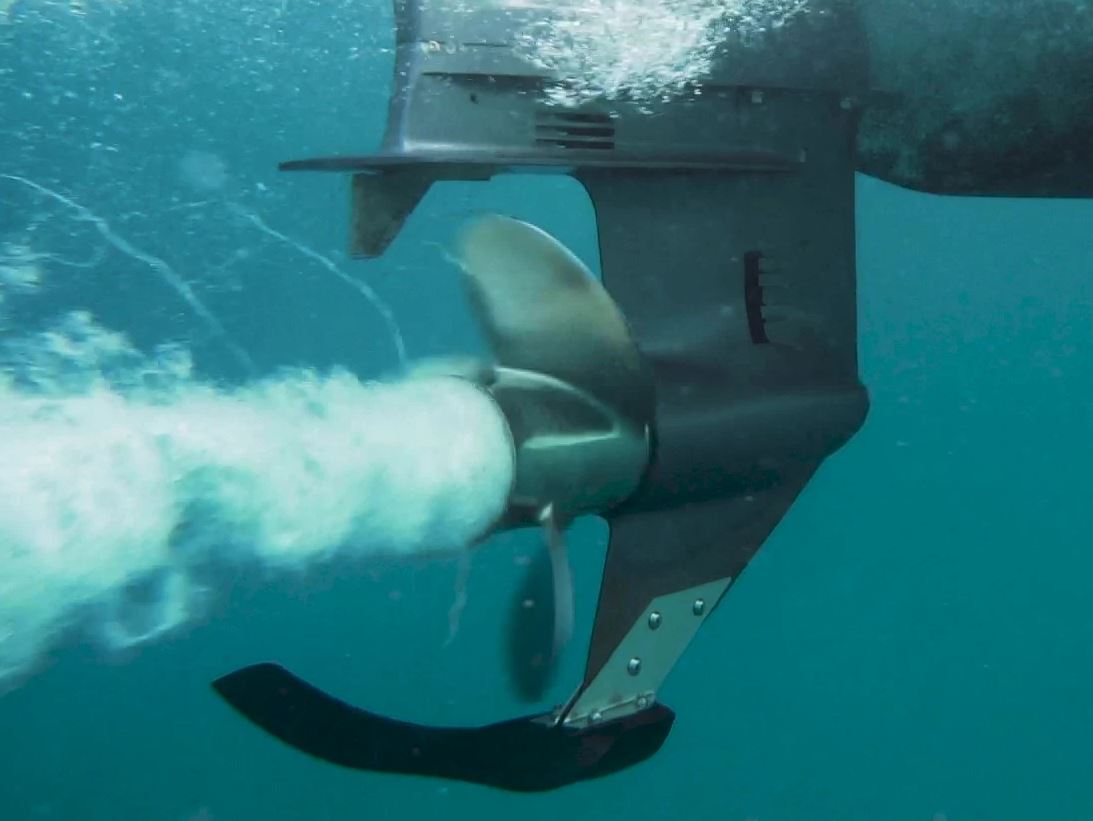

https://www.hydro-shield.com/
This will be a great help.
Properly set up it provides stern-lift at all speeds without forcing your bow down. It's a hydrofoil that stays in the water. You can adjust trim without instantly looking like Flipper begging for a snack!
I ran one on my outboard 20' Seafari, both with the XR4 motor and later with the 90 Optimax. I just purchased one for my 18" Superfisherman with a 90 Etec.
