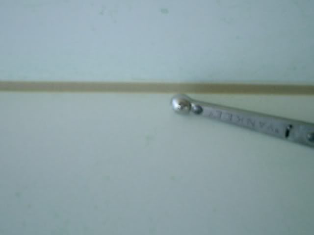

I used a product called Klean Klay. I got it from the fiberglass store.
The only thing they said is to use clay and never caulk.
Klean Klay
Also for easy radius use something that is round...like a ball bearing on a handle.
Radius Tool
