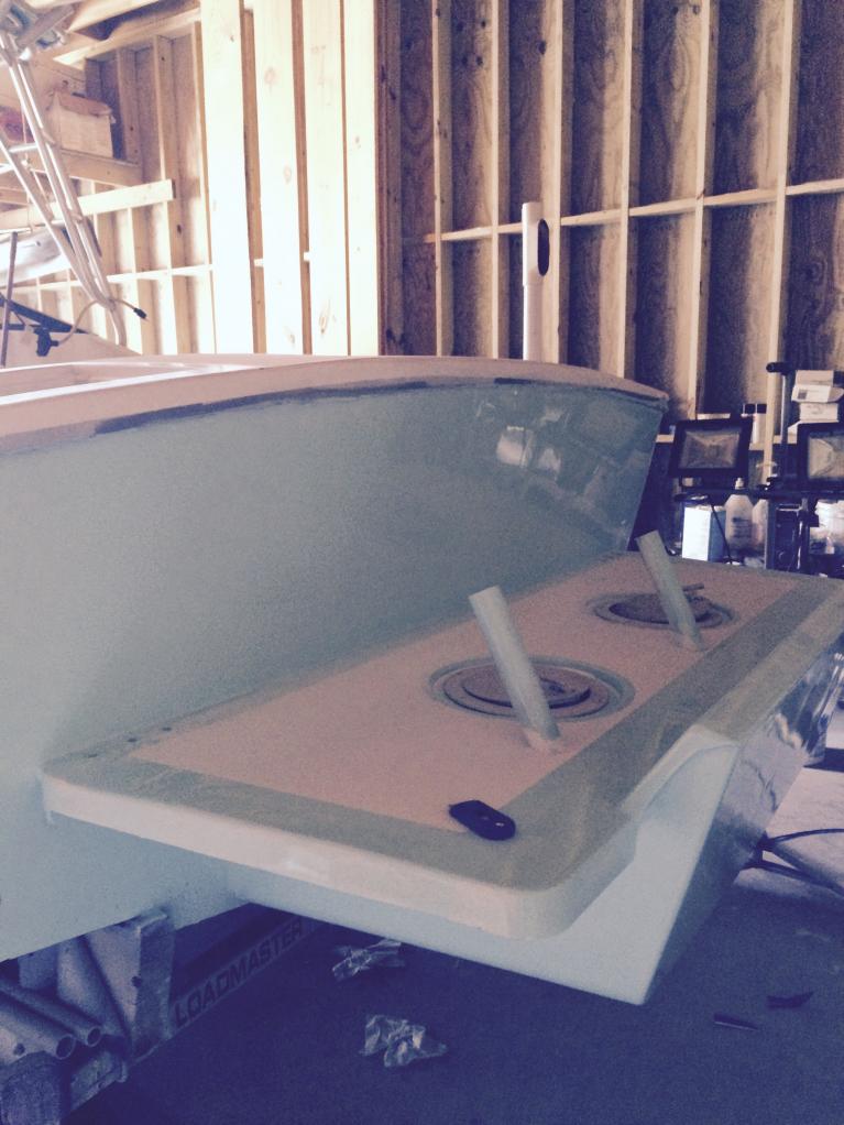

I cut out the original. 2 inches of foam on outsides. Drains into bilge for now. Coosa bluewater 26.Name:  image.jpg

Careful about adding extra weight up there as the Sceptors don't don't like a lot of extra up front. But then again I myself add quite a bit.

Moose, I'm running twins so the added weight is really just to help offset the weight. Original was rotten. I'm dropping her off next week for twin 2015 etec 150's. I'm excited to see how much the water line will change after the new transom.

Sounds good, I wasn't quite sure if you had a full bracket or not. What are you going with?

Default 28" setback
I used regulators idea for the rigging tubes. Really going to clean up the transom
