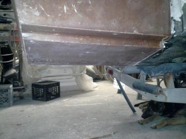

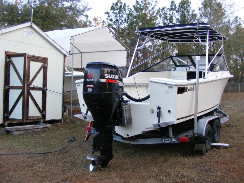

I'm not a big bracket fan as I have converted one boat from a bracket and was much happier and set my 23 up with a hybrid option that is of much less cost than full floatation and a closed transom. Considering you have an OB hull already you might want to consider how I have set my rig up. For diving and access to the water it is hard to beat and performance wise it has been outstanding.
Old 08-12-2015, 10:38 AM
The 10' set back bracket is manually adjustable and allows the removal of the big stock engine well giving you all the room and more compared to a closed transom. Here's a pic of the inside. The splash well seems short but I have no issues with water getting in or backing down in seas. I also have a 3.5" raised deck so everything drain nicely as well.
This is a great option as well and much less expensive than a new bracket. However, the center of gravity is further back on a cc compared to your boat, it is likely the setback bracket will cause more issues than it will fix on a cc.
I do love the idea of being able to adjust the height of the engine on the fly with a hydrolic jack plate though.
Old 08-12-2015, 12:34 PM
"The 10' set back bracket is manually adjustable"....Moose's is not hydraulic. However you could sure as heck put one on.
