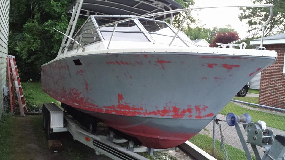

Thanks. I'm just getting ready to sand, prime, etc. the 19' Moesly Bowrider. That is all great advice. I have a good air 5" DA w/o vacuum and a good electric 5" DA with vacuum. Would you suggest investing in the Hutchins straight line sander at $300+ with all this work in front of me? Since I'm doing this indoors, dust is a real concern.
And at what point are you going to fill the holes in the transom?

sand all the way down to gelcoat. prime. block sand. prime, block sand. prime... block sand...... repeat if necessary.... pay some one to spray.

What point do you fill holes in the transom? I fill any holes with fiberglass matt or 1708 if it is a bigger hole. Small tiny holes a syringe with thickened resin works well. I will do all the glass work First prior to priming and ruff it down with a 6" da or the course line sander then do any filling with fillers. Once I have everything close I will start priming, And at that point I will swith over to the 3800 da action line sander and work it with the fine grit. I use interlux watertite to do final filling if needed over the primer. It is a thin glaze putty that flows out well and can be used up to 1/4" thick they say but I try to keep it under a 1/16" if possible No more than a 1/8". At that point I will knock down the filler with a 6"round da for speed but use the line sander to blend large areas. The round 6" da works well for those small areas of spots of filler and random repair spots but if you try to do the whole boat with one it can cause the finish to have waves in it. The round sanders do well if held flat and worked right but you can get a flatter finish over a larger area with a long board or a block type sander.
