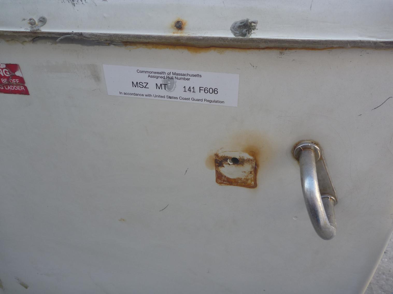

Thanks, McGillicuddy: The transom did not have a hull ID number on it. the prior owner had to get an assigned number form Massachusetts at some point. Here is what the transom looked like before the redo.
John, I'd definitely save that picture in case you ever get boarded by USCG! Maybe even have that number engraved on the new sticker!

I ordered a new number plate in stainless steel from machineplatesonline.com that will get screwed to the hull in the same place. I will put a second identical plate inside the cabin, perhaps on the inside of the bulkhead inside the instrument panel cover. The prices for a 3 inch plate were not cheap - $60 for two. Cheaper than a ticket, though.

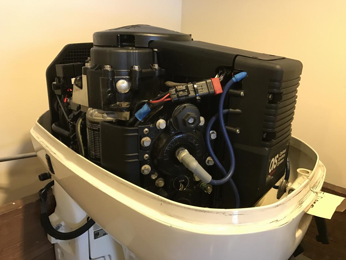

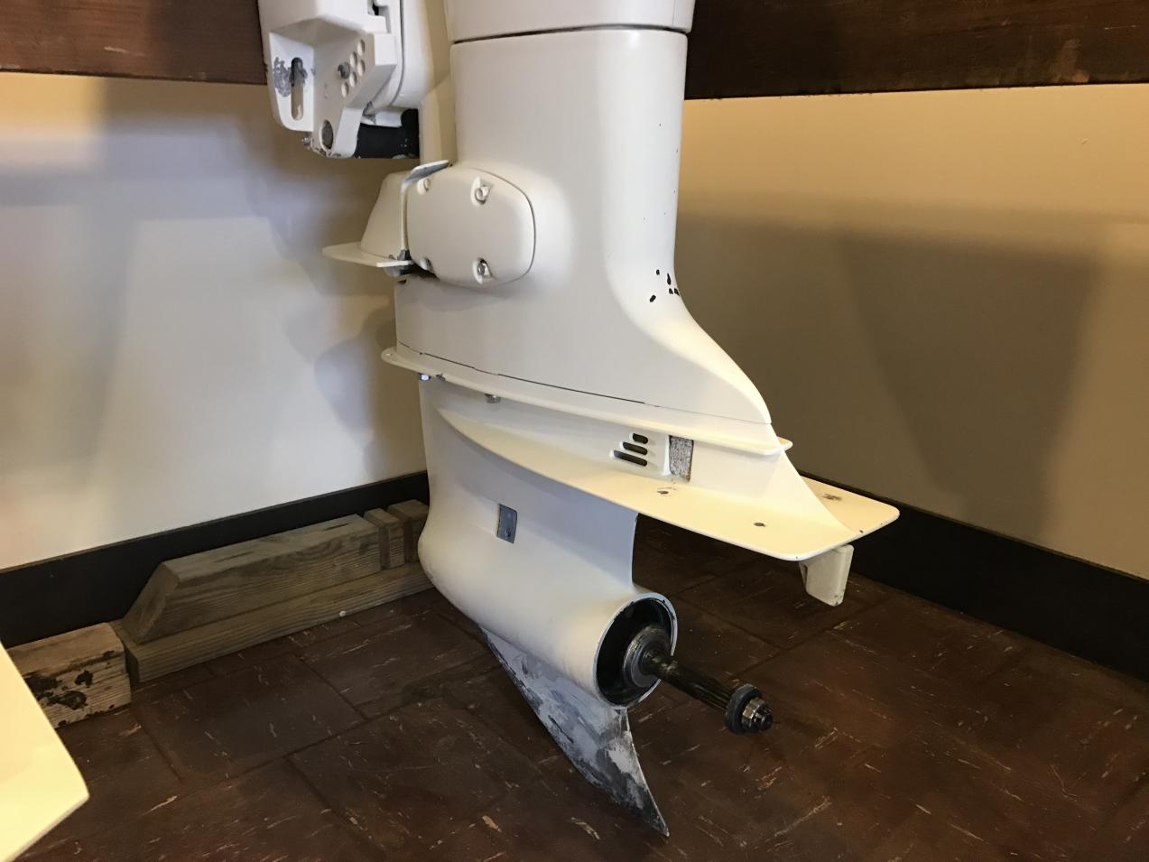

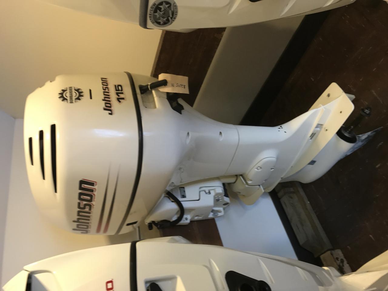

Found a 2002 Johnson 115hp 2 stroke at a nearby dealer. Price seemed reasonable (for Jersey) and I put a deposit on it. The dealer will hold it for a couple of months until I get the boat ready for it. The service history is good (dealer serviced) and it is one owner. Very Clean. Here is a couple of shots:

Great engine! I had a slightly older version on my Arima and I loved it.
Lots of grunt and decent fuel consumption. Never gave me any problems in 600 hours and required minimal maintenance. I miss that motor.
Congrats!
