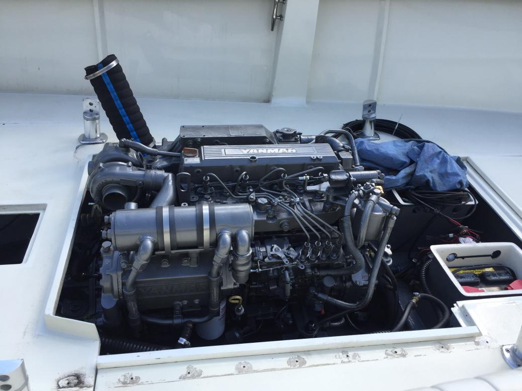

I Have a 23 inboard with the 240 Hp Yanmar 4lha-ste with a 1-1.25 zf transmission. That engine if you can find one is about the same size as a small block chevy and a little heavier but not dramatically. My boat will cruise at 23-25 knots and run 29 maybe 30 on the pins. run the same prop as i did with Gas crusader 16x16.
I had seen one with a cummins 6bta but it was really wedged in. the yanmar doesnt require any cutting but i did change i'm i'm up the engine mounts to allow better engine mounts that absorb more of the diesels vibrations at idle.
jim

heres how it looks in the engine bay
