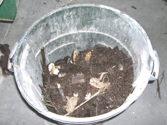

The transom was mulch. I scrapped it all out and removed most of what you see here

Great work Thomas! I love the picture of the "Potter Putty" just lying there like a dog turd.

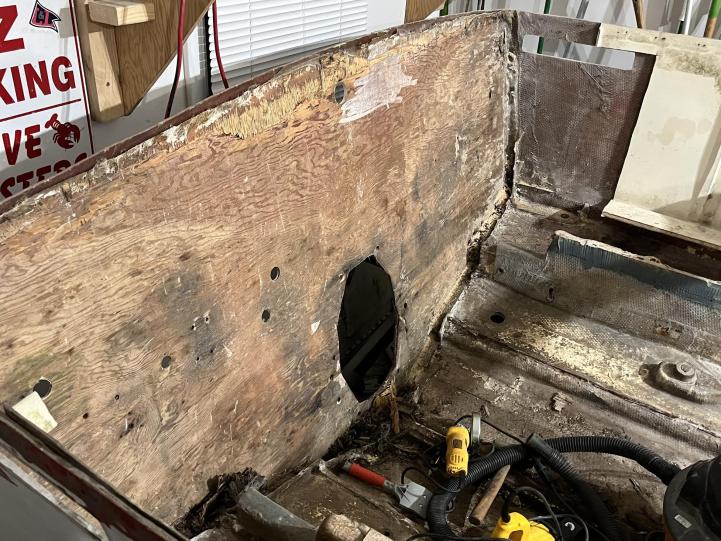

This is how the transom looks now, most of the plywood is gone. I need to attack the keel stringer next.
Any advice on the thru hull transducers seen in the bottom right, is the transducer in a "pocket" in the hull or its it all glassed together- i cant seem to knock them out?
Old 12-23-2021, 07:04 PM
1.) The keel stringer was to beef up for roller trailers. Made from cut ½ PVC . Leave it alone. Good channel for water / Moisture. Keep going & DON'T REMOVE the hull side vents & their inside air channels
2) it looks like that's an old Airmar or the like transducer that was glassed in a mineral oil box? You should be able to cut it out with a jab saw since it not a thru hull install ?
Thanks. My keel stringer is wood i removed a square from the top of it about 4' forward of the transom. Its wet stabbing a chisel into it you can see the moisture. Would you recommend the pvc keel stringer mod i have read about to replace this? I assume i need to beef up the layup on the keel when i am down in there.
The vents will be in the way of the new transom 3" thick is what i am aiming for. Any ideas on new ventilation places? I personally like the no vent look
Old 12-23-2021, 10:23 PM
Those vents were there for a reason . They are a classic signature. Think about it. I never took water into those forward vents BTW.
The keel in mine was glassed over PVC pipe. You can see forward of the transducer. DONV has a ' 78, maybe he can jump in. Plus Dirtwheels really knows his stuff.
